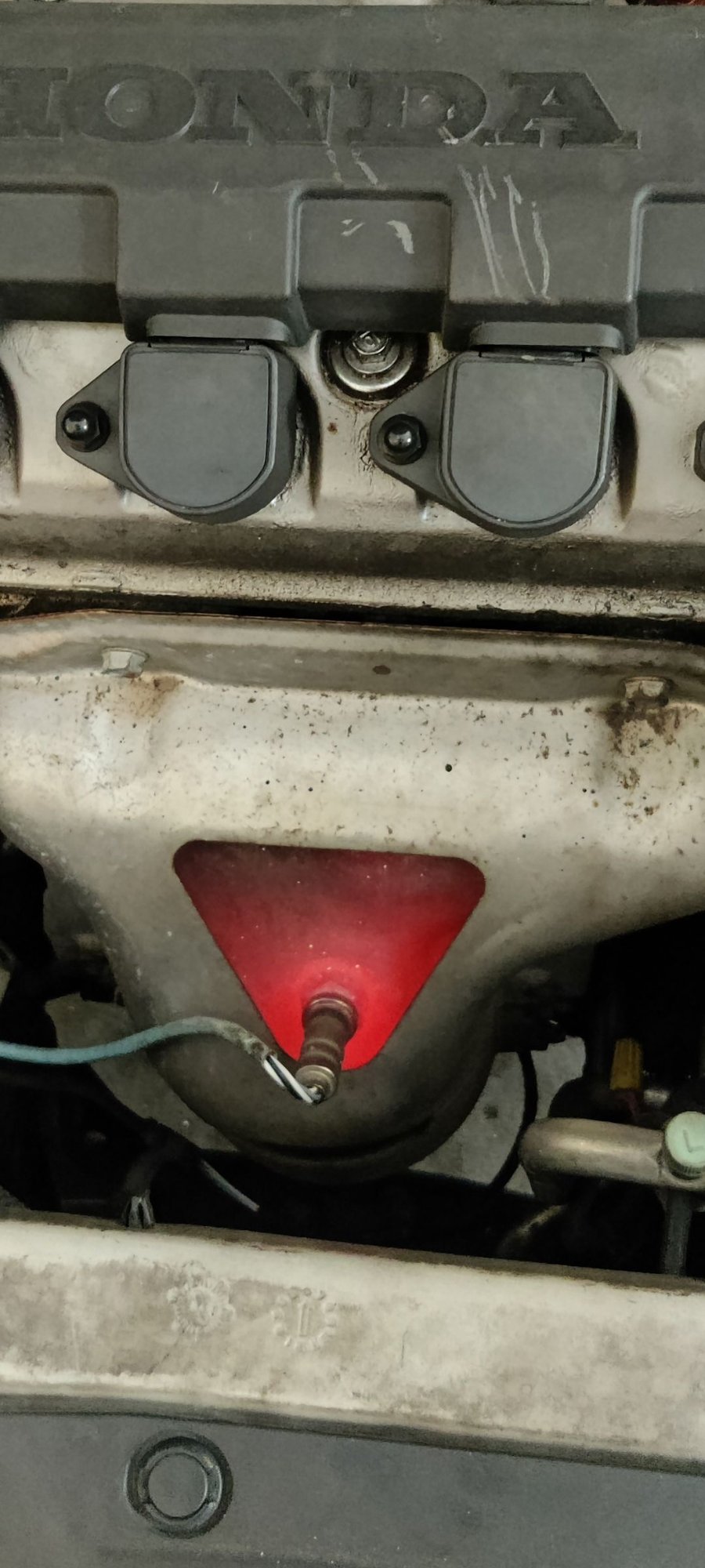

So, ever since March 2022, I have been adding distilled water to the radiator every morning. I probably add 4 ounces or so, depending how long I've driven the prior day. My usual commute to work is 42 miles round trip. I just use distilled water because I live in south Florida (no freezing down here). Every time I come home from work and park in the garage, I smell the sweet smell of coolant (even though I've been adding just distilled water for weeks). One day couple weeks ago, I decided not to add water in the morning...and that evening I left the car running for 10-15 min while I ran in the store with the a/c on (kid did not want to come inside the store with me). When I got back to the car, it entered limp mode. When I got home, it smelled very bad (like a faint burning smell). I popped the hood and the picture I attached shows the metal portion where the O2 sensor (I think) plugs into was glowing hot. This has not happened again, since I put water in there every morning religiously. The car now has 223K miles. The car is hard to crank if it is warm, but cranks just fine in the morning and when I leave from work.

Is the coolant reservoir over filled and over flowing occasionally? That along with the radiator low is usually the indicators of a failed head gasket. These usually don't fail regular head gasket tests. Link below has more info. If just the radiator is low, that would usually be just a coolant leak.
https://www.civicforums.com/forums/3...reference.html
The head gasket can go bad again if not done well. Head needs to go to a machine shop to check for warpage. Block surface needs thoroughly cleaned. Head bolts need properly torqued. Honda genuine head gasket should be used.
You could pull the engine/trans and do the clutch and head gasket outside the car. Not really any easier than doing them separate.

Thanks for the reply. The coolant reservoir is filled to the maximum. Should I suck some of that out with a turkey baster so that it's at the proper level? I've been driving this car as if it literally will die any second. I figured if there was too much coolant (at this point, distilled water) in the system, the radiator cap would allow pressure release. How long do you think the car will keep going if I just continue to top off the radiator every morning?

most likely headgasket
do the test on the video on the 1st post

If by maximum you mean the "MAX" line on the reservoir, probably a coolant leak. If by maximum you mean it's basically overflowing out the top, likely head gasket.
