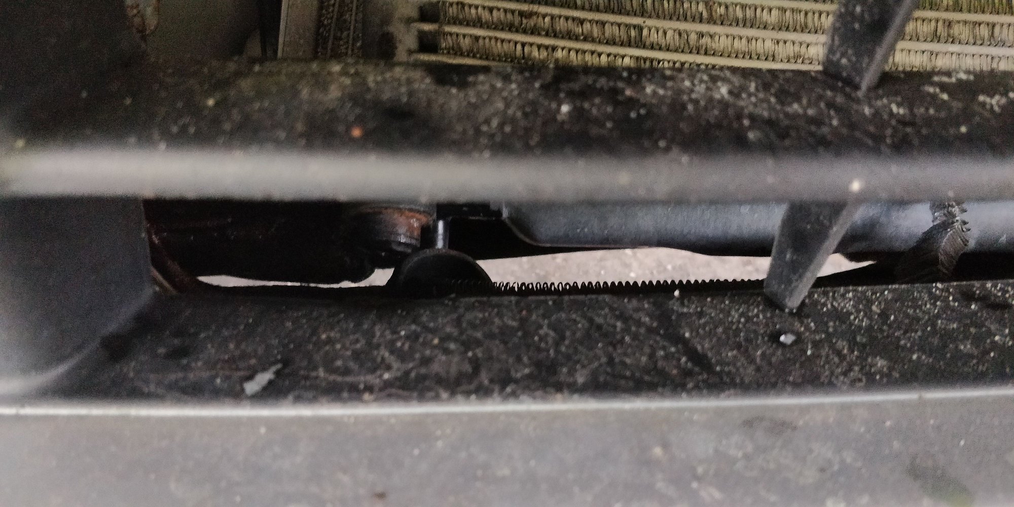

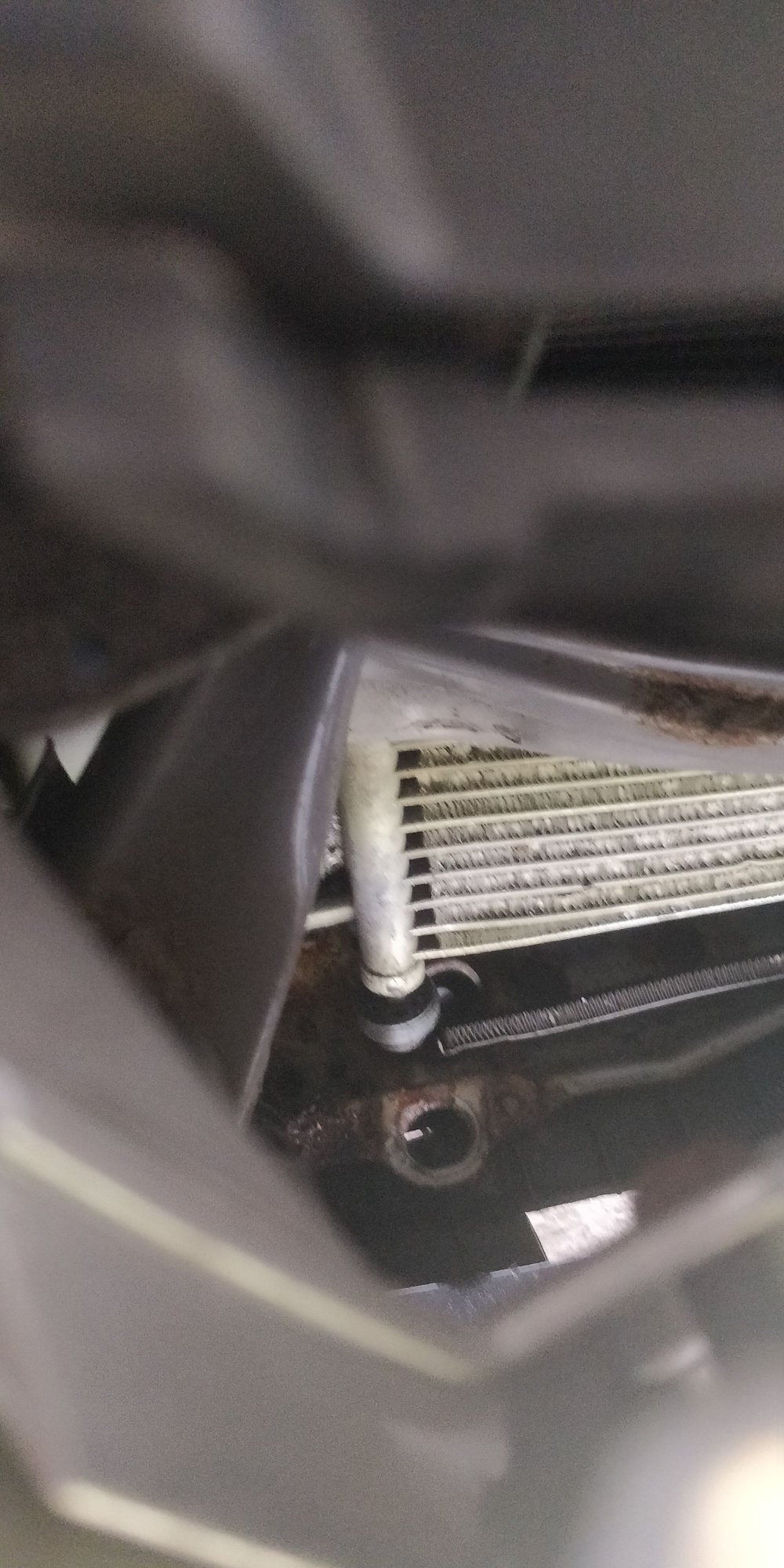

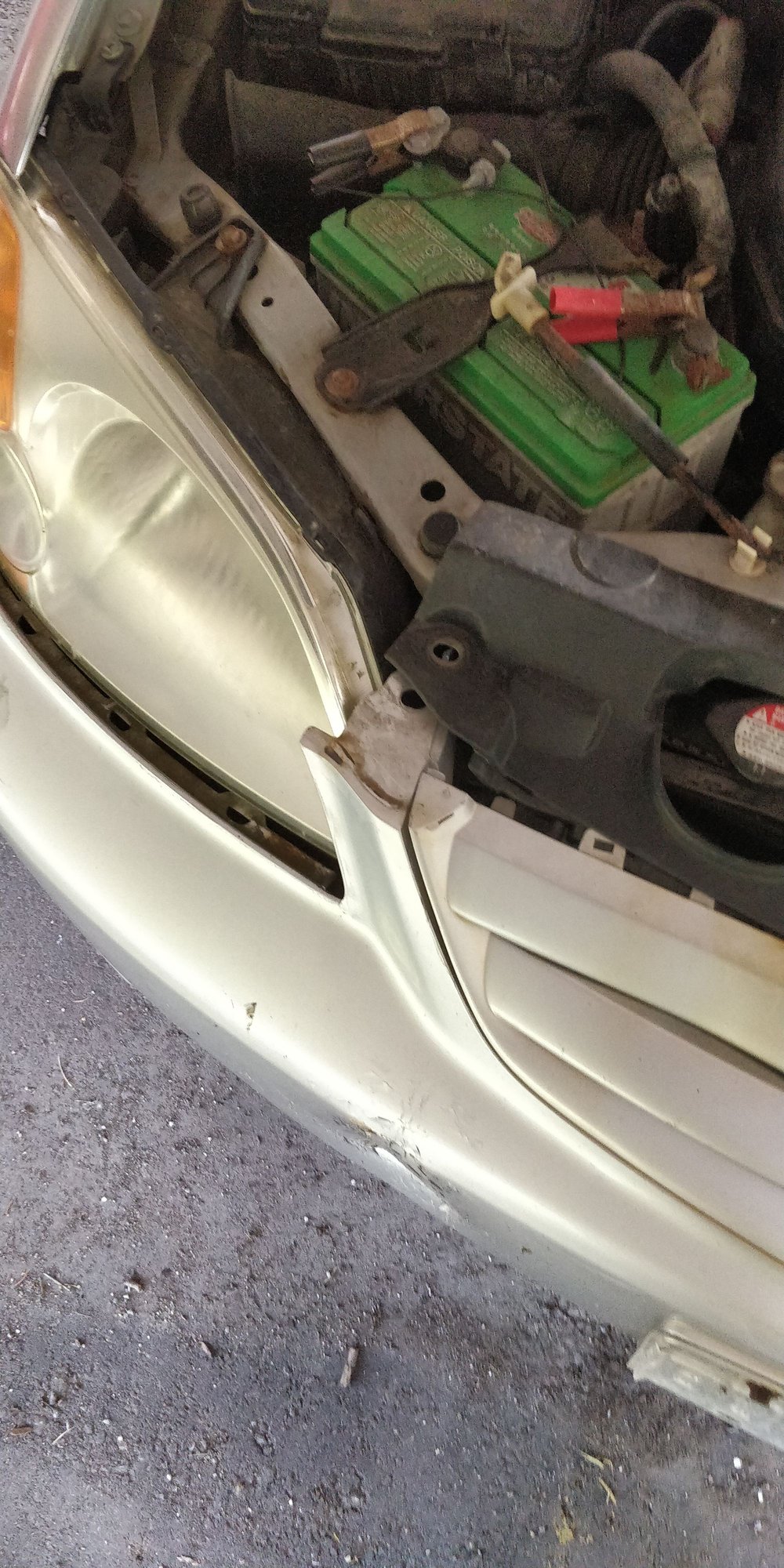

Hi guys,
I need your/help in diagnosis. I have 2002 Honda Civic. I got into a fender bender in a stop and go traffic today and ran into this pick up truck (with a hitch).
The hitch bent the frame and then pushed radiator along with it. Pictures attached for reference. I saw a little bit of coolant leak at the time, but then not much. It didn't seem to leak when I stopped during my way home. I was 20 miles away from home, so I took the chances to drive it as much as I can. The vehicle did get hot a few times, I stopped and let it cool down before proceeding.
I made it home, but now I am curious what the problem could be. The fan on the driver side works, and not on the passenger side.
Any thoughts? Thanks!

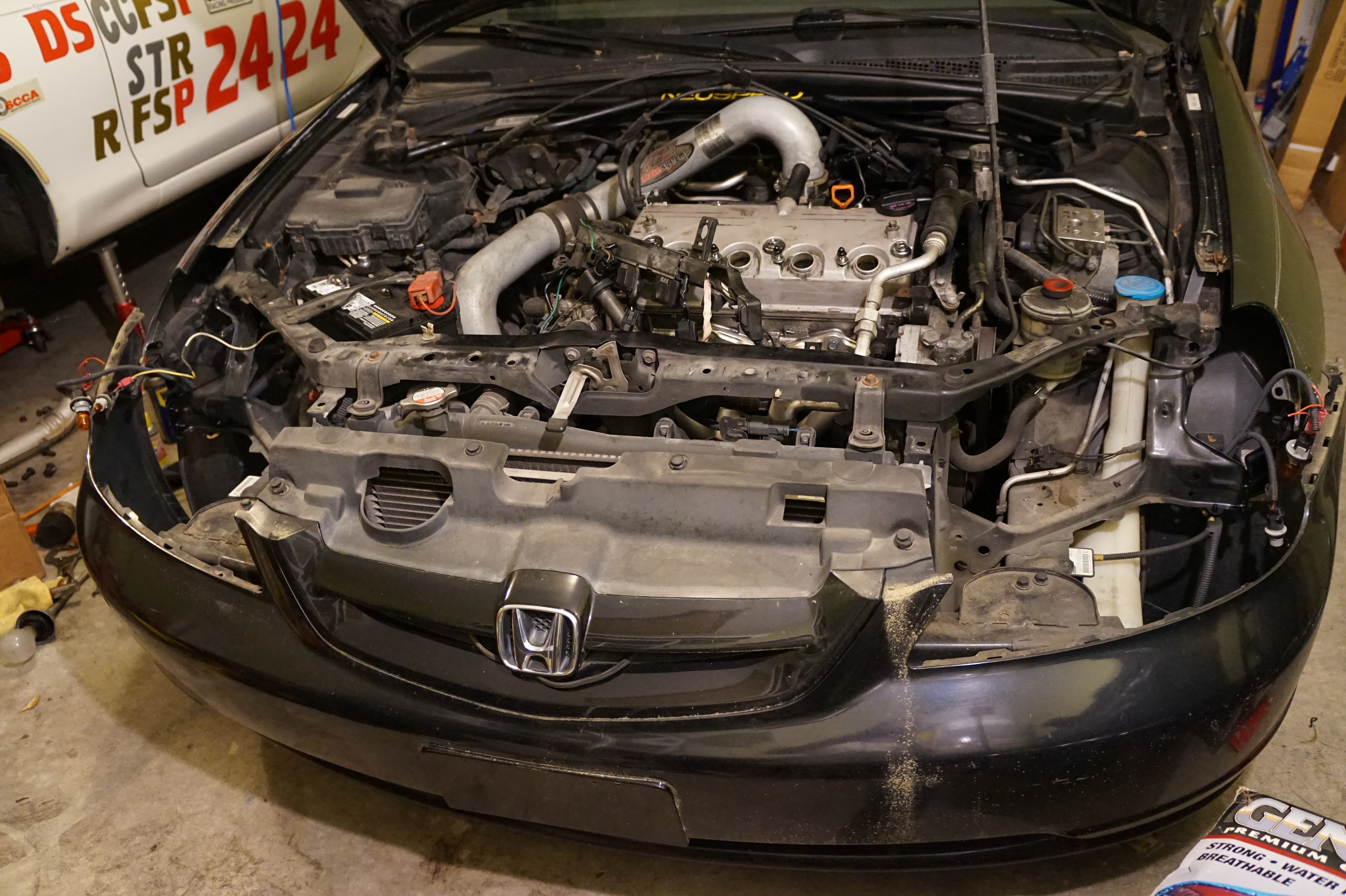

Based on your previous pictures I would say the radiator is cracked and leaking. Going to be low on coolant and overheating. If driven too much you will eventually need a head gasket too (and possible an engine).

I would expect a pretty severe leak based on how bent that A/C condensor is.

I am unable to open the radiator cap as it's pushed towards the metal frame.
The frame is severely bent. I tried to spin the compressor fan by hand, and it's not going to spin since radiator is pushing against the fan.
Happy for the years she served me. haha I think she will go to salvage yard. :/
