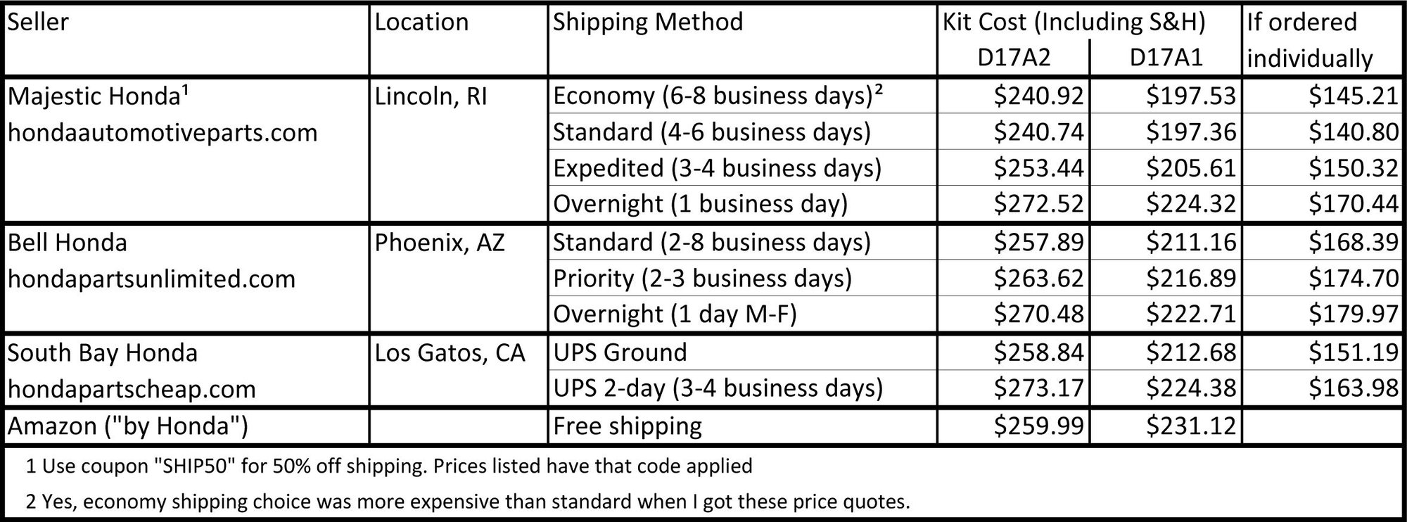

It has come to my attention (thank you BanoOmg) that it's cheaper to add each individual part to your cart as opposed to buying the gasket kit itself. Adding each item to my cart (as of 28Aug2018) yielded a cart total of $134.78, whereas the gasket kit was $233.25. Shipping was a couple bucks cheaper, too. Do so at your own risk, however. I have ordered items from Majestic (and other sites) that had to be "direct-from-Honda" shipped since the respective site I ordered from didn't actively carry the part I ordered.
->Proof of price difference<-
9Sep2018 update:
Individually ordering the parts of the gasket kit (using the parts list above) worked out very well for user BanoOmg. If you can afford to wait a bit (just in case you get multiple shipments/backordered), this is a very, very viable option. Still do so at your own risk </disclaimer>. For those of you that don't wanna risk messing up the parts numbers and/or for those that are impatient, ordering the pre-assembled kit is also still an option.
The gasket kit came out to $180-something if I choose overnight shipping from South Bay Honda (hondapartscheap.com). I coerced my local dealership to hook me up with their cost to get the gasket because I told them I could have it overnighted for hella cheaper. You may be able to do the same. Just make sure you tell 'em that South Bay Honda (or Majestic Honda) is an authorized parts dealer out of Los Gatos, CA (or Rhode Island) and they may comply with your request. Below is the current pricing from various online retailers.
Update on gasket price: (Current as of 9Sep2018)
The prices below will be updated at random intervals. The prices were calculated by adding them to my cart and selecting various shipping methods. All prices include shipping and handling to Las Vegas, NV 89129 (since that's where I'm at). I've also included the price for a genuine Honda OEM head gasket kit sold on Amazon, "By Honda, shipped and sold by [third party]". I've also added in the shipped price if you add the individual components to your cart. Price for the D17A2 and the D17A1 were the same, provided the only difference (as I mention above) is, in fact, the IM gasket part number.

Weather lookin good, commandeered a spot in the garage, got my parts.
Azumi's going in for open heart surgery. Wish me luck.
p.s. Here's what the gasket kit came with. I'll put in part numbers later, unless someone wants to come in and edit my post for me.
Head Gasket
Intake Mani Gasket
Exhaust Mani Gasket
Valve Seals (x16)
Spark Plug Tube Seals (x4)
Cam Seal
Rubber grommet-washers for the Valve Cover bolts (x5)
Valve Cover Gasket
Water Passage Gasket
