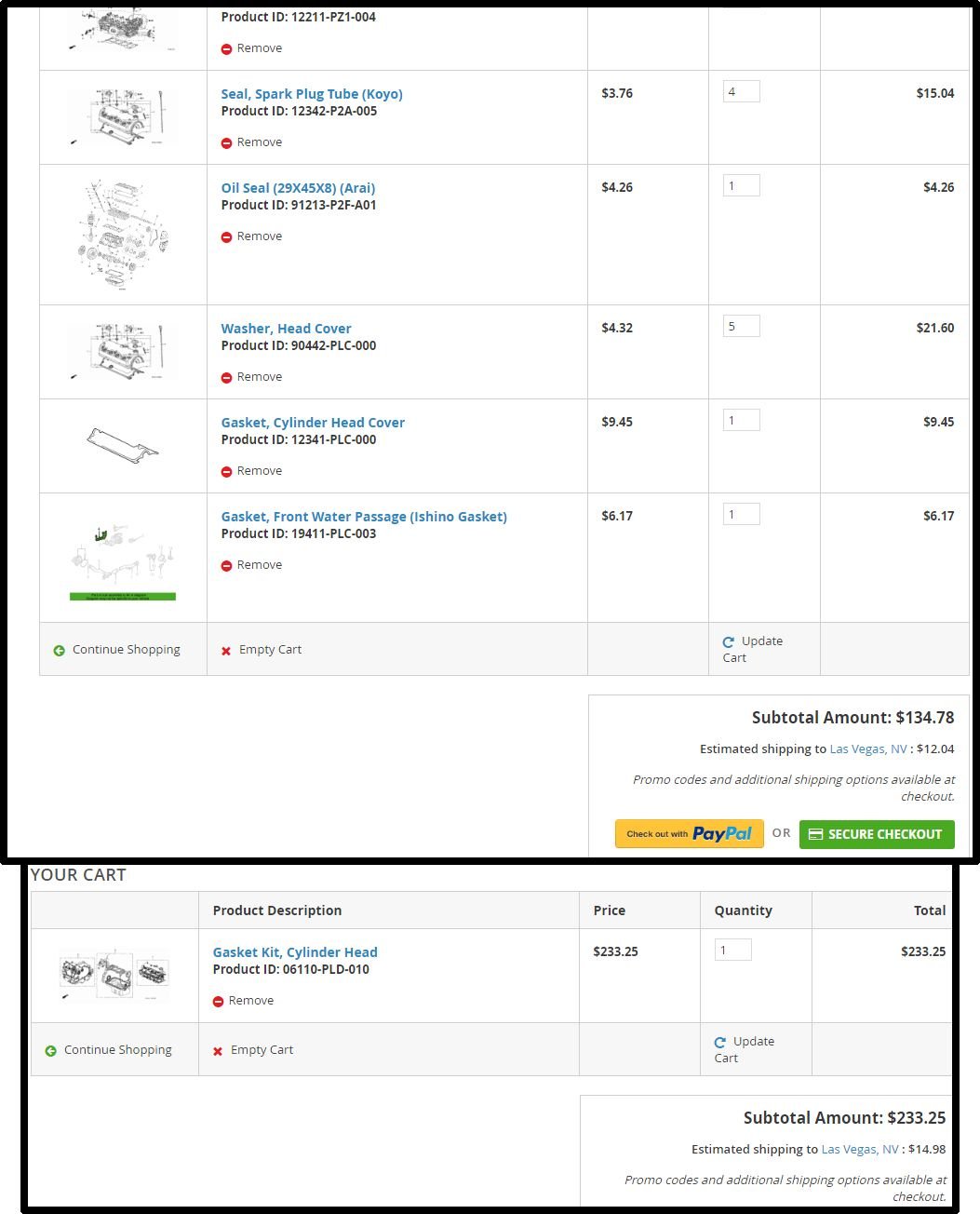

i was just checking the kit... no camshaft plug there... hope they have in the dealer...
Stage 1 is here too.
Soo, it seems i will need:
91213-P2F-A01 OIL SEAL (29X45X8) (ARAI)
11833-PLM-000 RUBBER, L. BACK SEAL
11832-PLM-000 RUBBER, R. BACK SEAL
12513-P72-003 PLUG, CYLINDER HEAD
dang...

I came here to ask the same question, lol. The tensioner bolt (newer longer one) should also be replaced with the tensioner, from what I read here.
What sensor seals should be replaced? My oil pump is leaking like crazy, so I'm trying to do everything all at once and be done with it. I'm at 113k miles. Is oil pan difficult to do at this point too?

I didn't see Wakko's reply until just now. I know about 5 months late to a response, but I can still provide valuable information for those just stumbling upon this thread.
Sensor seals, I didn't replace any unless they were a) included with the kit (none, unless you count the EGR valve gasket) or b) showing signs of wear (none did). Any sensors you'll have to remove in the process are purely mechanical in nature and do not come into contact with fluid systems (in particular, TDC and CKP sensor). Oil pressure sensor is on the backside of the engine and you shouldn't have to touch it. I think the seal on that is an o-ring, if any. Coolant sensors can stay in their respective housings and you shouldn't have to touch them, either.
Oil pan gasket is easy to do, and you can really do that at any time, even during an oil change. You will have to at remove the downpipe to get the pan out, so those gaskets you may have to worry about, too. Just a doughnut gasket between the manifold and the downpipe, and a carbon impregnated gasket for the mid-pipe connection. I don't have experience tinkering with a D17A1, but if logic serves me right, undo the manifold/cat connection (I think it's a doughnut gasket, too) and maybe a rubber hanger and move it out of the way to create clearance.
More on the oil pan gasket, though. On the D17A2 (US EX/Canadian Si trim level), the gasket is simply a bead of RTV along the perimeter. on the D17A1 (DX/LX trim level), the gasket is a physical removable gasket. On the -A2, make sure you get a vast majority of the old gasket material removed to ensure a good seal. I know it's RTV, so it'll conform to various imperfections, but better safe than sorry. A razor blade does well for this.
I reused the tensioner/bolt when I did my head gasket because I did a timing belt not too long before the head gasket went out. Just make sure everything is torqued properly.
I used crowsfeet extensions, and there was a small debate on how much extra torque was being added by the 1.5" change in torque wrench "length" with the addition of the crowsfoot, so I'll add another tidbit of LPT-ness here. With the addition of a crowsfoot, you may subconsciously think, "put this thing on in line with the lever of the wrench." I know I did when I first started using them. My **** retentive nature kicked in and it bugged me if the damn thing was even a degree off from straight. However, by way of fancy maths, you'll actually be increasing the torque applied to the fastener. Instead, position the crowsfoot extention at a 90-degree angle to the wrench, and it'll negate any length you add. I actually learned this tip while gunsmithing, and I didn't want to overtorque the barrel nut on my AR15 while adding a barrel nut wrench on the end of my torque wrench. After some extensive searching, found a video where they demonstrate this using a Snap On Tools torque wrench calibration machine (video linked below). putting a short extension on the end of their torque wrench added 25% applied torque, whereas positioning the extension at a 90-degree angle to the torque wrench made it read true to the micrometer torque wrench click.

Question Re: Headgasket replacement parts list
Hey Riceboy (or anyone else with the knowledge):
Is that honda gasket kit just the 31 items you listed in the first post?
When I replaced my headgasket, here's the parts I got
06110-PLD-010 Gasket Kit, Which includes the following: (*note: part number for the D17A1 -- dx/lx engine is 06110-PLC-010)
12251-PLC-004 Head Gasket
17055-PLD-004 Intake Mani Gasket (17055-PLC-004 for D17A1)
18115-PLC-J01 Exhaust Mani Gasket
12210-PZ1-004 Valve Seal A (x8)
12211-PZ1-004 Valve Seal B (x8) (They lumped all 16 seals in the same bag, and they were all visually the same, so I'm sure the seal a's are the same as the seal b's. From the drawings, it looks like "a" is for the intake side, and "b" is for the exhaust side valves. Regardless, you get 16 total valve stem seals)
12342-P2A-005 Spark Plug Tube Seals (x4)
91213-P2F-A01 Camshaft Oil Seal
90442-PLC-000 Rubber grommet-washers for the Valve Cover bolts (x5)
12341-PLC-000 Valve Cover Gasket
19411-PLC-003 Water Passage Gasket
If so, it's a LOT cheaper to buy the parts individually than as the kit. $191.33 for the kit, or $134.78 for the parts not as a kit.
I'm going to order the individual parts, and hope it doesn't bite me in the booty because I left something out. I searched part-by-part on three websites though, and got the 31 items each time.
Old Aug 29, 2018
  #59
Rep Power: 513
well, I'll be damned, seems as if it's about $100 cheaper to order each item individually from Majestic Honda. Cheaper shipping, too. To my knowledge, that's all that's in the kit. IIRC, I wrote out the "parts included" list as I was staring at the bags that came in the kit
Hopefully someone can verify. I haven't looked at a 7thgen HG kit since October, and at that point in time, I was more worried about getting it all put together than paying attention to what was in it.
edit: I added your tidbit of information to the initial post with a "do it at your own risk" disclaimer, to which I'll share here. I have ordered from Majestic Honda and Bell Honda where my parts had to be shipped separately since a few parts either site didn't actively stock. They had to put in a PO and have it shipped direct to me from Honda since the part was basically special order only. May or may not be the case with individual HG kit components. If you don't mind a potential wait (e.g. not in any hurry), saving hella bank may very be worthwhile. Last head gasket job I did, I sucked up the extra $100 upcharge the dealer had (they discounted it for me -- almost their cost price + tax) since I needed it ASAP and could get it overnighted for less money than they offered it for.
All right, good news for me
Thanks for listing all of the part numbers. It made it easy to check, but it doesn't hurt to confirm on the forum!
