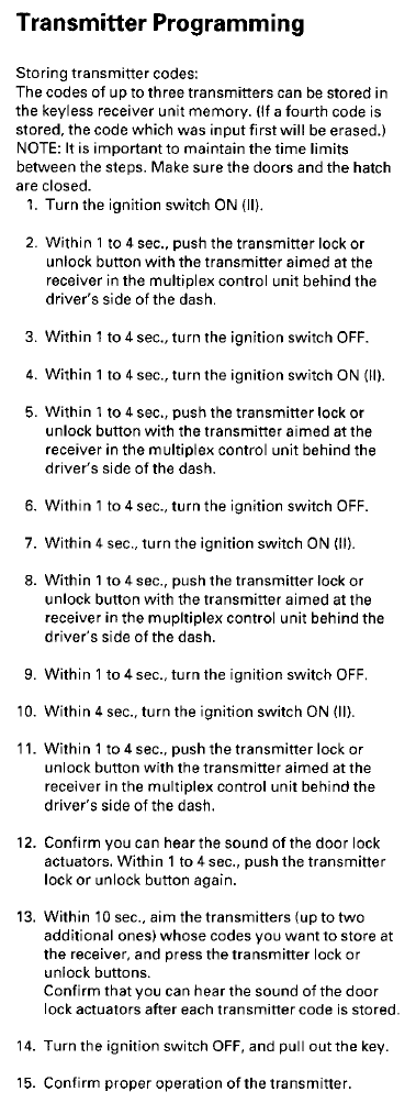

This is from the service manual. Is this how you were programming?
Old Sep 9, 2024
pscarbor's Avatar
Joined: Sep 2024
Posts: 9
pscarbor is an unknown quantity at this point
Re: Car will not enter programming mode (Hatch Si)
Thanks, I did all that - several times. Never entered programming mode. I even tried it with the working remote; still never entered programming mode.

Here is what the service manual says:
Then there are more tests, all aimed at determining whether a fuse is blown, a wire isn't connected, or the transmitter is out. Since mine passes this first test I assume the transmitter is good. Also I can stand fifty feet away and set off the panic alarm.
The programming instructions mention the door lock cycling after the fourth time. However, on my car, the door lock does nothing if the key is in the ignition.
Bottom line, I think the transmitter is good, but there is some Si-specific "trick" for programming a remote. Either that or I have a weak or bad fob. I returned it to Amazon and ordered a Dorman, I'll try that when it gets here.
