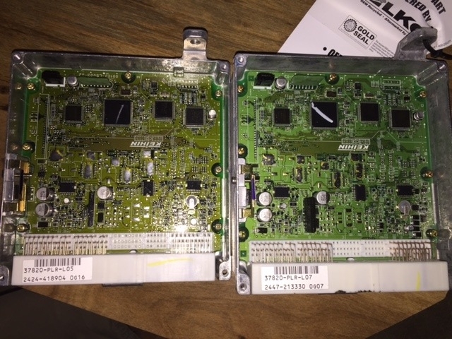

just following up. got the ECU replaced about 2 weeks ago. car's been back in business since then and running good.
The computer I got came out of an '03. I couldn't find any definitive information about which computers are interchangeable but from research it seems the 01-03 will work as long as the donor car has the same engine and trans as your car has. 04-05 has different 02 sensors than the 01-03 so they will not work in older cars. But I'm assuming you could swap between the 04 and 05 as long as the donor car has the same engine and trans.
Here's a picture of what the inside of the ECU looks like if anyone is interested:
