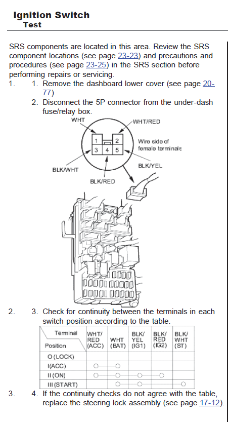

Sounds like the ignition 1 circuit is stuck on. My first thought is a faulty ignition switch. Use the below to test the ignition switch. You can see the IG1 circuit should have continuity to the battery feed only in ON (II) and START (III). You will have to check in OFF and ACC (I) as well. Give it a test.
