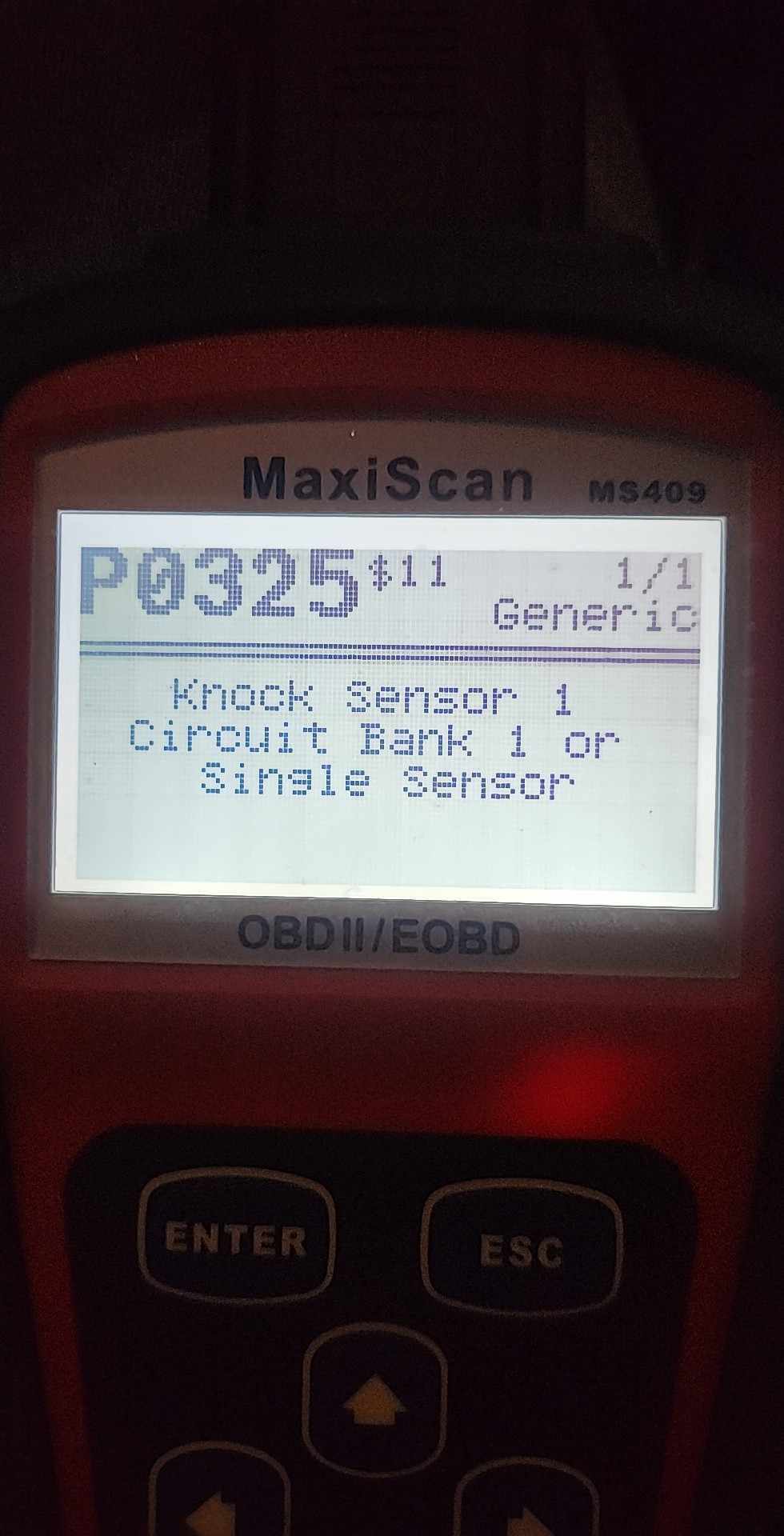

I need to replace 2 sensors just not sure exactly the match for my car
1. The dash low oil light doesnt come on
​light. Ran the car hard. Limp mode came on found out the dip stick had no oil on it... nothing else on my dash... cooool
2. Knock sensor came on. To fix I did a full tank of premium fuel and octane booster. I suspect a false sensor. Which one do I need?
bunch to select from on rock auto
which one do I need please and thank you

Dipstick usually is a .5 to 1 quart so it could have been low but not low enough to throw the light. How much did you add?
As for what sensor use a Honda OE parts website like Majectic Honda (use your VIN) and get the Honda PN from there and search for it.

Stick with oe honda (typically denso) for the sensors
