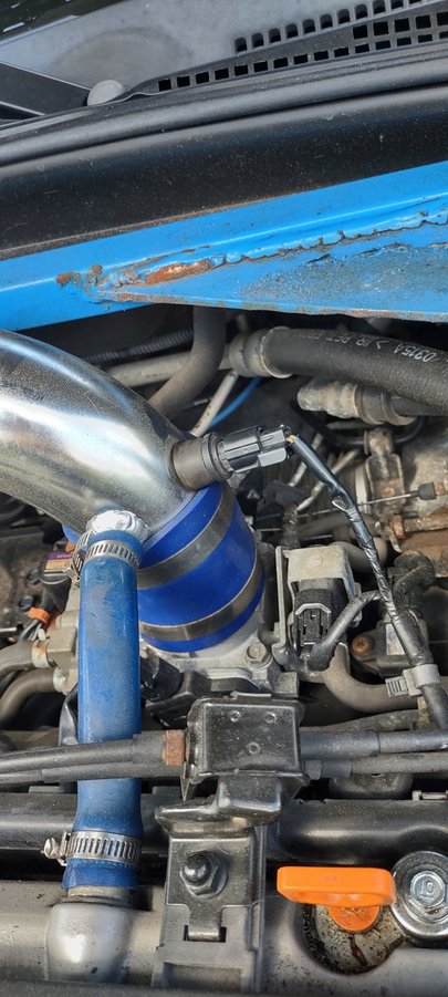

Where can I get one of these
Where can I get one of these. There's no name on the intake that I can see.I tried to pull it out and it was dry rotted and it split. I'm pretty sure it's a MAF sensor.

That's the intake air temp sensor
The grommet's p/n is 37881-P2A-000
the sensor itself is 37880-PLC-004

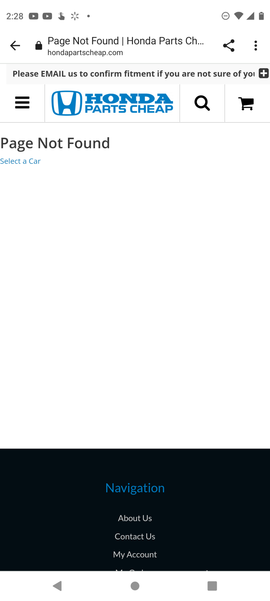

just select another site, can you read English? If yes, read the thread

Now I understand,choose another seller from the list..thanks.
