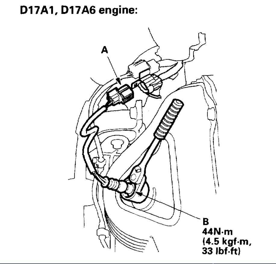

only HX/Hybrids have 3 sensors
the one for the header is just behind the radiator
Old Feb 11, 2023
Posts: 15,190
Likes: 1,609
Re: 04 civic lx afr and oxygen sensors
maybe HX only have 2

I’m missing the plug from that part of the harness but the wiring diagrams I was looking at show they run off of the same wires as the one just below the headers. I was rhi going about splicing the other plug and wiring in the sensor in the manifold to the the other o2 sensor
Old Feb 12, 2023
Posts: 15,190
Likes: 1,609
2nd one is just to tell that cat is working. wiring them together is gonna cause issues
