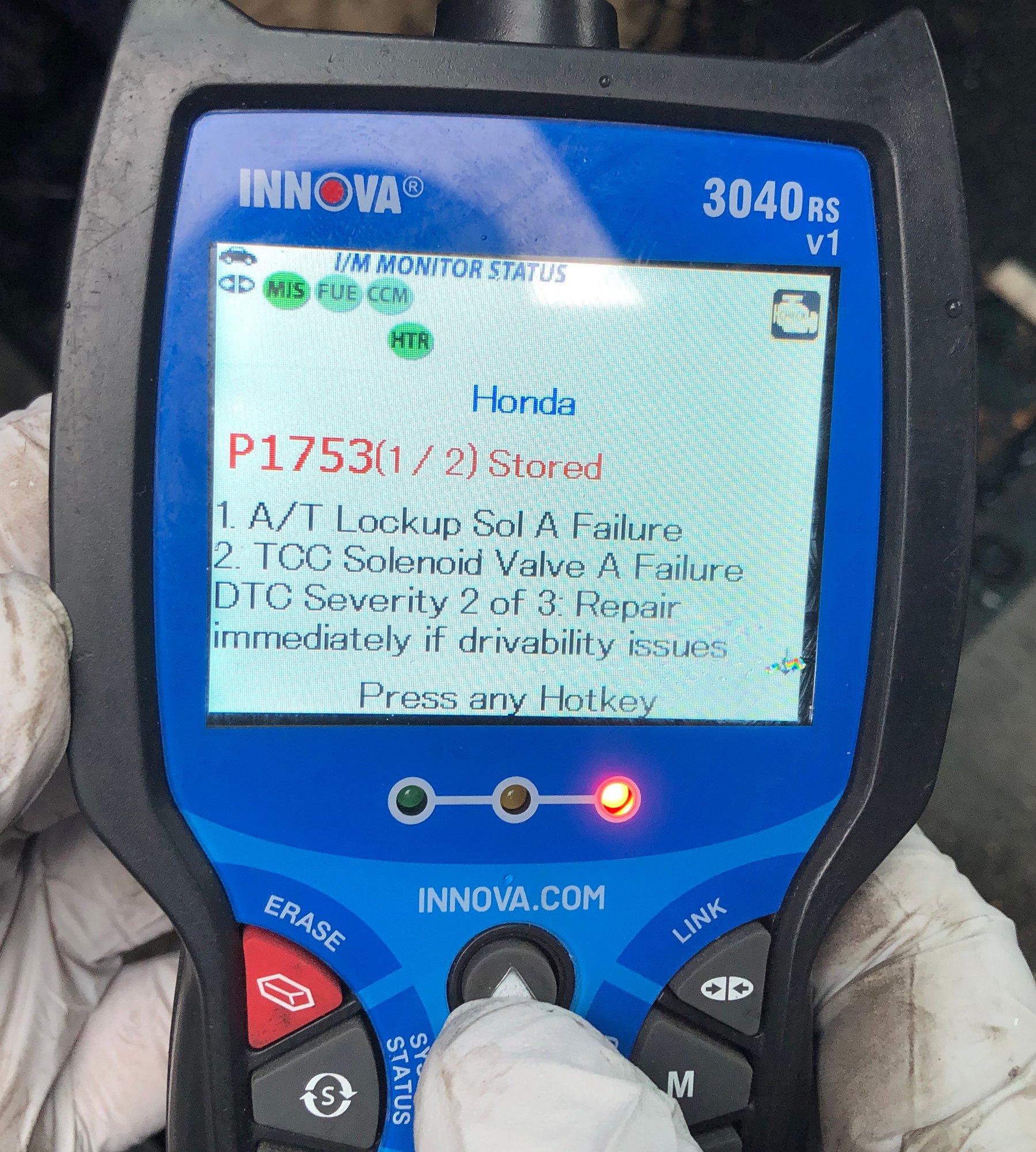

OK guys I stopped back at the garage and had the guys run the codes again for me and here's what they got (also pictured) P1753 (1/2)
1) A/T Lockup Sol A Failure
2) TCC Solenoid Valve A Failure
DTC Severity 2 of 3
I also found out that the new engine came with it's own ECU which they did NOT use but I do have it
Any help appreciated!

re: Transmission light and issues after engine replacement [solved]
do you know which car the engine came from? year model trim? was it an auto?
What is your car? DX/LX? EX?

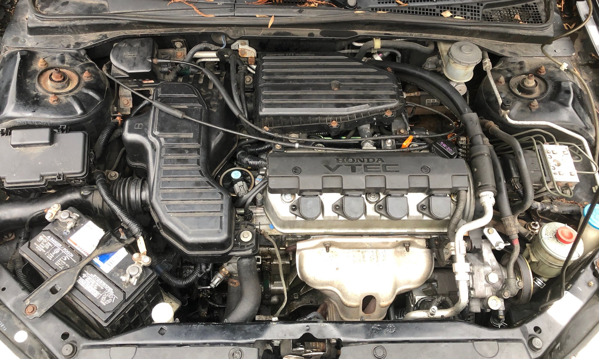

OK I will look for that code on the engine as well and thanks for the help. Here is the info on the car and also a link to the engine I bought. It likely wasn't the actual engine pictured but was told it would be the same

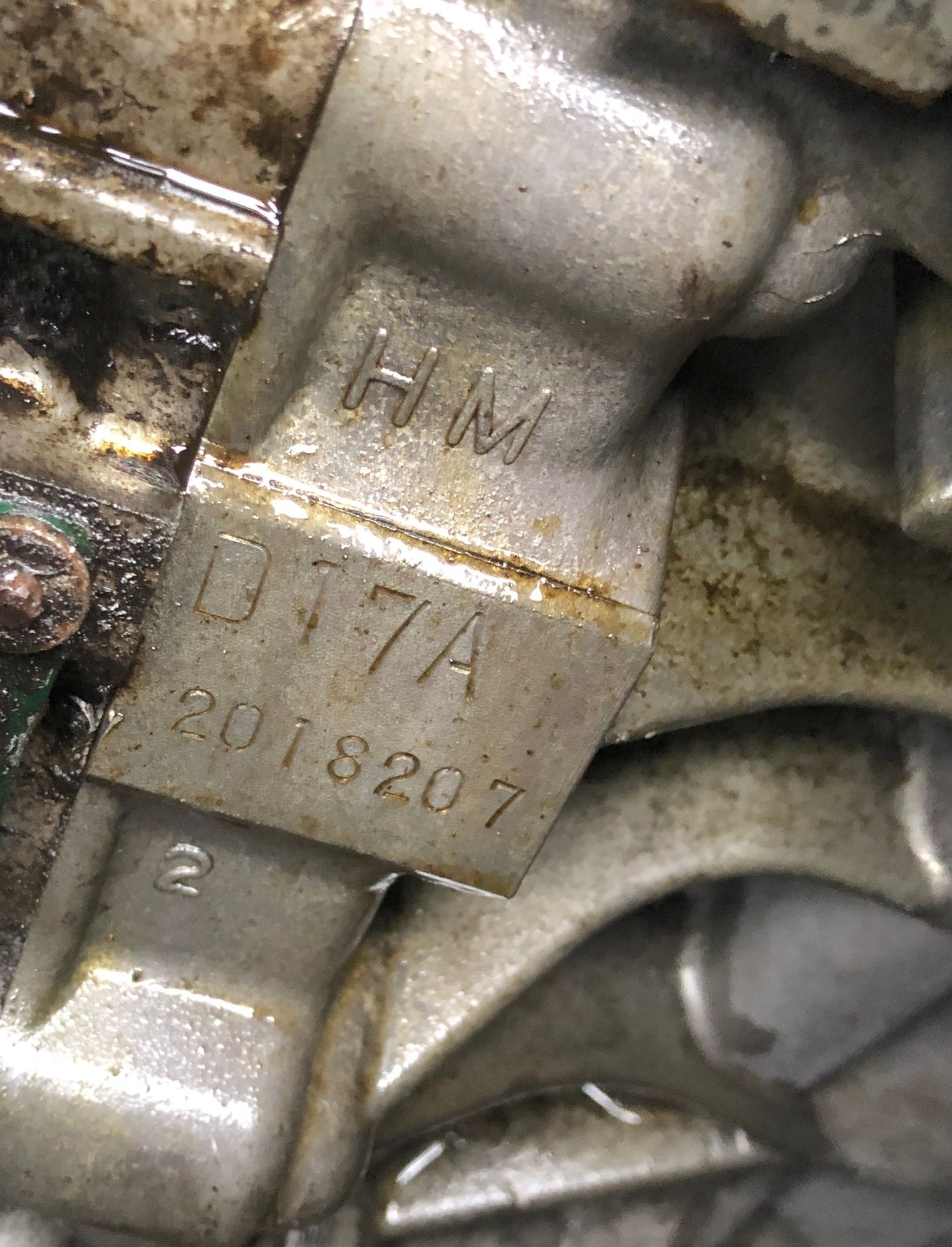

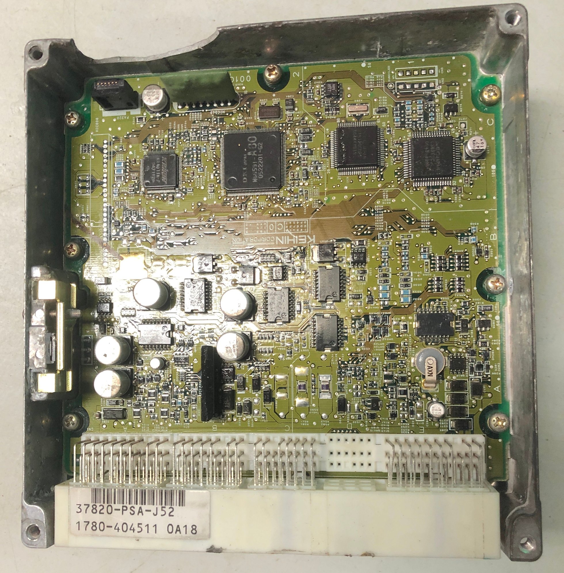

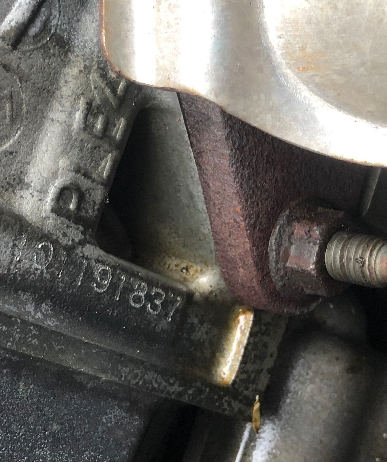

OK here's the engine as well as any numbers I could find and the ECU that came with the new engine if that's a help
Old Dec 13, 2022
Posts: 15,177
Likes: 1,605
Rep Power: 367
OK, so VTEC engine in both (your original is likely the D17A2 used in EX trim, D17A is the japanese version VTEC, both interchangeable) - OK, computer/engine should work fine with whichever you use
ECU/PCM - yours is for auto, the one that was for the engine you bought is unknown (does not say if auto or manual - ECU/PCM controls the transmission also in auto cars, manual ECU/PCM I think did not have the programming for trans if my memory serves me well)
PS: don't try to swap the computer, the keys need to be programmed to the computer. If you change the computer, you need to call someone to program it for you, or else it will stop the fuel supply (anti-theft)
