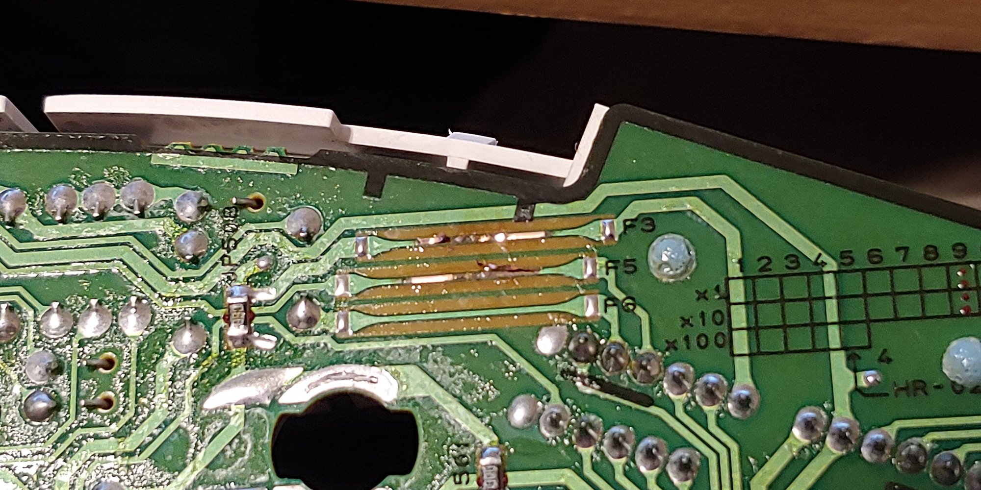

Here's the likely culprit....Due to old age or these new bulbs shorting it out? Thoughts?

Are the new bulbs larger wattage? If you get the correct bulbs you could solder a jumper across the "fuse".

I would guess one of bulbs fell out or somehow shorted out the lighting circuit, popping the two PCB fuses. The rest of the cluster should be ok, that's why the fuse is there. If you wanted to save some money I would add a jumper across both fuses and get the right bulbs.
Radio being disconnected would not have had any effect.

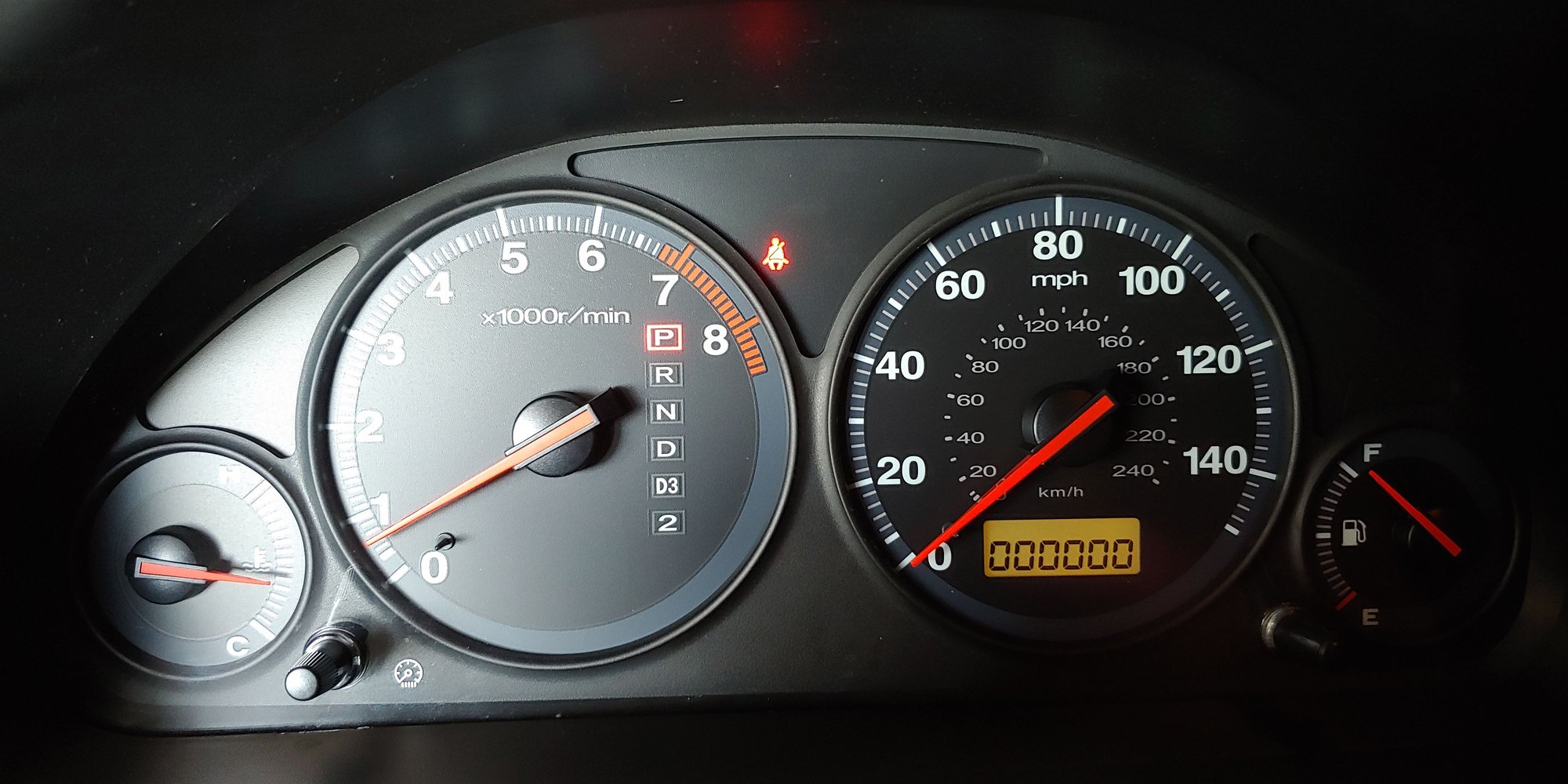

So, by some stroke of luck, I found a brand new Honda meter assembly on Ebay for $100 (Honda wants over $600 retail) and it works like a charm. I installed the new T5 bulbs and utilized the sockets from the old cluster. I'll be using this cluster while I wait for the "rebuilt" one, with the more accurate mileage, to arrive from Wisconsin. However, with the replacement unit installed and working, the issue was definitely just with the old cluster itself, as it didn't knock out any climate control lights or fuses.
I'll update once more once I get the mileage correct unit installed!
It is kind of neat to see all zeros on your odometer though! Braaaaand new! Lmao

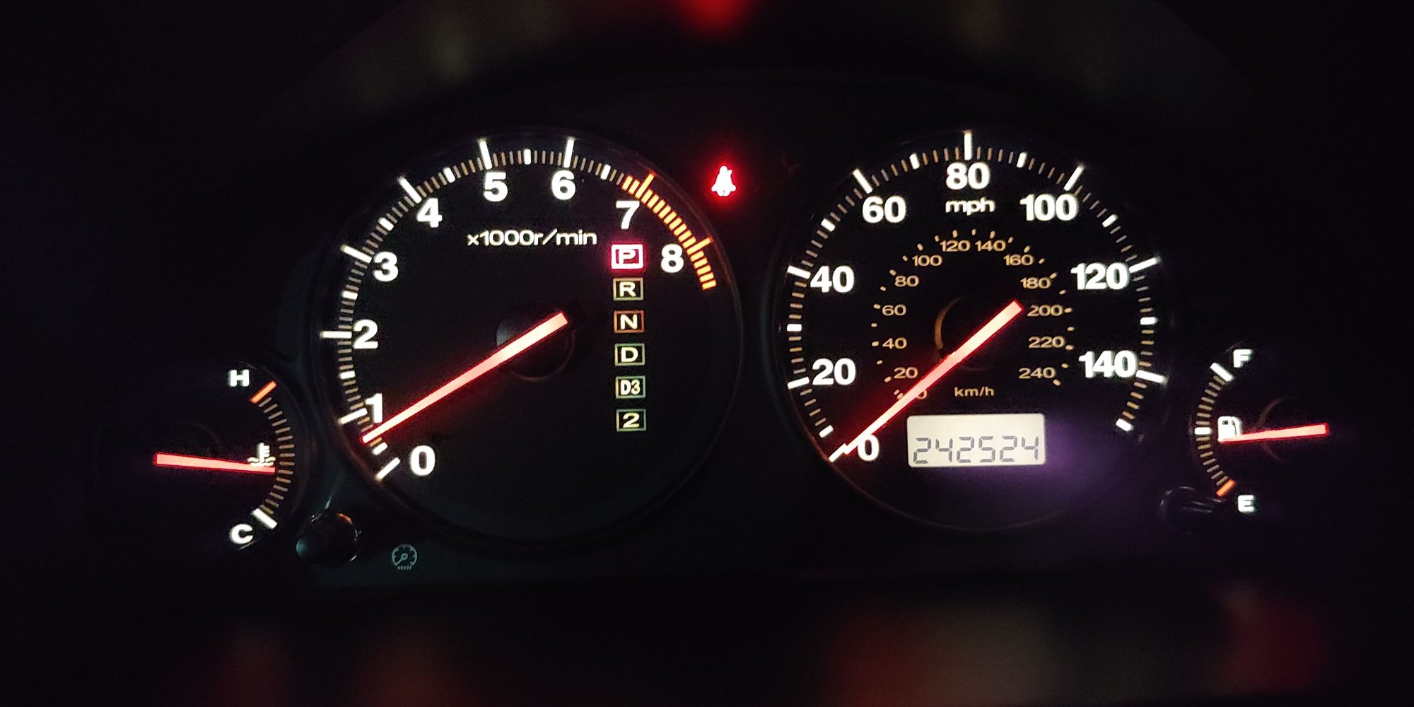

So I finally got the unit with the accurate mileage from Wisconsin and it's in good shape. However, I took several of the light sockets out and found they all contain the 74 size bulbs..and they all work fine....maybe my cluster was just on it's way out? Lmao. Either way, I'm happy and I also replaced my climate control neo-wedge bulbs while I had everything apart and disconnected. I hope this thread helps someone out there...
