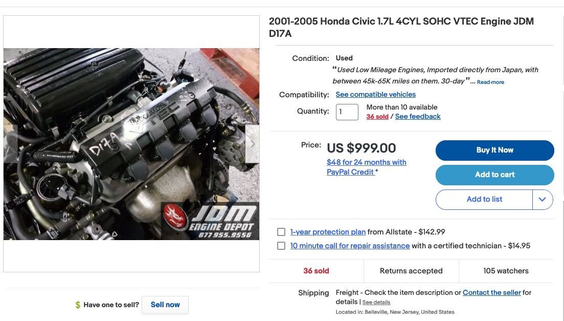

The issue with buying a replacement engine is it could very likely need a head gasket replacement too, or at least would need one soon. You also don't know how it was cared for in the past and would likely have more miles than your original. 135k is fairly low mileage in my eyes.

For the record, this is the engine I've considered
