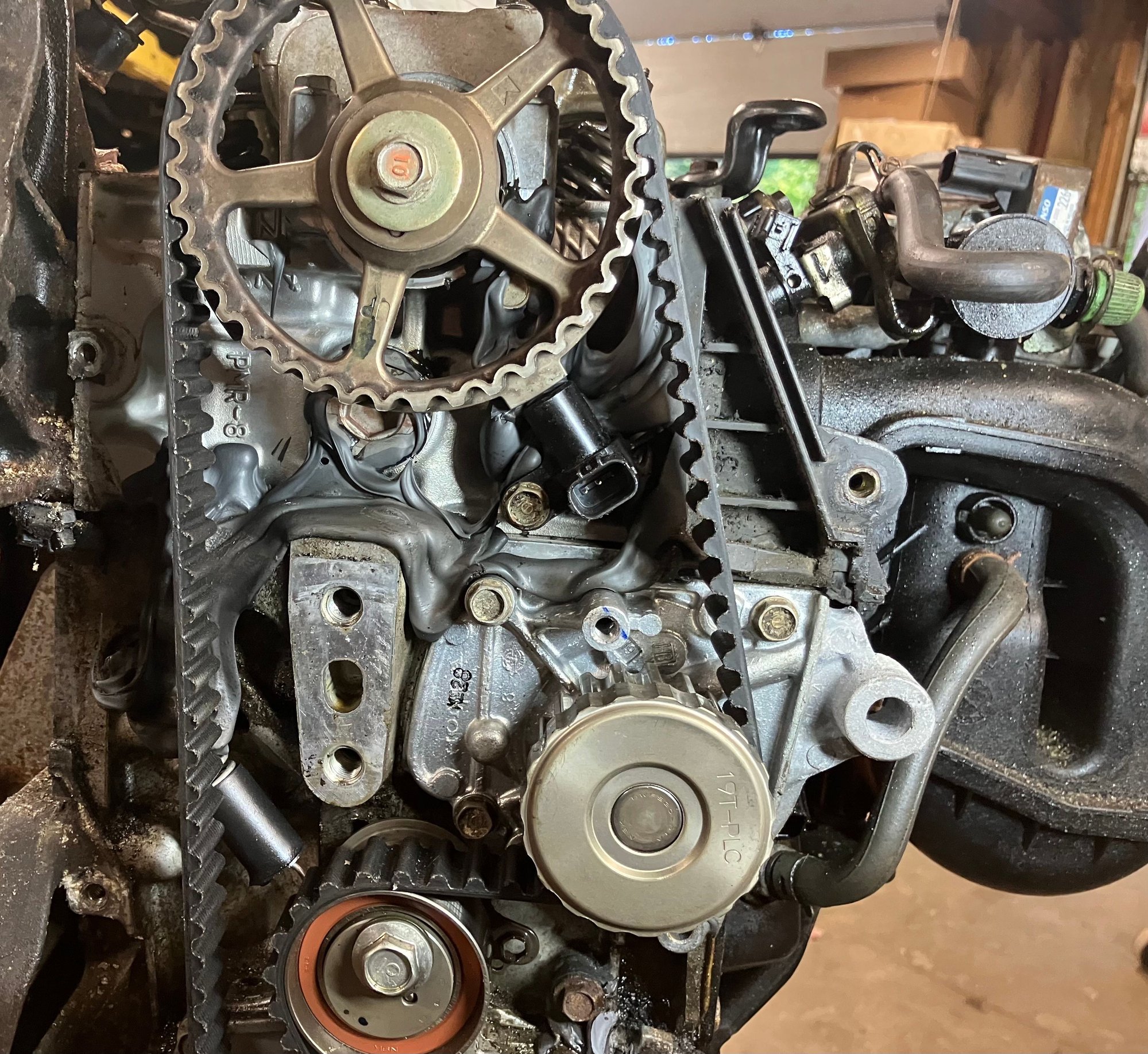

I’ve searched for a Timing Belt at a couple of Honda dealers including Majestic Honda. They say they are on back order and have no idea when one will become available. It could take months.
Considering a new Timing Belt was put on the old engine last November, is there any way it would still be good considering how hot the engine got when it overheated? It was so hot behind the timing belt the plastic shield that’s up against the head melted. See pic below

It's really up to you to decide. Best case it works fine for 90k miles, worst case it snaps in 5k.
You can get a timing belt kit (belt, tensioner, water pump) on RockAuto for much cheaper than OEM. I've used the Gates brand a few times (<$100) but never put many miles on it before selling. Aisin is also a good brand (~$120).

Could I re-use the tensioner that was installed last November?
It was new when installed. Would the overheating have affected it?
Old Sep 28, 2022
Posts: 15,176
Likes: 1,605
Rep Power: 367
Re: Denso ignition coils any good?
well, the tensioner is the worrisome part of the aftermarket timing belt kits, some failed...
the belts, don't remember many cases. As for the overheating impact to the belt, I would think not even the belt itself would know... Much less us. All we can tell is that rubber does not like heat that much, can survive the normal temps. How much above that, no idea

Is there any reason to believe that OEM Tensioner bought and installed last November would be compromised by the blown engine due to its overheating that would render that Tendioner as unusable due to the extreme heat?
Old Oct 4, 2022
BrotatoChip's Avatar
Super Moderator
Joined: Jun 2012
Posts: 5,073
Likes: 2,096
From: Ohio
Rep Power: 224
I wouldn't think so, but weirder things have happened.

Considering you melted the timing covers I wouldn't trust it.
