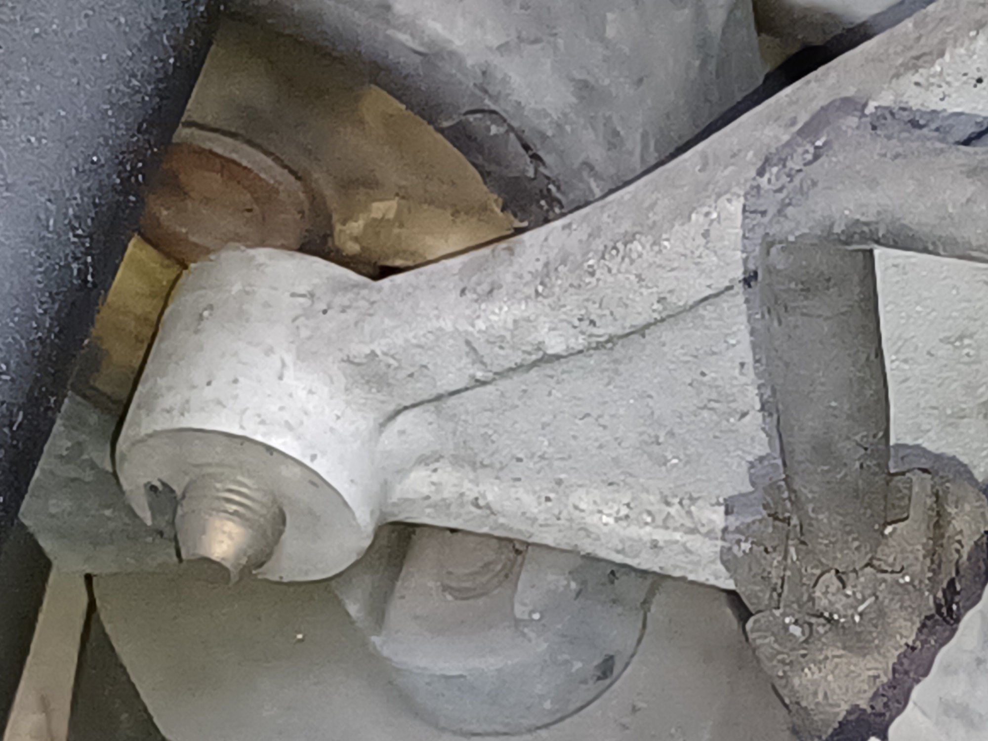

this is rear motor mount or tranny mount. This is current issue on hand

Zoomed out photo would be helpful

That mount doesn't even look right to me. The rear mount is steel and that appears to be aluminum.
Wait, unless this is a hybrid. Those look like they have an aluminum rear mount.

so, describe what the issue is so we can try to see it in the picture.

I've been told that a motor mount could not tear. I know tht the bolt goes all way through center of rubber mount.
As seen in picture alignment of bolt to rubber mount is in different positions. Previous owner caused
So I looks like bolt may have broke or it did tear the rubber of the mount

Looks like the bolt is snapped, so you need a new bolt and potentially that aluminum bracket if you can't get the chunk out
