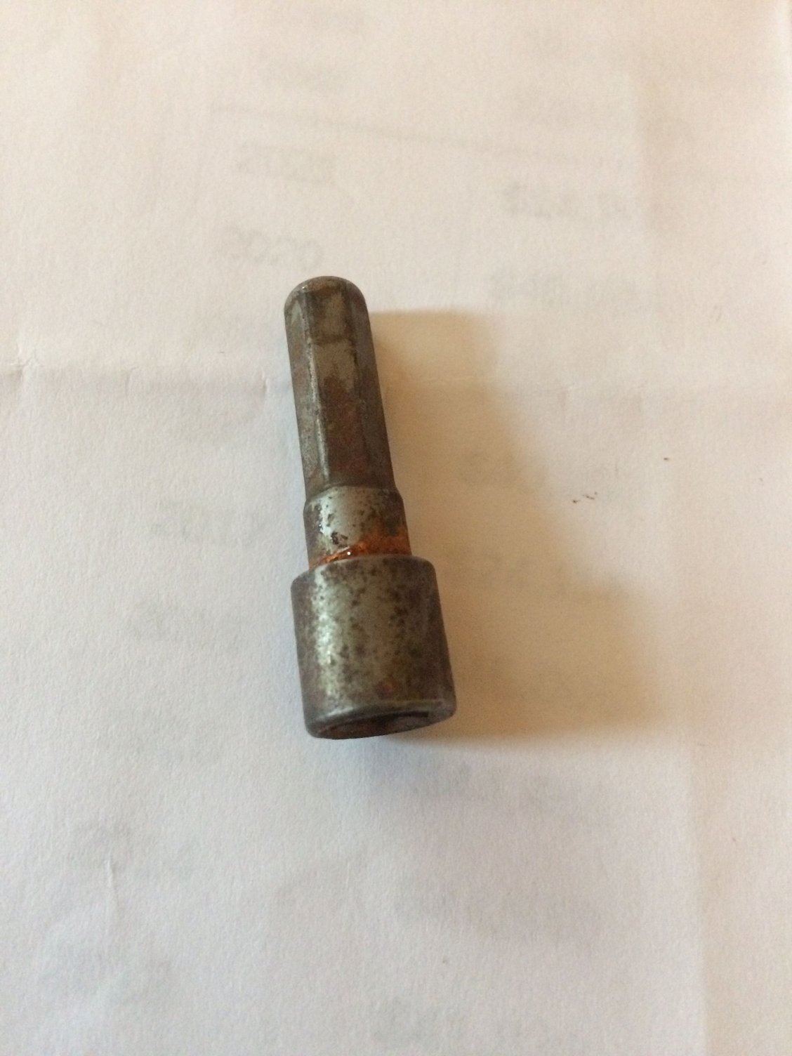

I had the gasket move and I crushed it and had to put in another . This repair is not beginner level . Your leak looks just like mine did. WARNING dropping a bolt can get lodged in the engine and you will have room to barely find it or not find it at all . This did not happen to me, but I dropped a bolt and it landed on the driveway fortunately ,but an extendo magnet would be wise to have.ONE TRICK when tightened the bolts that hold it on , use a nut driver socket for a screwdriver, and a 1/4 " open wrench . I did not have a small enough articulating socket extension that would fit on the one bolt . Don't drop the socket or the wrench . One thing about this type of leak is that your oil stays clean since you have to continuously add a little . Almost like an old Oil loss Harley engine
