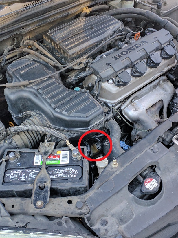

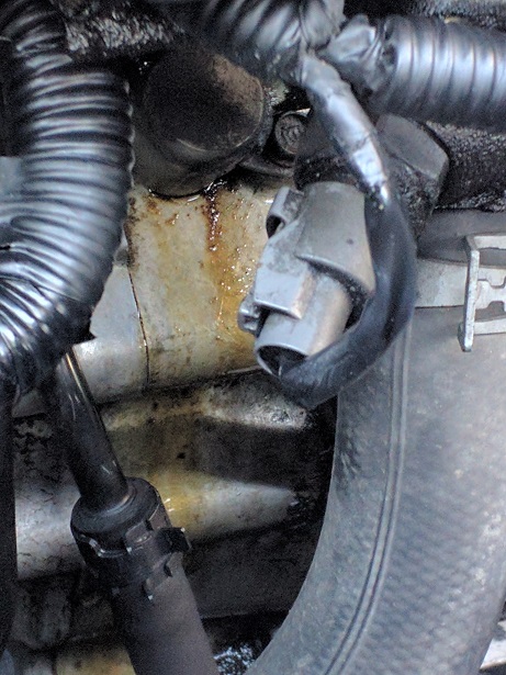

First time poster.
I have a 2005 Honda Civic, LX. Have kept up with preventative maintenance. I'm not a mechanic.
At the required interval (120,000 miles or so, I'd have to check) I bought a set of various gaskets and seals from Honda and had them replaced.
I'm at about 140,000 miles now and smelled/noticed a bit of oil on the engine. I hit the engine with Gunk Engine Degreaser to help identify the source of oil leak. Shortly after cleaning it (just running the engine idle) I notice the oil was dripping here (see pics).
Curious what seal this would most likely be? Also, if it might be something I could replace myself or if it's best left to a professional.

could be the cam plug (where the distributor would go on the older engines),
or maybe the valve cover gasket
you can remove that big silencer box and the air intake tube to get a better view. it's like 6 10mm bolts. you can run the engine with it removed, wont hurt anything

I agree looks like engine oil so would check cam plug on side of head. Cost ab $8 from Honda and easy fix.

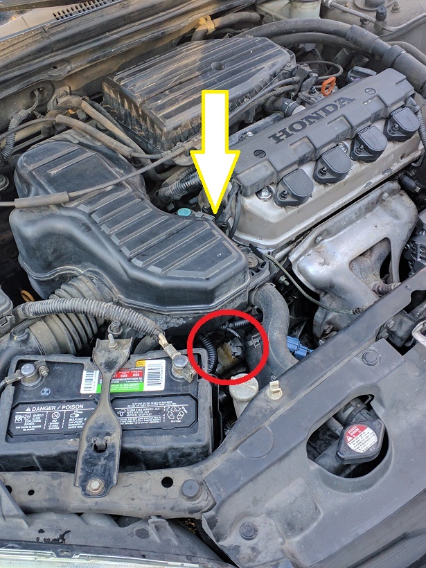

Cam shaft end plug or cylinder end plug/cap. Part #6 in this diagram:
https://parts.sonshonda.com/showAsse...rimLevel=24777
Honda part #
12513-P72-003
Location shown in photo with arrow.

I wanted to apologize to everyone for not coming back to this thread to thank you for your knowledge.
It most certainly was the cam plug and was an easy fix. Plug was loose to the touch.
I watched a few videos online, some suggested putting some RTV silicone on the O-ring of the new plug, but when questioned, the Honda Service Tech at the parts counter said that was a bad idea. "Just coat it with oil" so that is all that I did.
