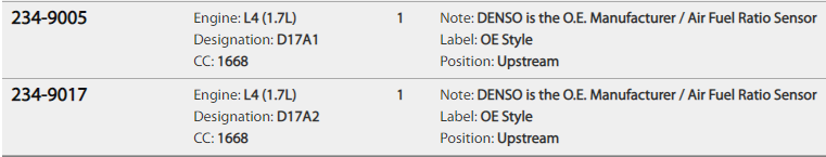

Denso
Honda Part number 36531-PLM-306
Denso Part number 234-9005 corresponds to the air/fuel ratio sensor for the 04-05 D17A1
Why denso lists a different part number for the DX/LX and EX engines is beyond me.
Wire length
