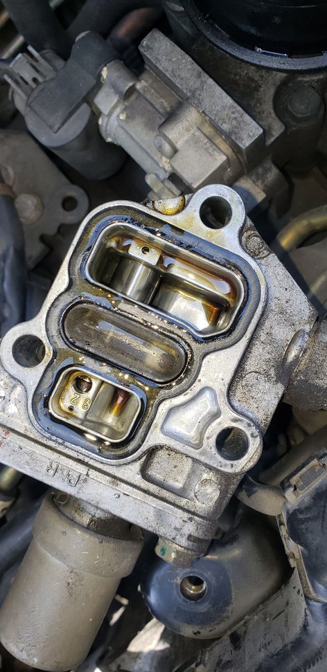

So here is the vtec solinoid. Doesnt look clogged but gonna replace that %&$@#

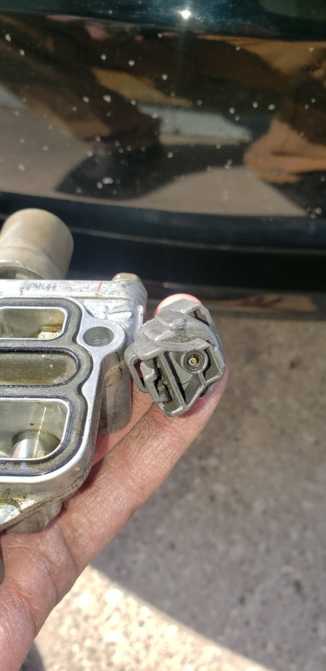

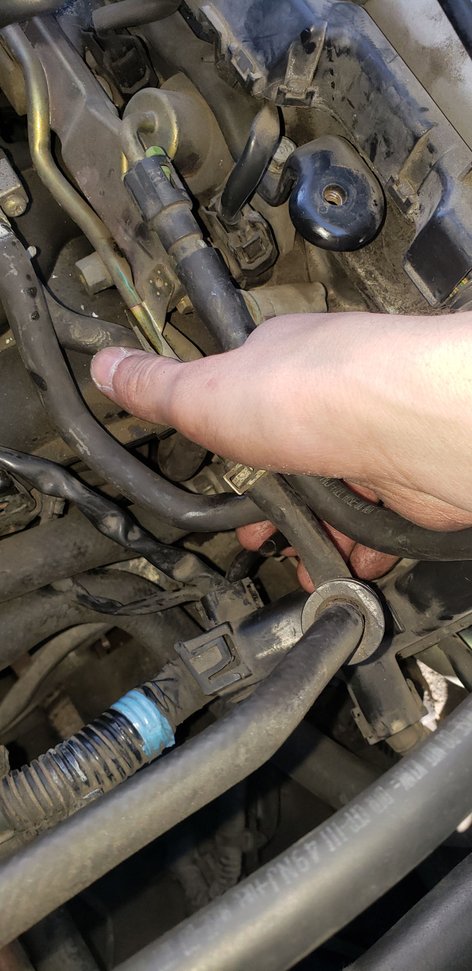

Also any tricks to get the blue clamp off? Its stuck on there. Tried pliers and even a flathead

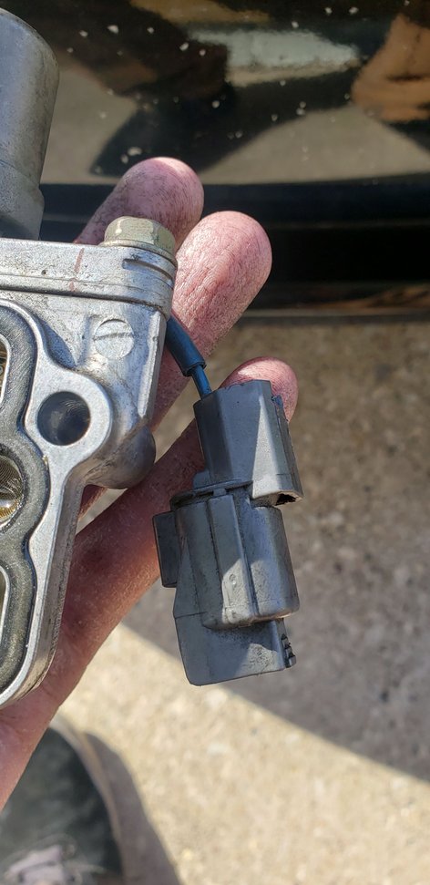

Now this wire broke inside of the switch when i was trying to take apart the top blue clamp to the switch. Whats my problem now guys? ;_;

You should have left the VTEC solenoid alone until finding the leak. You're likely only getting that code because oil pressure is too low (hence the flickering warning light). I would cut that connector off a harness in the junkyard (leaving enough wire to work with) then solder it to your engine harness. For the time being just bolt he solenoid back on and figure out the low oil pressure issue.
Check the oil level, make sure it's in-between the dots. Start the car and look for a leak, should be noticeable.
