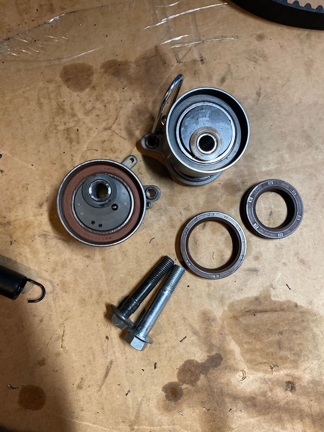

Just bought a timing belt kit for my 01 Honda Civic DX And I got these in the package. When I bought the kit online it didn’t include these. So I’m not sure what I’m supposed to do with them

After further investigation and comparing the old tensioner to the new these look like some sort of seal that is supposed to be on the tensioner. The new tensioner doesn’t have the same type that came with the package already installed so I’m really confused as to what I am looking at. Not to mention the bolt diameter and length is bigger than the original, but the thread pitch is the same

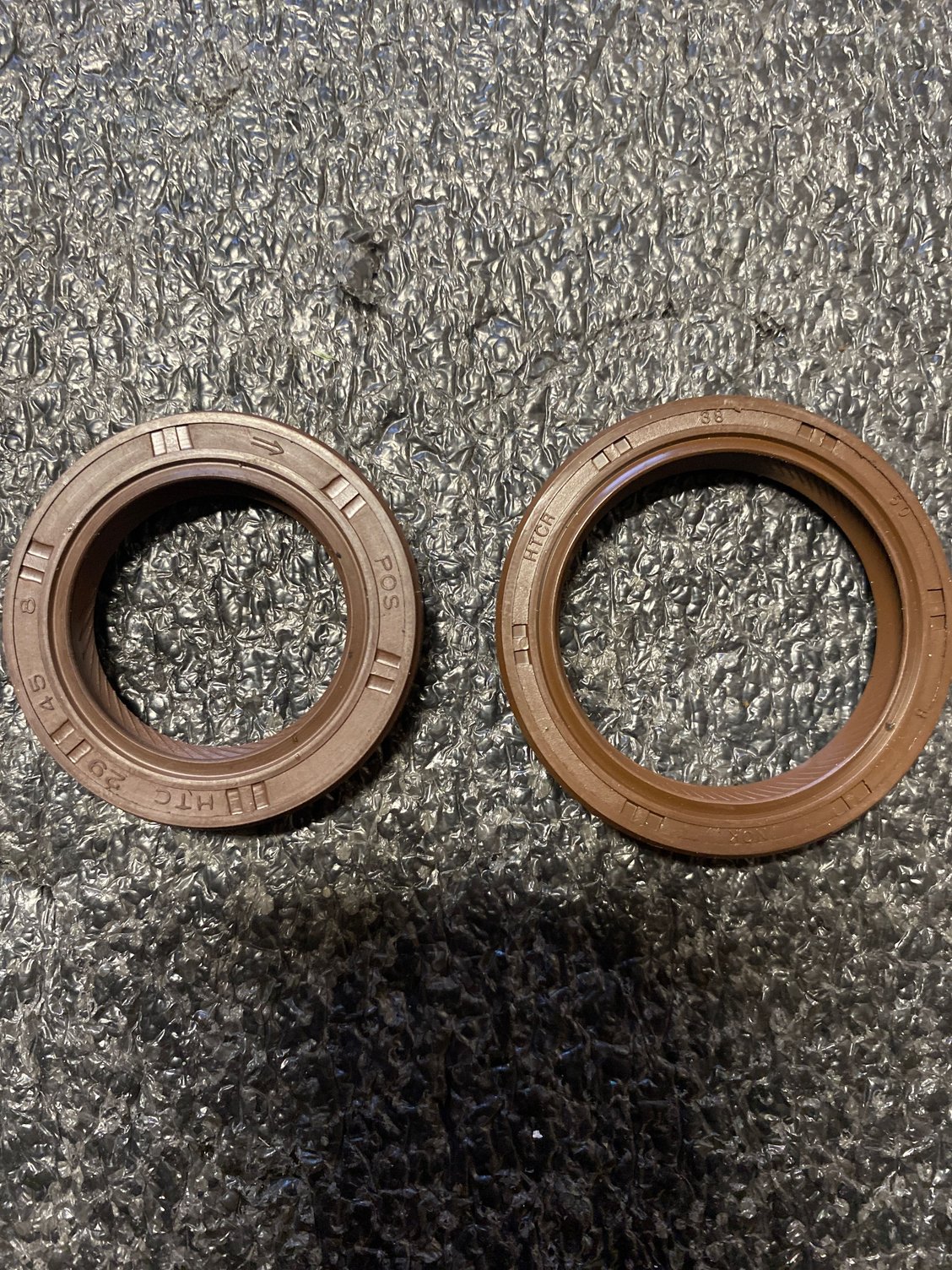

Camshaft seal and front oil seal.
91213-P2F-A01
91212-PLM-A01

I didn’t know that was part of a timing belt job... It looks a lot like the seal that goes in the bearing of the belt tensioner

So I looked it up and it matches up, thanks for the help!

How do I install these?

you don't need to do it now.
but if the front seal starts leaking, you will need to do everything again.
If you try now, you will need to remove the harmonic damper (pulley) at the crankshaft.
camshaft, you are not opening the valve cover, replace if there is leak around the camshaft
