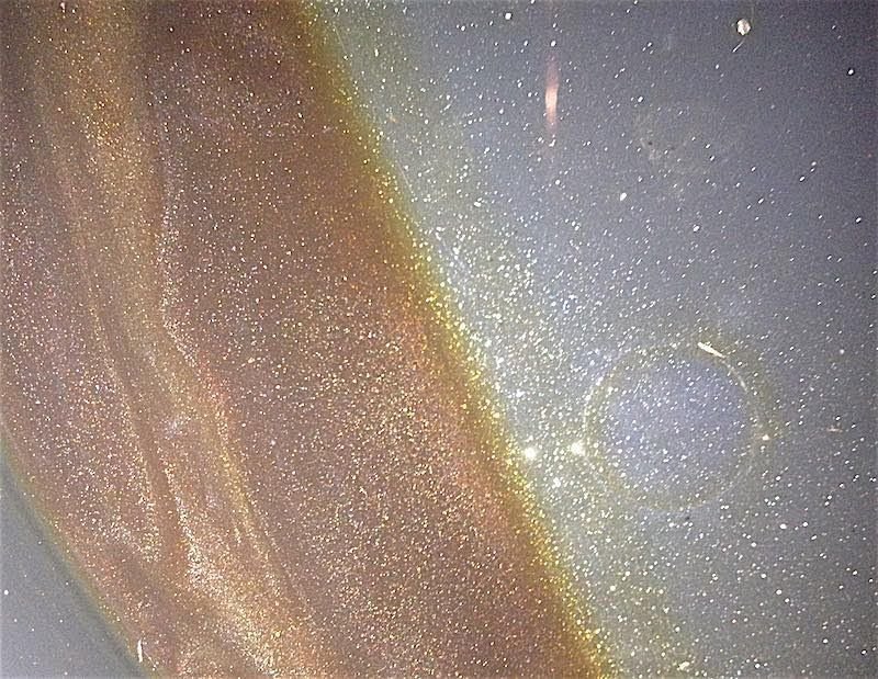

That sounds like a rod knock to me. Who replaced the rod bearings?
Dump out some oil into a catch pan, do you see lots of tiny metal particles? Something like this?

Update: I drained some of the oil, it’s has some particles in it like in the picture below but not much.
