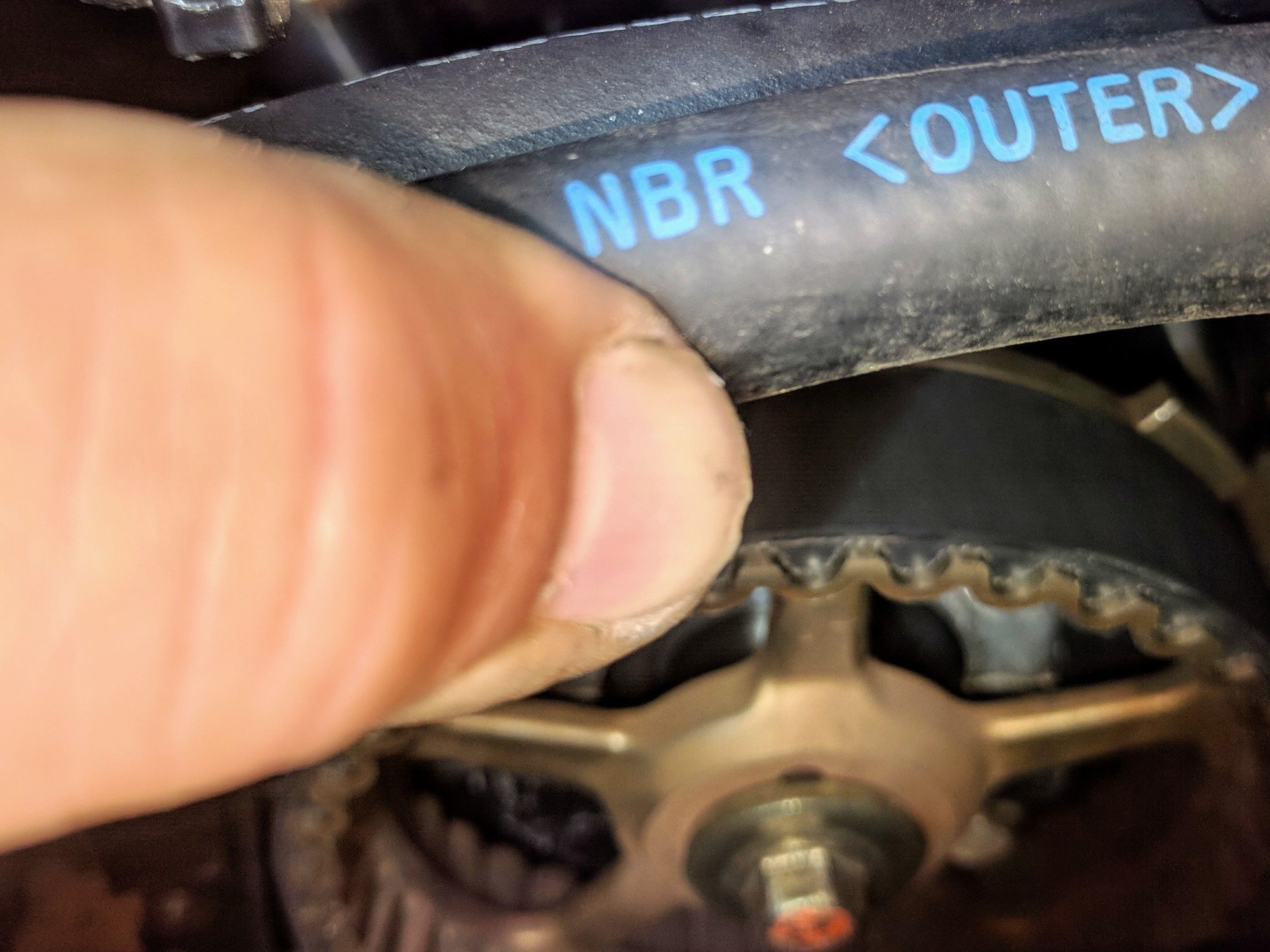

As the title states engine won't start and run after doing the head gasket, water pump and timing belt replacement. Used a Aisin WP and Timing belt replacement kit and bought the OE Honda head gasket kit from a online dealer. So quality parts being used.
The car sat in our shop for about a month with the head off waiting for the machine shop to get done with it and then finding time to put it back together. Which btw was last week (vacation time). Rotated the crank bolt two full revolution to make sure timing marks where lined up(all good). So put back on all the accessories and covers and misc stuff. Went to start it up and all it would do was turn over. The green key wasn't flashing at while cranking over. So not the immobilizer module.
I was stumped on what might cause it. So even though I relentlessly didn't want to. I pulled the front of the engine apart again and removed the valve cover. Rechecked the marks and everything is GTG still, belt hasn't slipped for some odd reason... nothing. So I put it back together Sunday yesterday and still no start. Just turns over. Gets spark and fuel. As I was a idiot out of frustration and manipulated the gas pedal while starting the second go around. Pretty sure I flooded it. So let it set overnight and pulled the plugs and still wet. Took a touch and air hose and dried them off and pushed air into cylinders to dry them out too. I did use a straw and my finger and maybe placed about a teaspoon of oil in each cylinder thinking maybe walls and rings dried up some.
Haven't put the valve cover back on yet with coil packs and try it again. Any of you guys have anything to add I might look at. I'm stumped and it ran good before doing this. Didn't use or burn oil at 198,131 miles. #1 Piston is TDC along with crank balance mark lined up with pointers on lower TB cover.
TIA guys
Bill
Level w top of head
Level w top of head
Camshaft sprocket \"UP" in the up position along with the keyway.

Please ignore my message if its not applicable..... but Its hard to tell from the picture, is the cam 180deg out? I don't see the "up" on the camshaft sprocket, its blurry. Also... reassembling the head.... all valve lashes were in spec? How's the compression?
Timing is spot on...checked 3 times.
Yeah, it's in the UP position. Just a cruddy pic as my phone ain't all that spiffy no mo(5 years old).
Maybe my valve clearances are out of spec. They(machine shop) did cut new seats prior to installing new valve seals and resurfacing the deck. I can get the car to fire for a split second before starting to dreaded none start just turning over. I gave up after about 4 hours of being inside of our none heated/cooled shop. With it being 95* with 70%+ humidity=112* feel like on the outside(oven inside shop literally).

Man Im sorry I just saw that your last pic has a caption about the "UP" marker. I didn't see that before. I'm getting too old. If you got fuel, spark, its not the anti theft system, timing is dead on, crank and cam sensor are hooked up and they have powers and grounds intact there are no codes and everything else checks I would want to do a blowby test to make sure each cylinder is sealing well. After all it ran great before. Just my very unprofessional opinion of course. Good luck.
