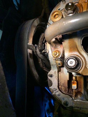

I removed the oil pan when I discovered this loose gasket/seal dangling between the engine and timing belt (see below).

Re: What gasket/seal is this?
Lower timing belt cover gasket

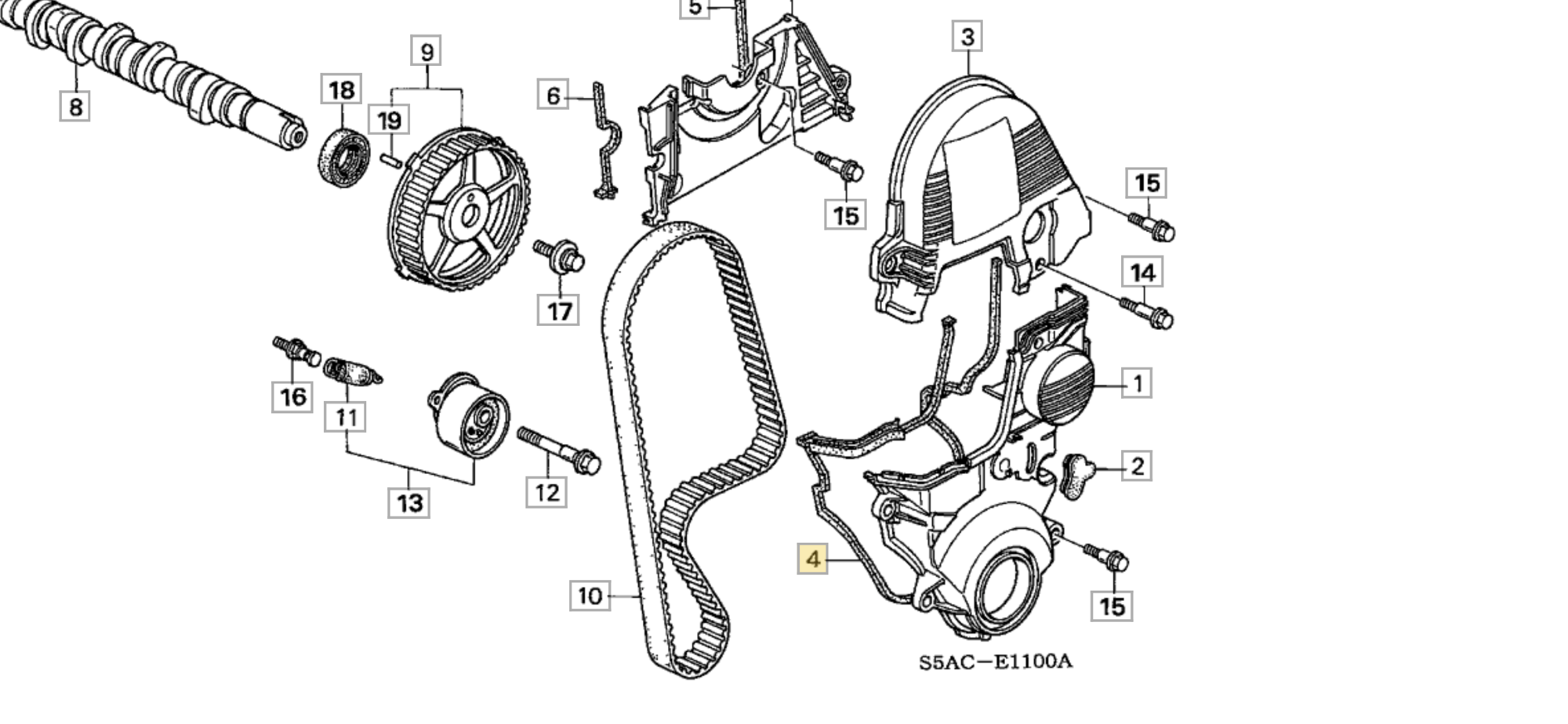

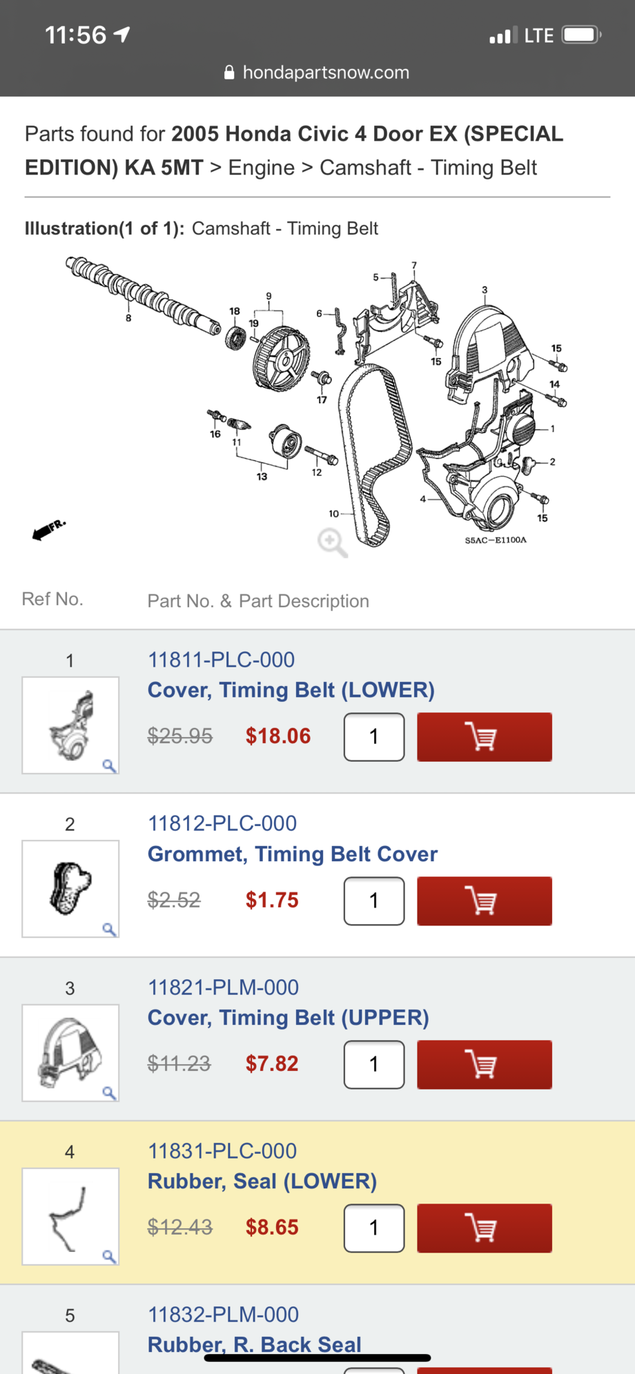

Is it #4?
Old Jan 26, 2020
Wankenstein's Avatar
Joined: May 2012
Posts: 3,634
Likes: 109
Rep Power: 211
yes..that's the one.
Oil gets on them and they degrade and tear.
Old Jan 26, 2020
Rep Power: 513
Yep. Looks like. Not fun to replace. Might as well do a timing belt replacement if you're almost due for one since you have to take the crank pulley off to get to that gasket.
