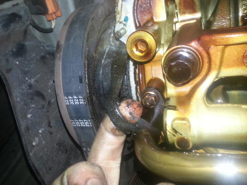

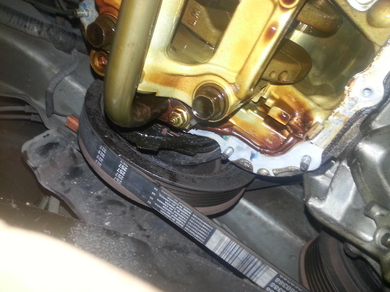

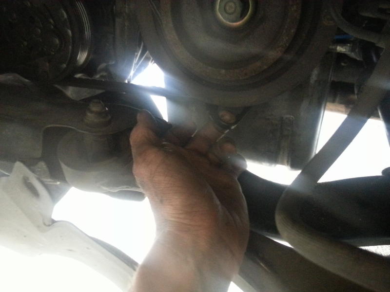

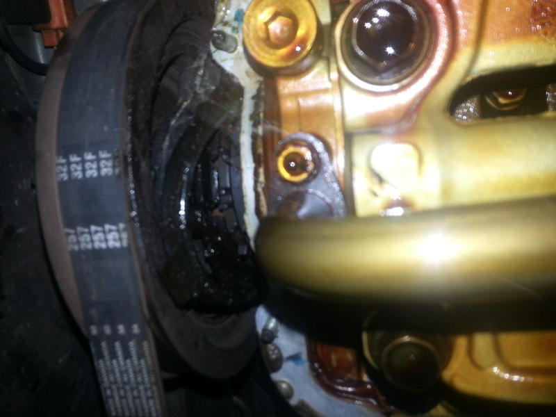

Yesterday I noticed motor oil all over my oil pan. Upon further inspection I noticed a seal / gasket between the crankshaft and oil pan. I thought it was the oil pan gasket, the part that is curved just below the crank. Well I took the oil pan off and realized the original rubber piece was still hanging. So I spent a lot of time changing the oil pan gasket for no reason. This is a bad leak that really needs to be fixed. Here are some pics of what I'm talking about. Any help would be great thanks.

You can see it best in the third pic.

Lower timing belt cover gasket.
Old Mar 23, 2014
Re: 2002 civic ex: Mystery gasket/seal
Lower timing cover gasket has squished out....but that's not your oil leak.
The timing cover gasket is only a dust seal.
The oil leak is elsewhere in the timing belt area, probably front cam seal/front crank seal/valve cover gasket or the like.
