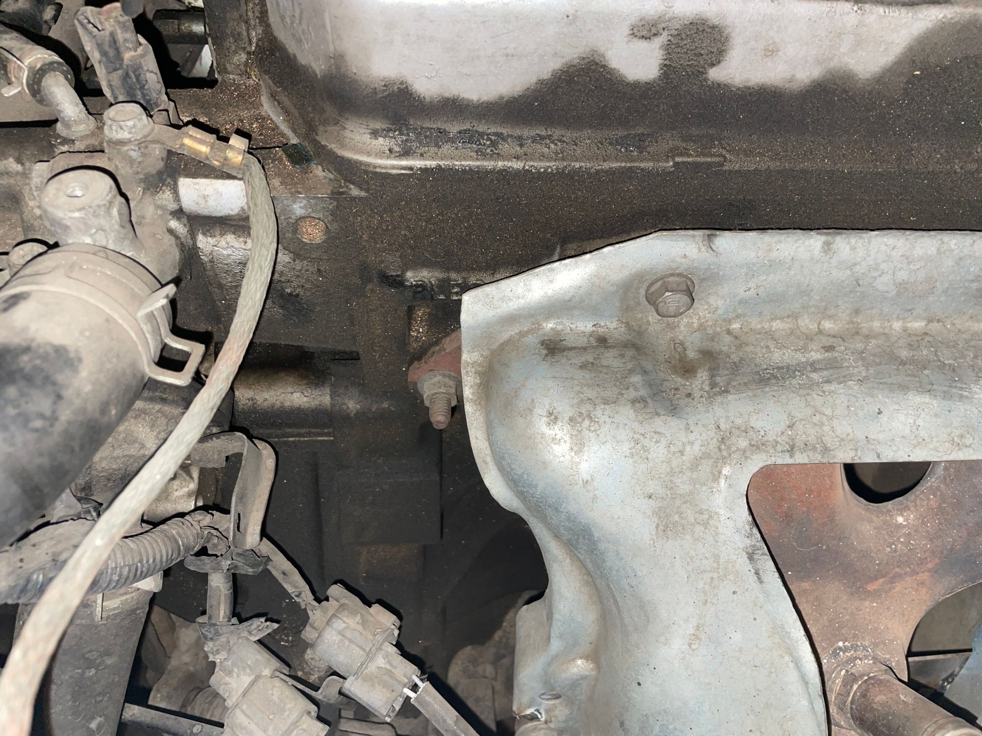

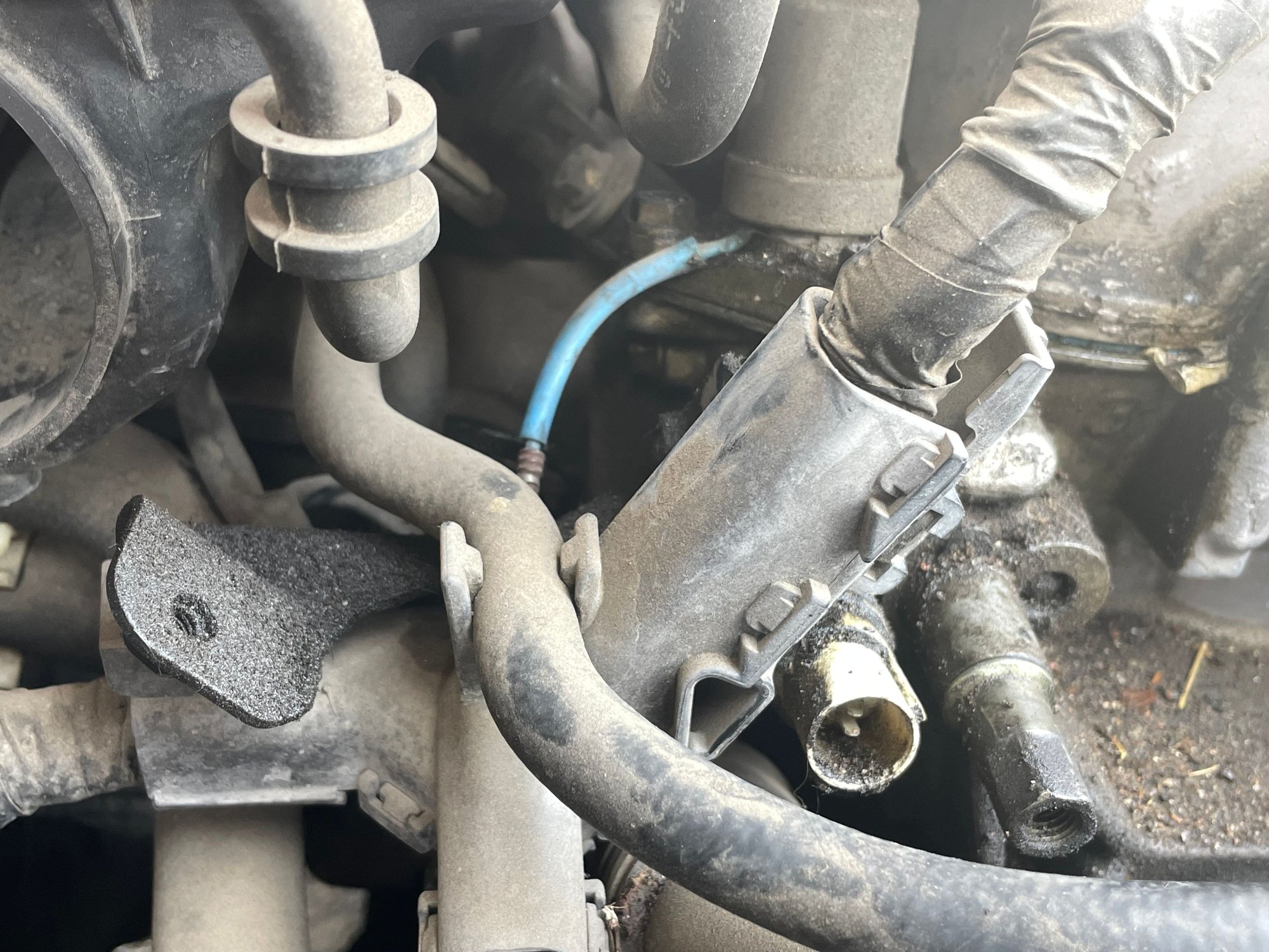

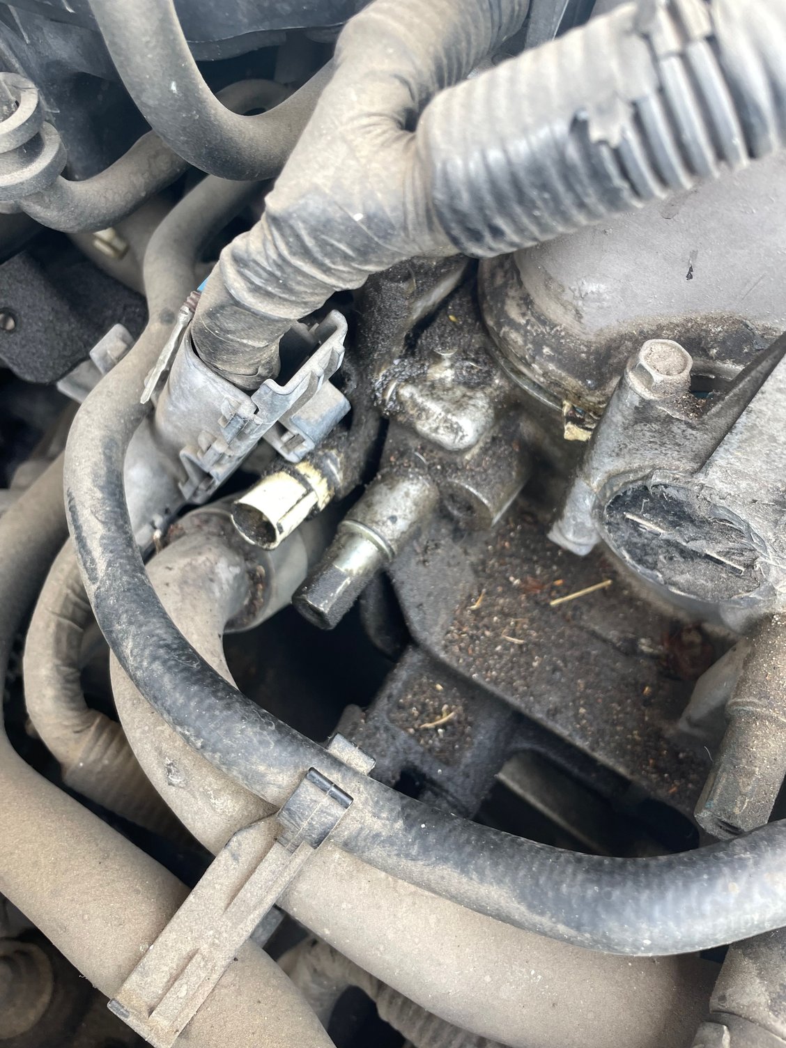

I’ve had this car for 6 years and Can’t figure out what plugs into this and what the blue wire plugs into? It looks like vetch but my car is suppose to be a lx . Can someone please help me?

I looked at the pics before I read what you wrote past "blue wire," and my initial reaction was, "VTEC solenoid." Then I read that you have an LX.
Do us a favor, and try and locate the engine stamp on the front side of the engine (about a few inches below and to the left of where the exhaust mani mates to the engine, right next to where the engine mates with the tranny) and see what it says.

if it says "D17A" or "D17A2", then the engine has been swapped with a VTEC variant.
If it says "D17A1" then it's a non-VTEC engine (and what came originally equipped in the LX trim). If this it is a D17A1, I'm willing to bet head gasket blew and whoever did the repair swapped in a D17A2 head and just left the VTEC solenoid unplugged because 1) nothing to plug it in to and 2) unless a VTEC controller or D17A2 ECU/engine was swapped in, it's not gonna do anything.
edit: it's 100% a VTEC solenoid, by the way. Location of that solenoid and what it looks like? Yeah, 100% it. Here's a pic from ebay for a D17A2 VTEC solenoid. Same blue wire coming from the same place. White plug sticking out the side.

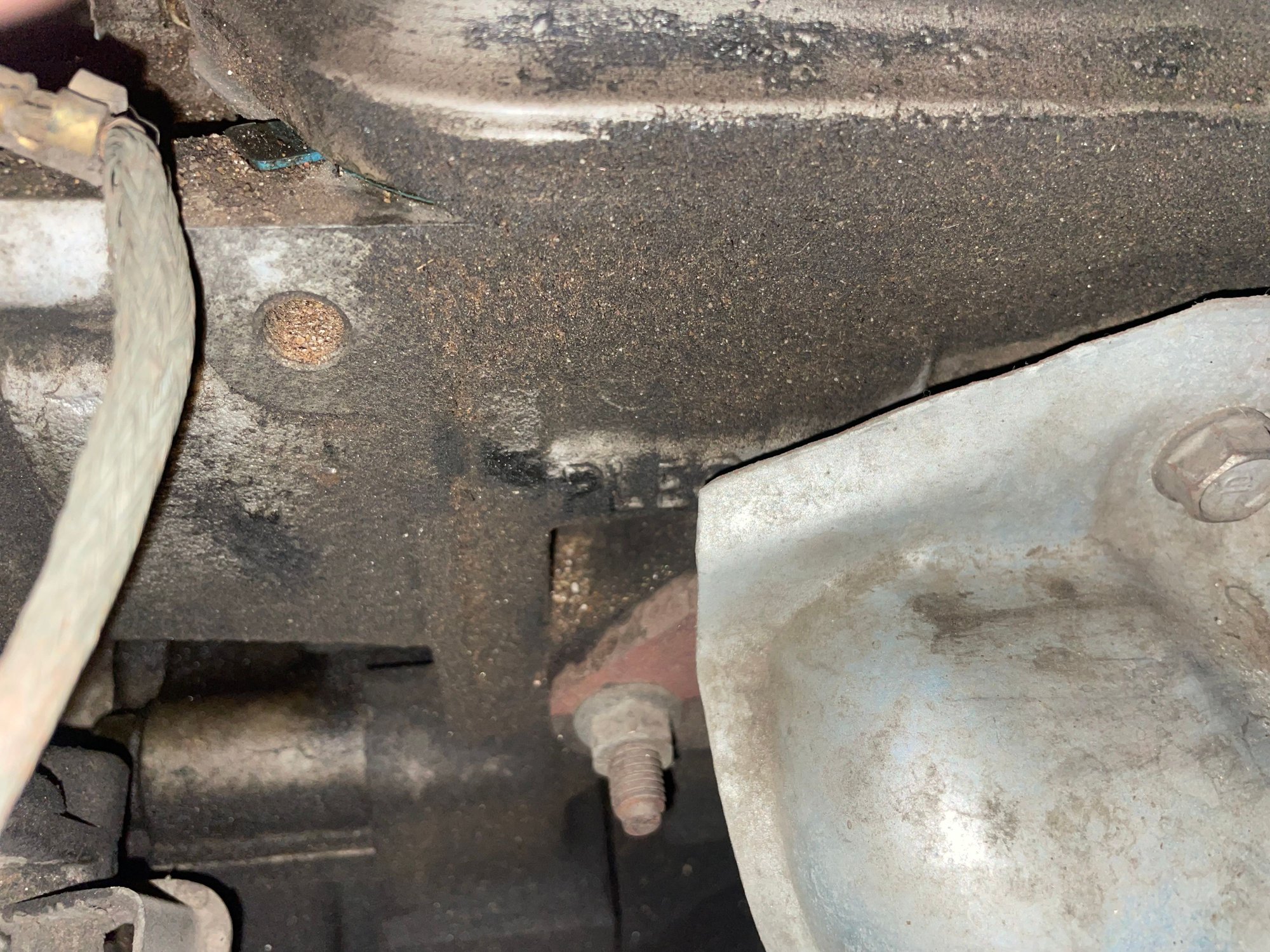

Don’t see any stamp that says that. It’s says PLES

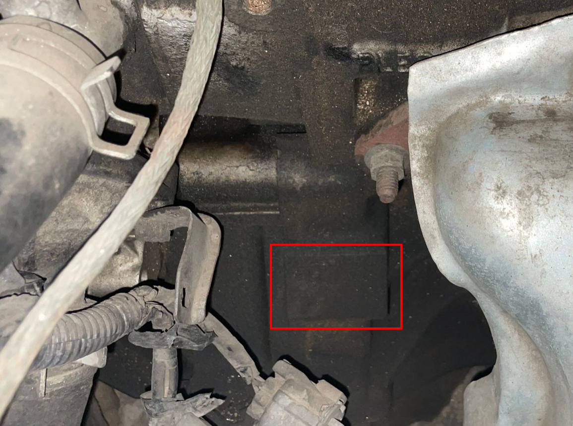

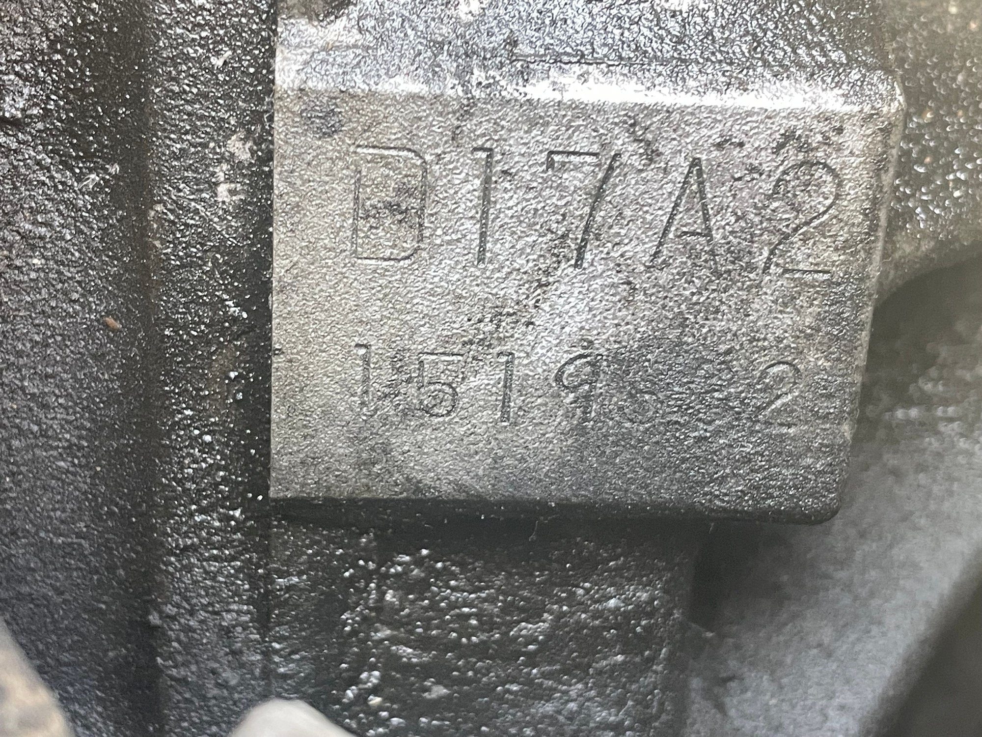

It's this right here. You're gonna have to clean the gunk off to read it.

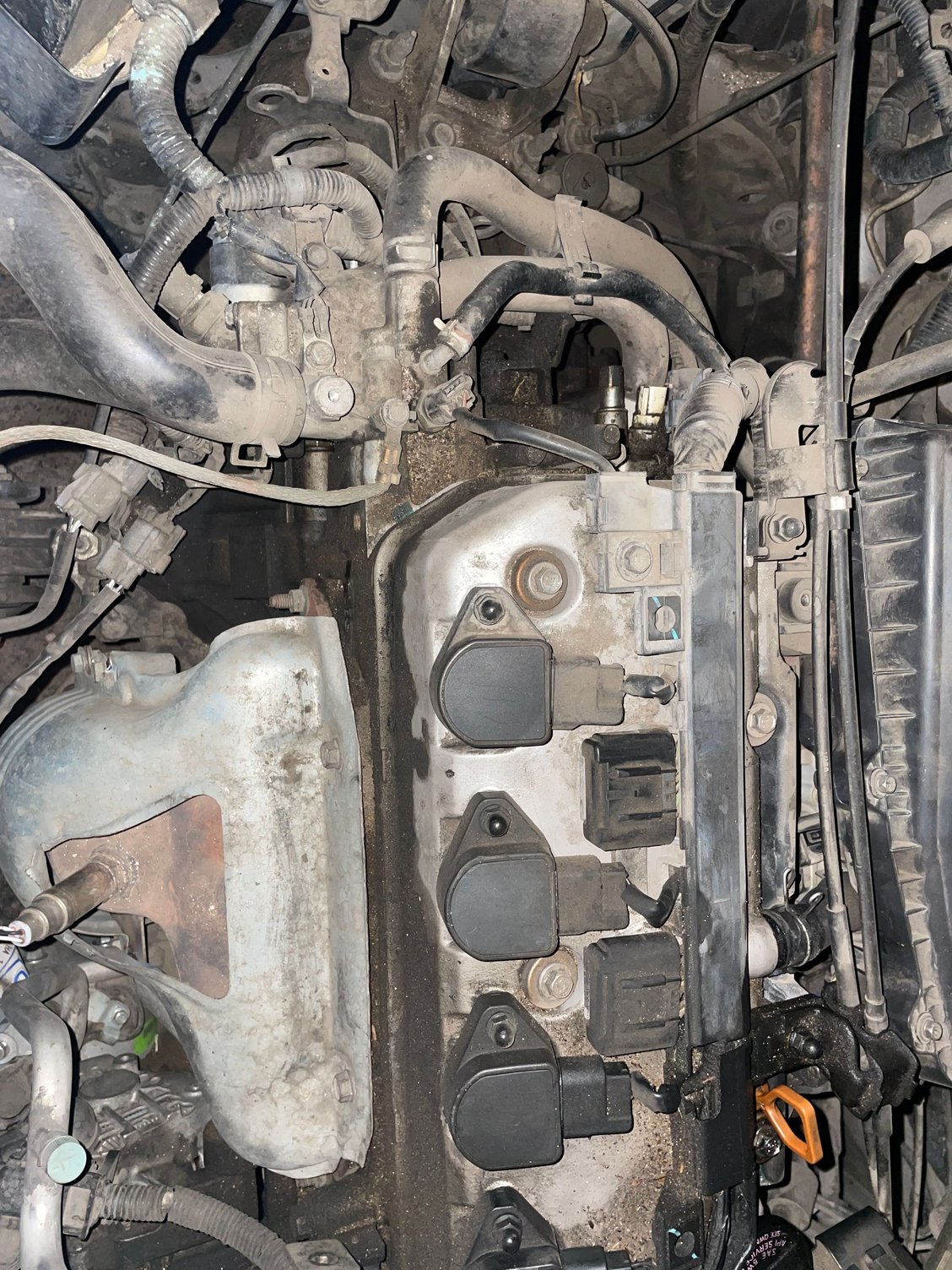

The O2 sensor placement on the exhaust mani screams D17A1 (non-VTEC). The D17A2 pre-cat sensor is located where the downpipe makes the 90-degree bend to route under the car. I'm guessing the engine has been "overhauled" with a D17A2 head, just because that was what was available. Assuming it is a D17A2 head, you can take advantage of VTEC by grabbing a VTEC controller, but the D17 VTEC isn't like the VTEC of previous generations where it was an obvious af increase in sound and power when VTEC kicks in, yo (I couldn't help it. lol).

or it is a D17A2 (VTEC) swapped in with D17A1 (non-VTEC) ECU (thus VTEC disconnected). Very common...
checking engine code would clear this

Re: What is this? It looks
Lol yeah I m an idiot.
So it looks like my engine has been swapped . Which make me extremely happy because I’ve want to do this but seeing as it’s already done. How do I get the vtech to work I se no plugs to plug it in and would I need a different ecu?
I’m reading that correctly right that code means it’s been swapped? Also I’m assuming that the 350000 miles on my OD isn’t gonna be correct. This being a different engine it probably has more or less miles.
