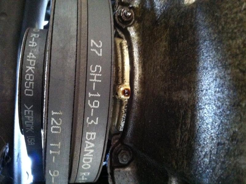

Hello, I have a 2000 Honda Civic EX with 233,xxx miles. Just got the rear main seal done not too long ago (2 months?) and it was done by a shop owned by a guy who only works on Hondas. The leaks I had before are completely gone and the under area of my car had been spotless. But yesterday my lower heater hose decided to split open and so as I was replacing that I noticed a new leak coming off my oil pan. When I looked past it, it seems to be coming from the pulleys? It's black liquid but its thin. My power steering fluid looks dark in the reservoir but on my finger it's clear with a light brown tint. My timing belt was changed along with the head gasket about 2 years ago. I don't know where the leak is coming from exactly. Any ideas? Also, the oil pan gasket was replaced but the guy I got to do that used gasket maker for that and it looks like crap.

Is it losing oil faster than you can add it? At that kind of mileage, I expect to see leaks. All rubber seals are suspect first.
Any leaks within the timing cover areas should end up coming out where you see the drip, which would mean getting the timing covers off to see where the leak starts. Cam seal, front crank seal, oil pump gaskets, valve cover? IDK.
Might be some of the oil pan seal job too, there's a mess all over the front. Hard to tell one from the other. Parts catalog shows a gasket for the pan.

I checked the color of the oil on the dip stick and its still pretty fresh looking. It's not black. So kinda confused about what I'm seeing on the bottom of the oil pan and around it. It doesn't appear to be leaking majorly. It isn't leaving spots on the ground yet. There are some lines of it leading from the belt area flowing down the bottom of the pan. I was thinking the drain plug was loose but its dry there.
I looked at the paperwork for the head gasket job and saw intake gaskets and some other stuff replaced but none of the seals you mentioned. Those wouldn't be included in the head gasket/timing belt job? Just asking cause I don't know much about that.
Is it easy to take the timing covers off? I have the factory service manual for it just don't know how hard it is to get a better look. I do eventually want to get a real gasket on the oil pan, I don't like the gasket stuff that's on there now.
The drip pictured in the first post was engine oil.
You not only have gravity working down there, there is also a lot of wind that blows stuff all over while you are at speed.
No, it isn't major yet.--- As long as the timing belt isn't getting wet.

I have never done more than replace hoses and tune ups on my car along with oil changes. That's it. I usually get mechanics to do the other stuff because i only have knowledge auto body. Also don't have many special tools or an air compressor at this moment so I think trying to find the leak under the timing covers might be beyond my experience.

Well, if most reputable shops would give a 12/12 warranty, you are beyond that. Looks like all the stuff I thought of was replaced, but that doesn't mean much now, at least not until the source of the leak is determined.
It's a small leak that doesn't leak fast enough to leave a puddle.
I guess you have to ask yourself, "Is it worth it?"
Can it wait until the next timing belt service?

You can pull the valve cover and the top timing cover pretty easy to inspect the timing belt, even if you can't get the rest of it apart to actually locate the leak.
I kinda doubt it has oil on it.
