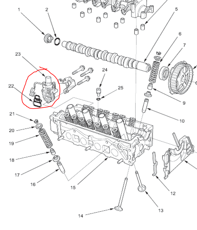

So I have been having some of the typical head gasket issues, but couldn’t find a leak, and the oil looks fine, and did an exhaust test and it came back fine. However I finally cleaned the engine good and found the leak. It appears to be coming from the left side of the cylinder head. I’m assuming this means new head gasket? Any other tests I should do to confirm, or is it for sure head gasket? I’ll post a picture of where the leak is. Oh and it’s a 2003 civic ex with the d17 a2.
Leak location on top and it’s running down the block/trans.
Leak location circles from further back. Can’t tell if it’s just oil or oil and coolant, looks like a mix

A bad head gasket usually causes exhaust gas to leak into the coolant, not an external leak. Is the coolant reservoir overfilled but the radiator low?
Your leak is most likely oil. On that side of the engine it could be the camshaft plug or VTEC solenoid.

Yes the coolant reservoir has been getting full but not going back into the reservoir. I have already changed the cam plug, but where is the vtec solenoid?
