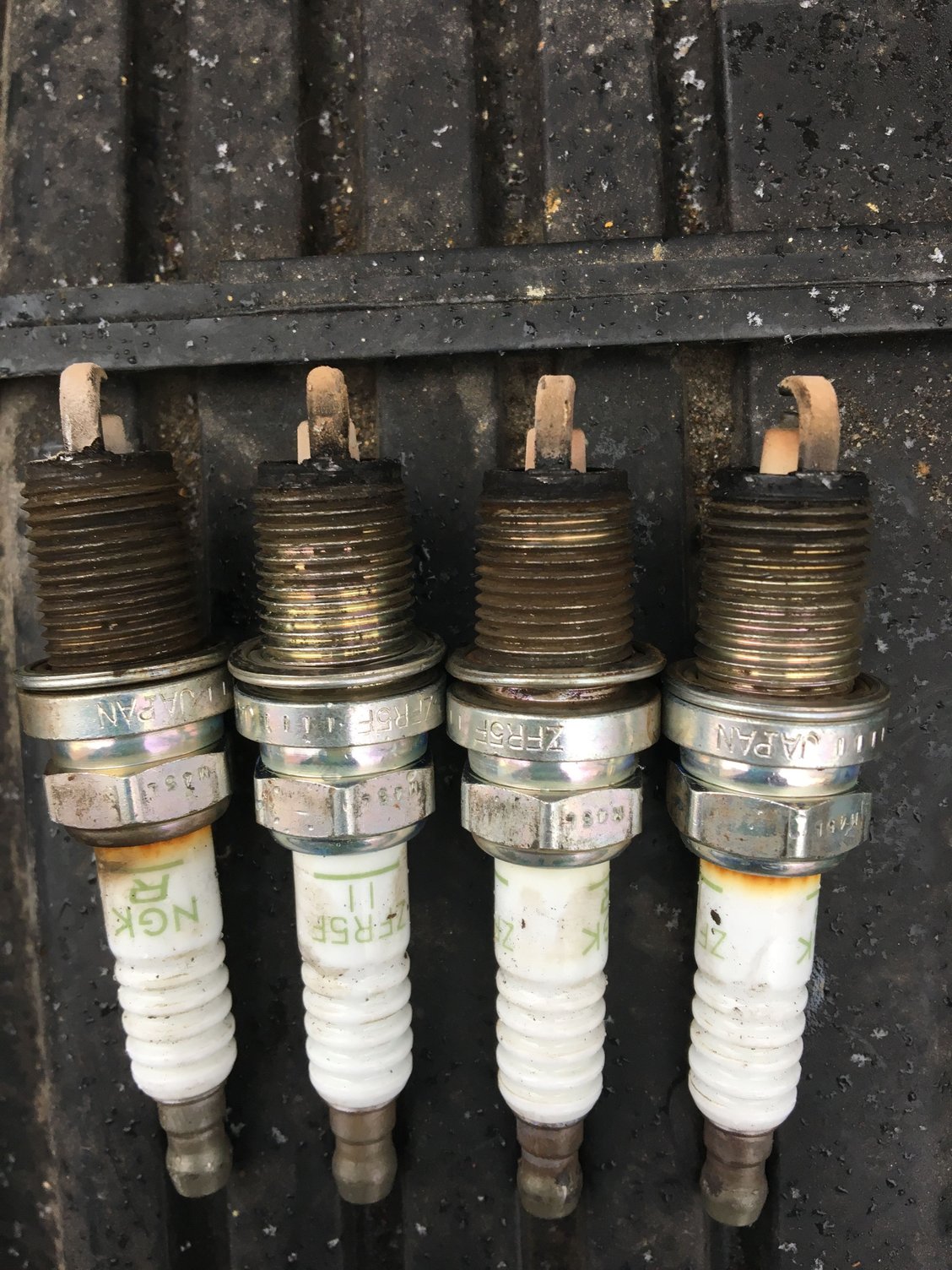

I have a 2000 Civic EX - D16y8 - 240,000 miles.
It has always leaked a little oil. recently it got much worse, like all over the ground worse. I replaced the distributor seals as well as the oil pressure sender and oil filter. As the oil leak is all over the back of the block i assumed it was the common oil sender leak. Unfortunately next morning, oil all over the ground. I ordered a reman head and all gaskets. Not yet installed. I know it is not common but i believe it is leaking from the head gasket. Is this possible?
What doesn't make much sense to me is the significant exhaust smoke. The longer it sits the worse the smoking. overnight will be worse than a few hours. Smoke is white but does not smell like coolant, and plug condition suggests (to me anyway) that its not a coolant burn.
I did an ice cold compression test - 150 high - 140 low. I know this is low, but its a cheap compression tester on a cold engine. I was more checking for variation rather than actual high number.
Im hoping that I've covered all my bases with the reman head and gaskets. Does it sound like I'm going in the right direction? Anything else i should look at/replace while i have it apart?
i guess there could maybe be a crack in the block, but no visible evidence and engine has never even been close to too hot.
Video of smoking, and photos of plugs included.
