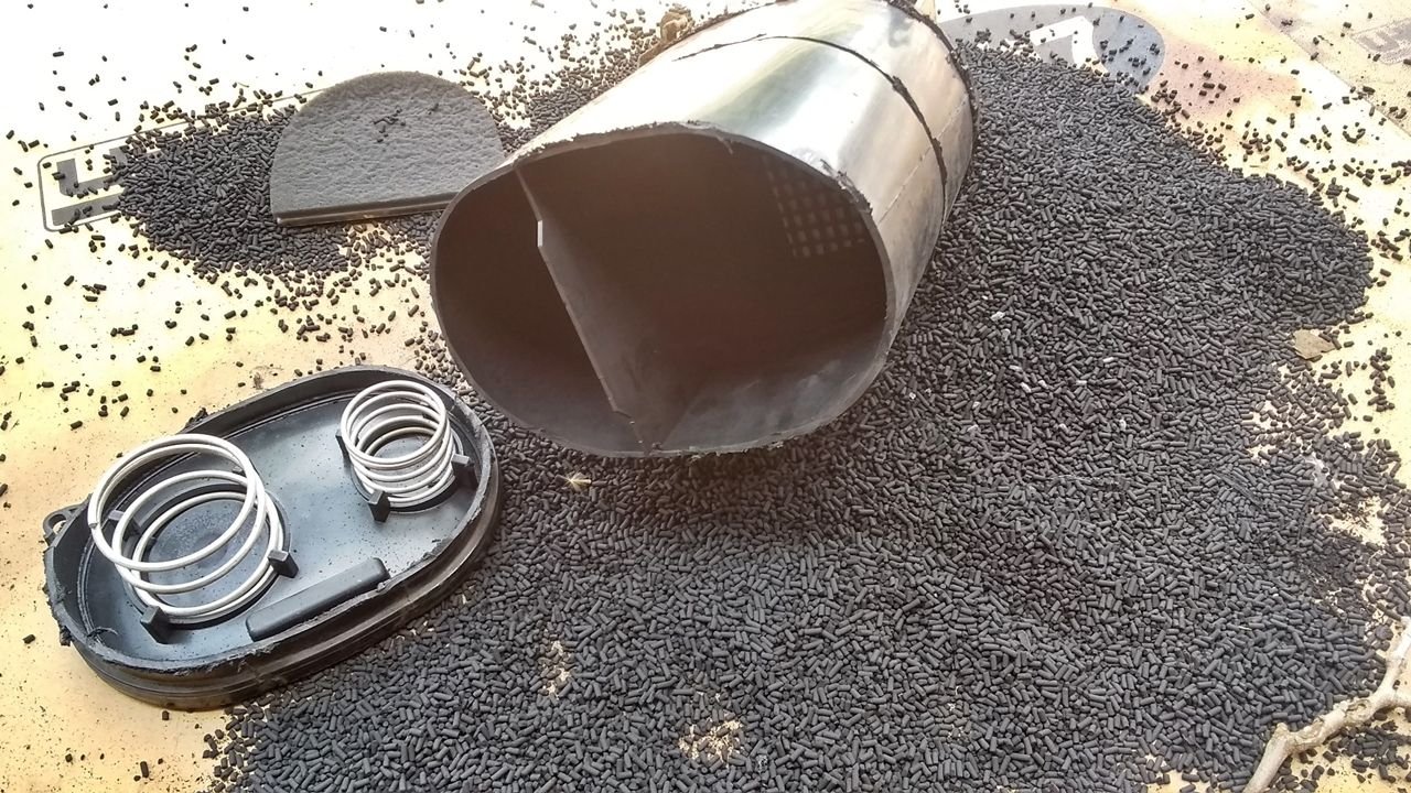

Here's what the new one looks like:
Identical except for being much lighter, which surprised me. All the charcoal in the one above was damp, but not wet. There was even some sort of mold buried in the middle of it. I'd say about the consistency of mouse poop, since I'm sure you handle that all the time! Really how would you know what the system is using to determine the position of the valves though? You just don't want to replace it because it's $100+ even shopping around on eBay. Do you? None of the ones I used are OEM, but the EVAP code is gone.
There's one 12mm bolt holding the canister on. I have no idea how you'd ever get to it without lifting the car up, but the hoses were easy enough except for the very top one, which was a quick-connect style. The filter is probably not worth replacing in a lot of cases; there's obviously a bypass installed even if the filter looks unused (which mine did). All the screws/bolts were completely rusted. A couple cents for a pack; you'll pay more for the shipping than the actual part.

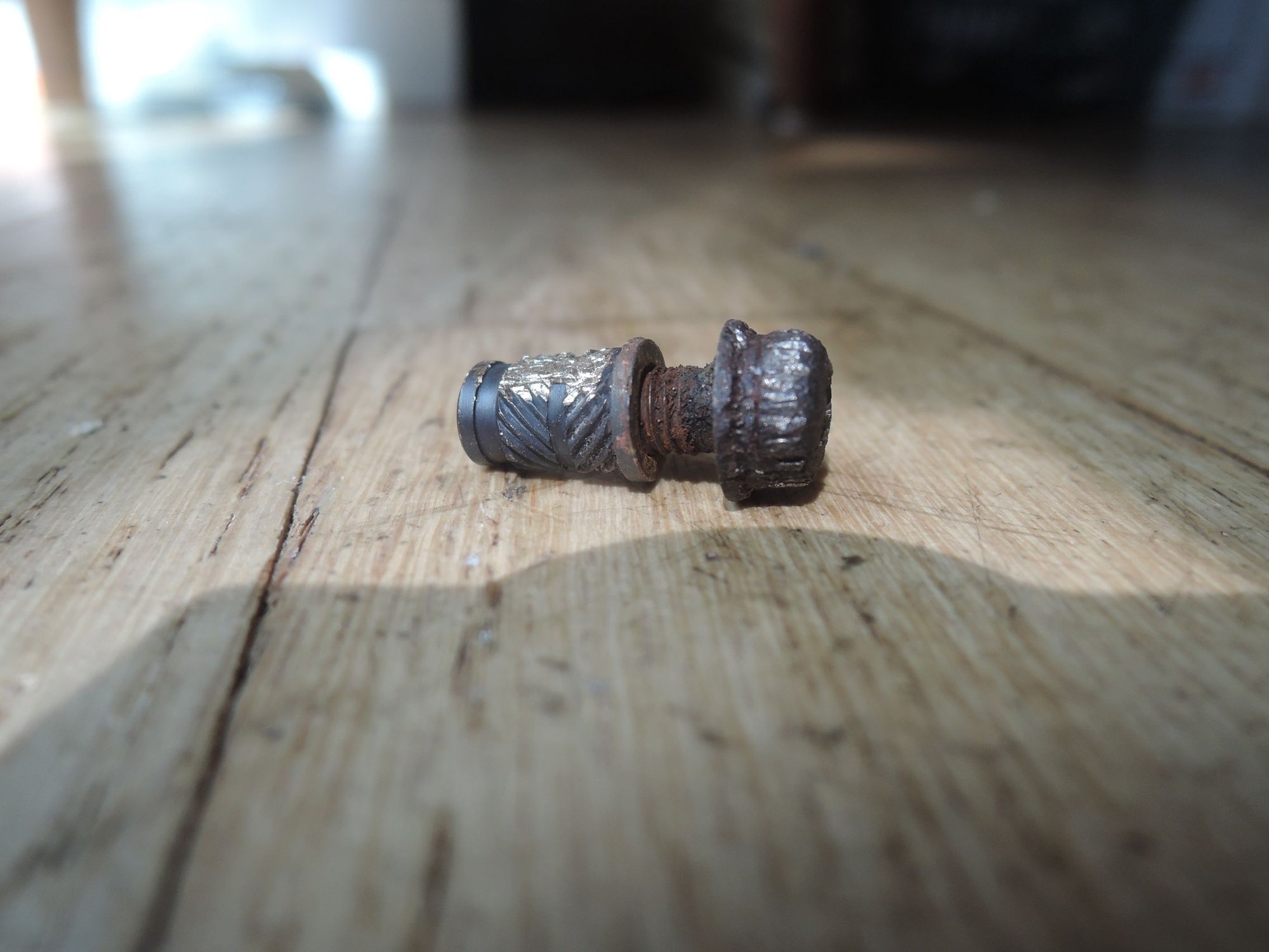

Re: How to troubleshoot a P0497 and P1457 EVAP code?
from my 02 civic... P1457 code. I replaced the valve, not the whole box. The screws were really rusted out, and like you, the "nut" part of it came out of the cannister. I was able to reuse the
"nut" part, tapped them back into the cannister, and they held tight when I put new screws in. But, P1457 came back on after I reset the code, so I'm suspicious those "nuts" may be causing
the leak. I ordered some RTV and I'll reseat them and try again. If that doesn't work, I will replace the valve at the throttle body.

Originally Posted by jbh3
so I'm suspicious those "nuts" may be causing the leak.
I would be surprised. One canister shut valve I replaced I had to cut the head off both rusty screws. To hold the new valve in place I smothered the bolt/flange area in JB weld and ran a zip tie all the way around the canister. Hasn't leaked yet.
P1457 is a pain to troubleshoot mainly because there are no instructions in the service manual available on this site. I can try to provide some actual troubleshooting steps if you would like. You would need a vacuum pump/gauge and some basic electrical tools.
