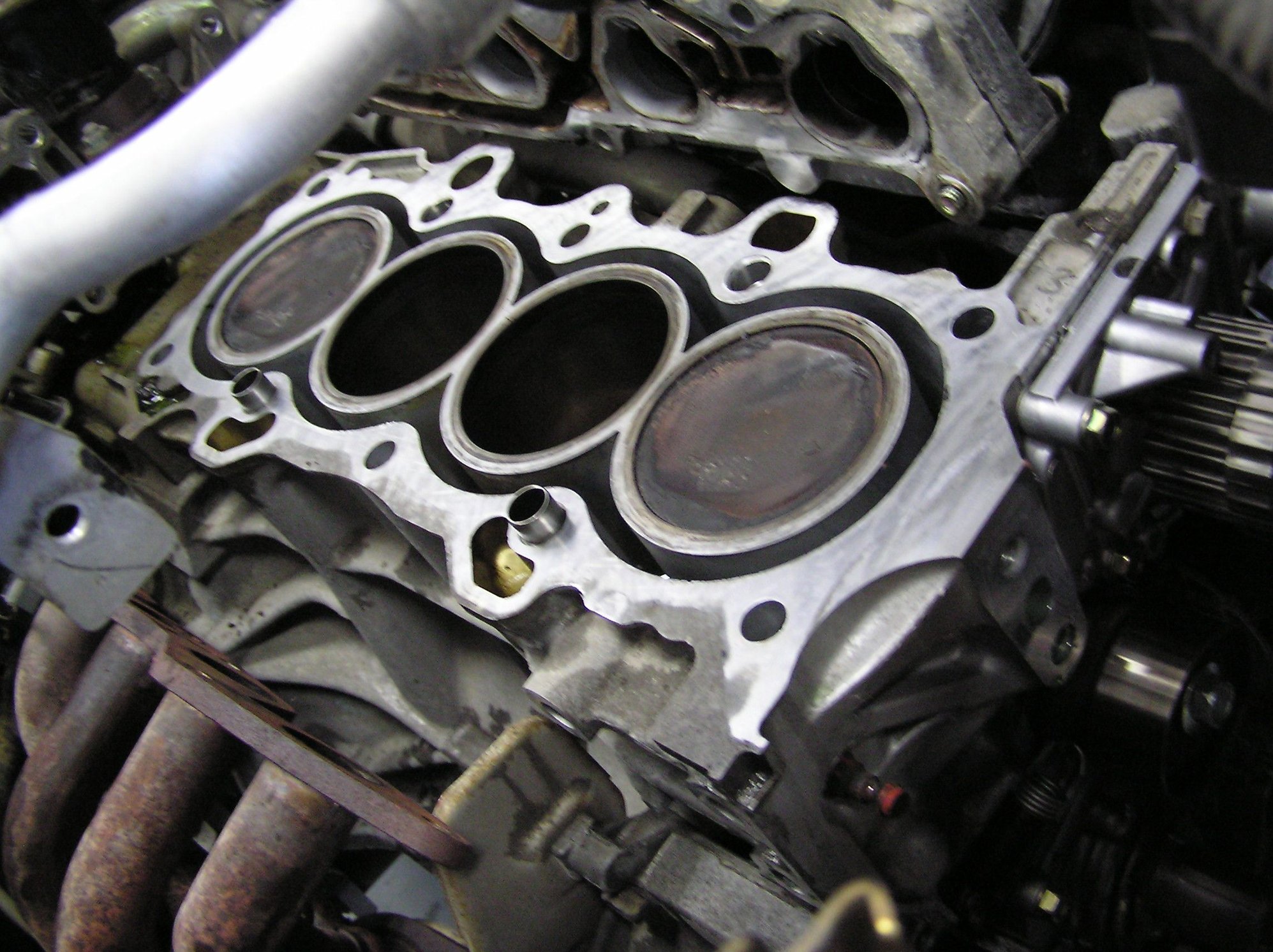

This pic should show why the head gasket cannot leak oil at the rear of the engine....there is only the water jacket (coolant) in that area.
The 4 odd shaped ports are oil returns to the pan, the only pressurized oil passage is the small hole located between the center cylinders on the intake side of the block
EGR cannot leak oil either, but it needs removed to make room to replace that plastic cam plug.

Ezone, I always wondered about that, why our cars cant leak oil from head gasket, at least at that area. But, I just tried a test which was not mentioned here, to pop off the radiator coolant reservoir overflow, and poured out the brownish looking coolant. Guess what I found? Oil in the coolant! First, before pouring it out, I shook it a bit to "mix it up", to kind of homogenize it, then poured it in a glass beaker. After just 2-3 minutes the green coolant and brown oil separated!
I could put up a pic, but not sure why necessary. Shouldnt we now conclude that this is scientific evidence that the head gasket is leaking the oil? What else could do this, I mean? I mean, yeah, I could do the baby powder test for the heck of it, not hard to do, but we got oil in the coolant.

Shouldnt we now conclude that this is scientific evidence that the head gasket is leaking the oil?t.
i wouldnt say its 100% conclusive,
its possible somebody at some point in time poured another substance (other then coolant) into your rad or overflow
OK, good point, although maybe remote. Then I guess I will proceed to do the baby powder test.
Ezone, any way you can draw say, red arrows to those 4 oil ports? I think I understand where they are, but want to be 100%. Just took another hard look back there with tiny light and seems theres just a tiny bit of oil around the solenoidn dont think thats the cause of the new pool of oil. Yes, its pooling as we speak.
