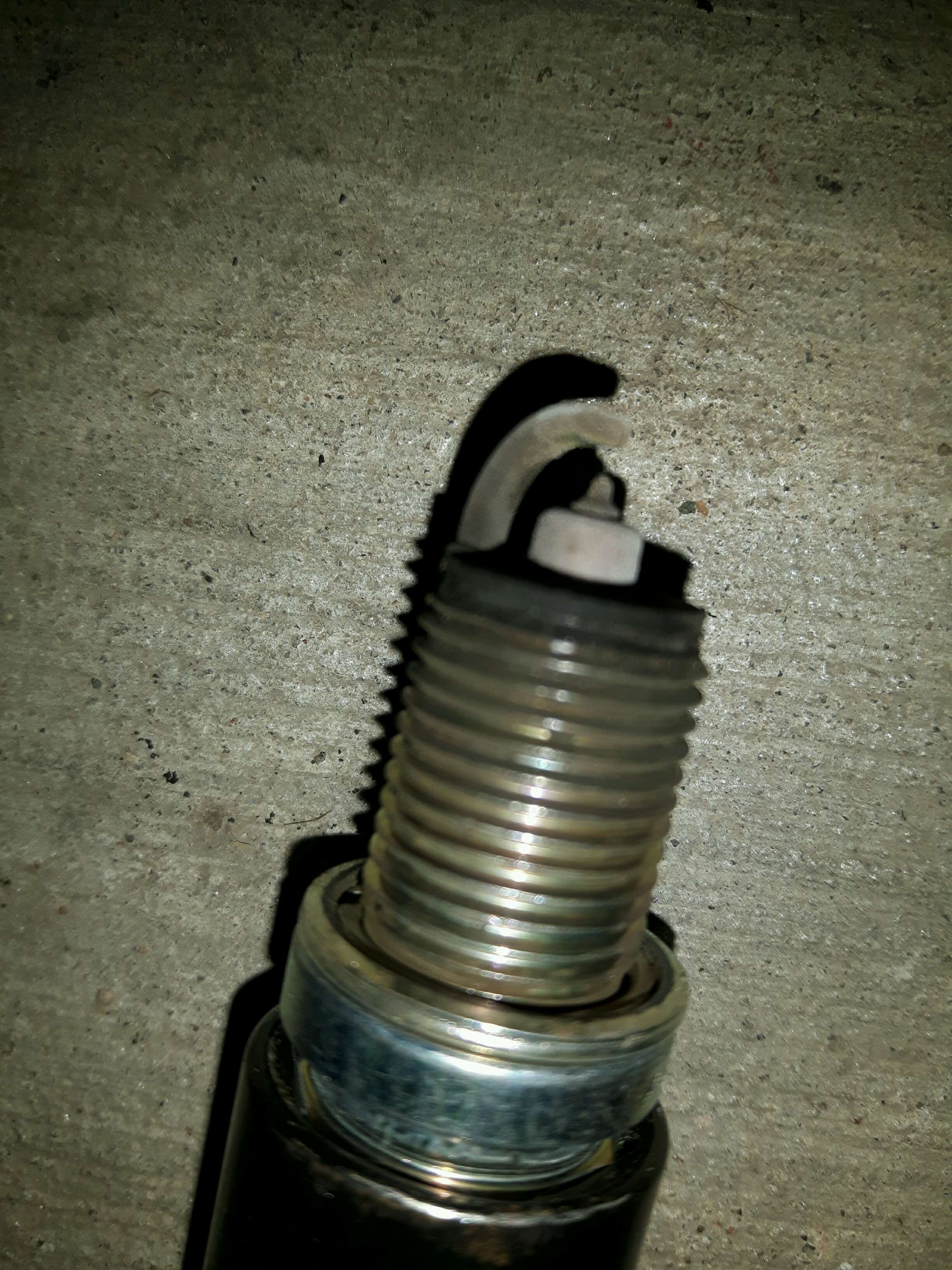

- Plugs are dry

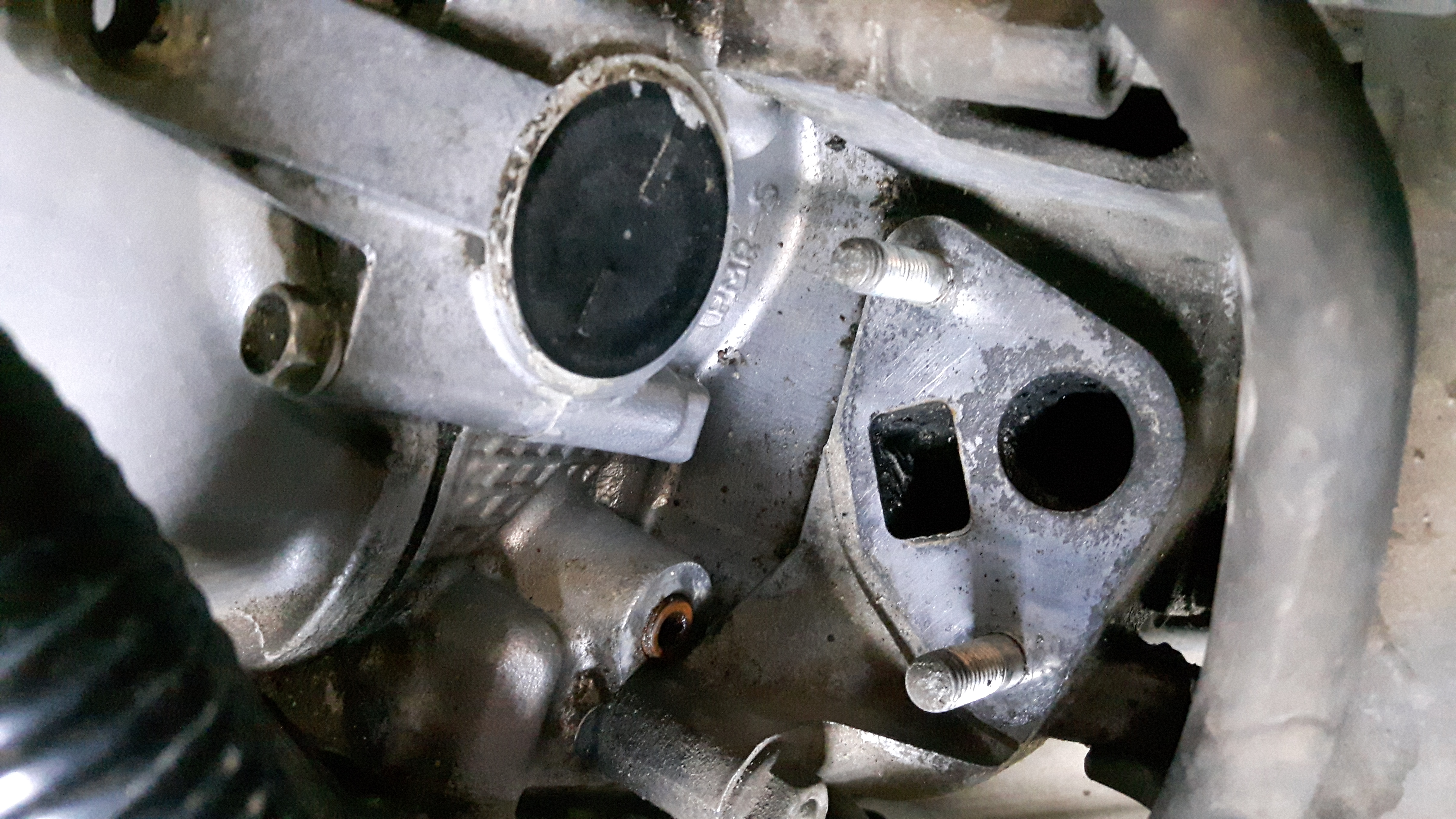

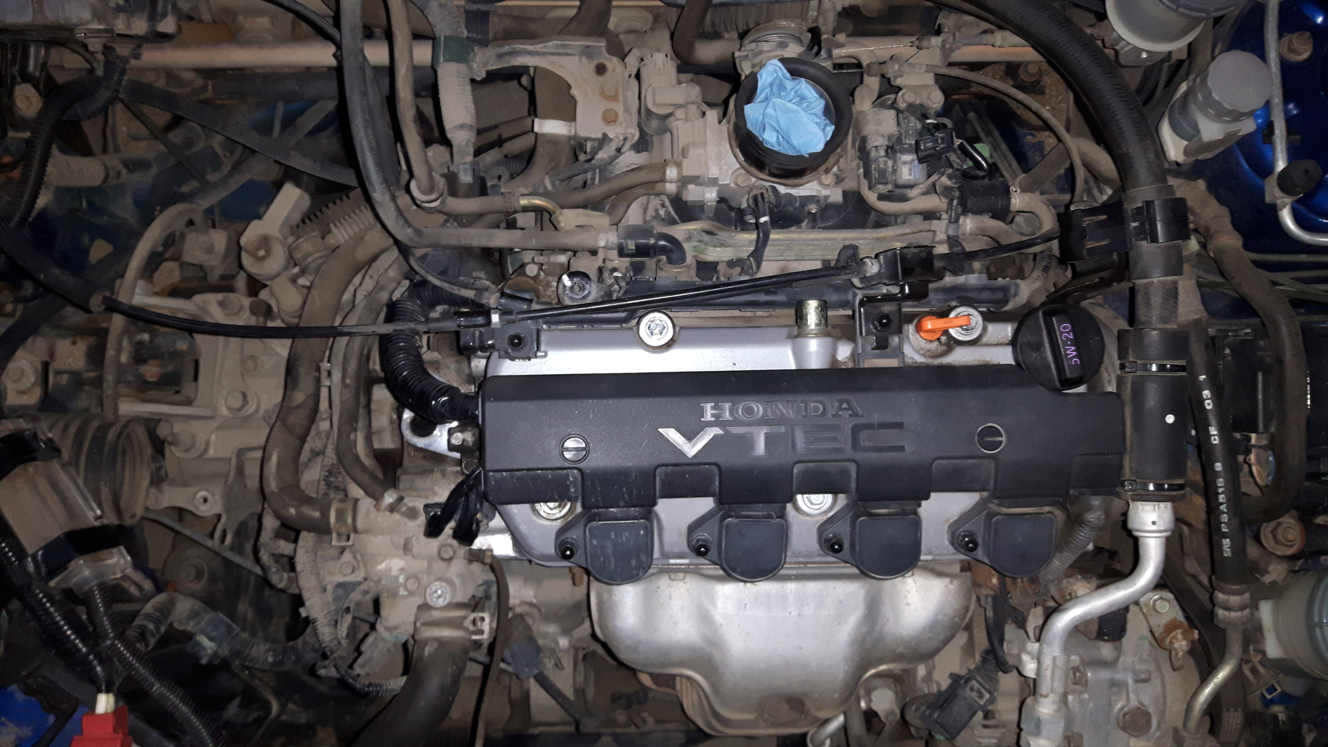

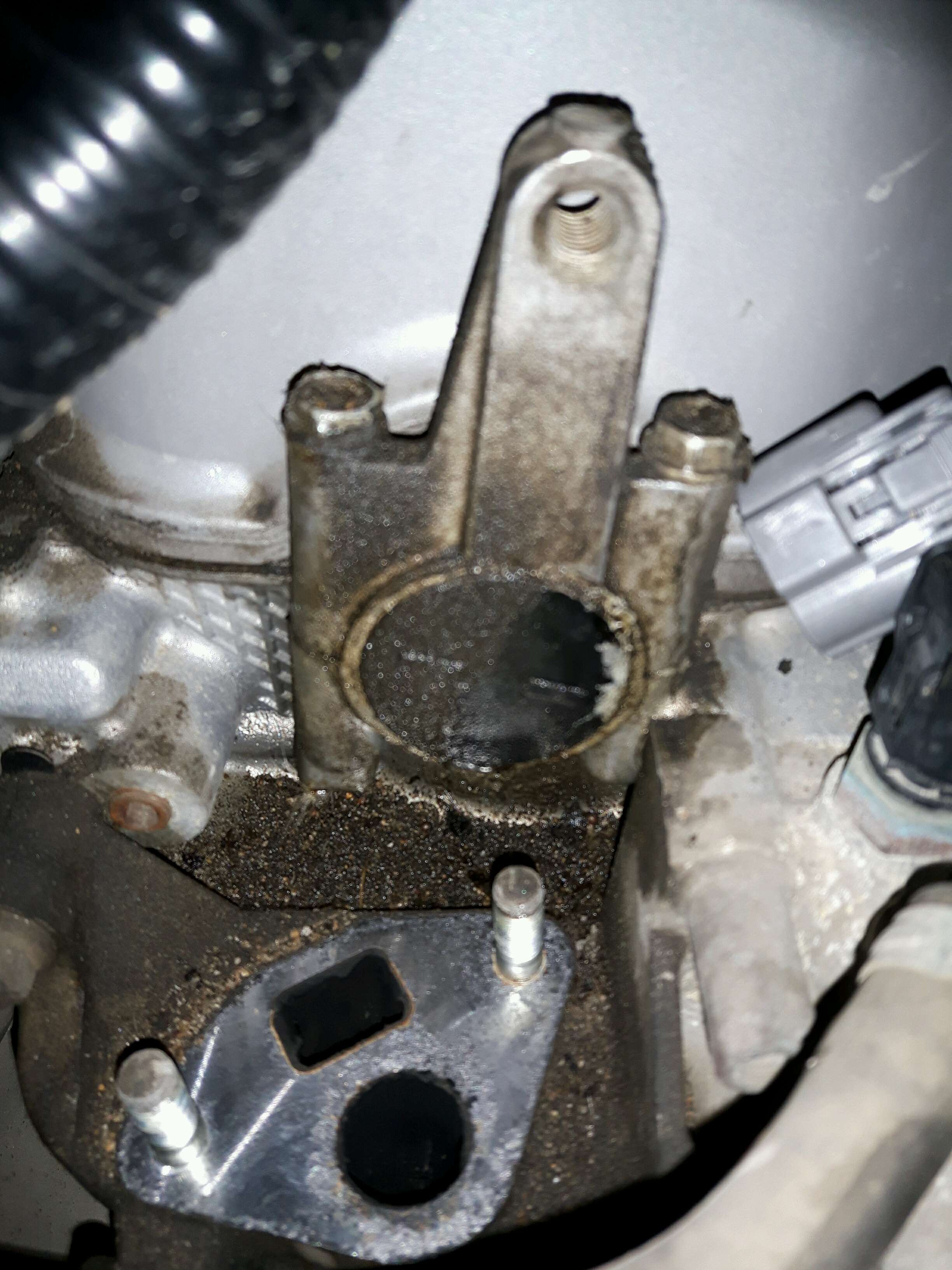

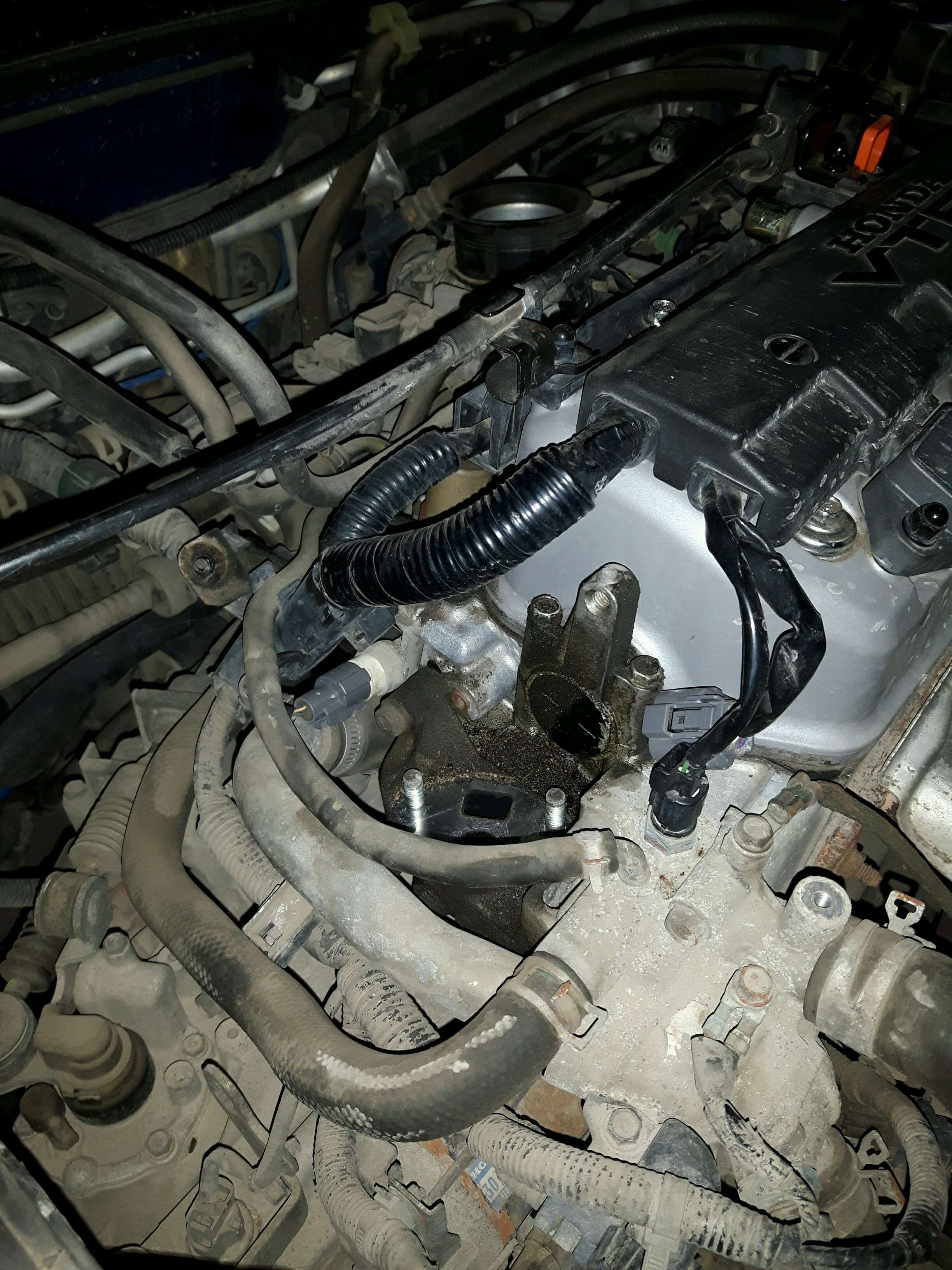

I took a few pics today as I got the car ready for winter. The engine is a bit dirty after the first snowfall right now, but there is no signs of oil anywhere. EXCEPT just under the cam seal near the EGR. My theory right now is that oil is leaking out of the seal, staying in the pocket beneath the EGR, and burning off from engine heat.
Thoughts? Any other ideas? I haven't yet run a recent compression check, but I may give it a go.
I have attached a few pics.

Cam plug leaks, replace the plastic plug.

Wouldn't you expect to see obvious signs of oil burning on the spark plugs and exhaust?
