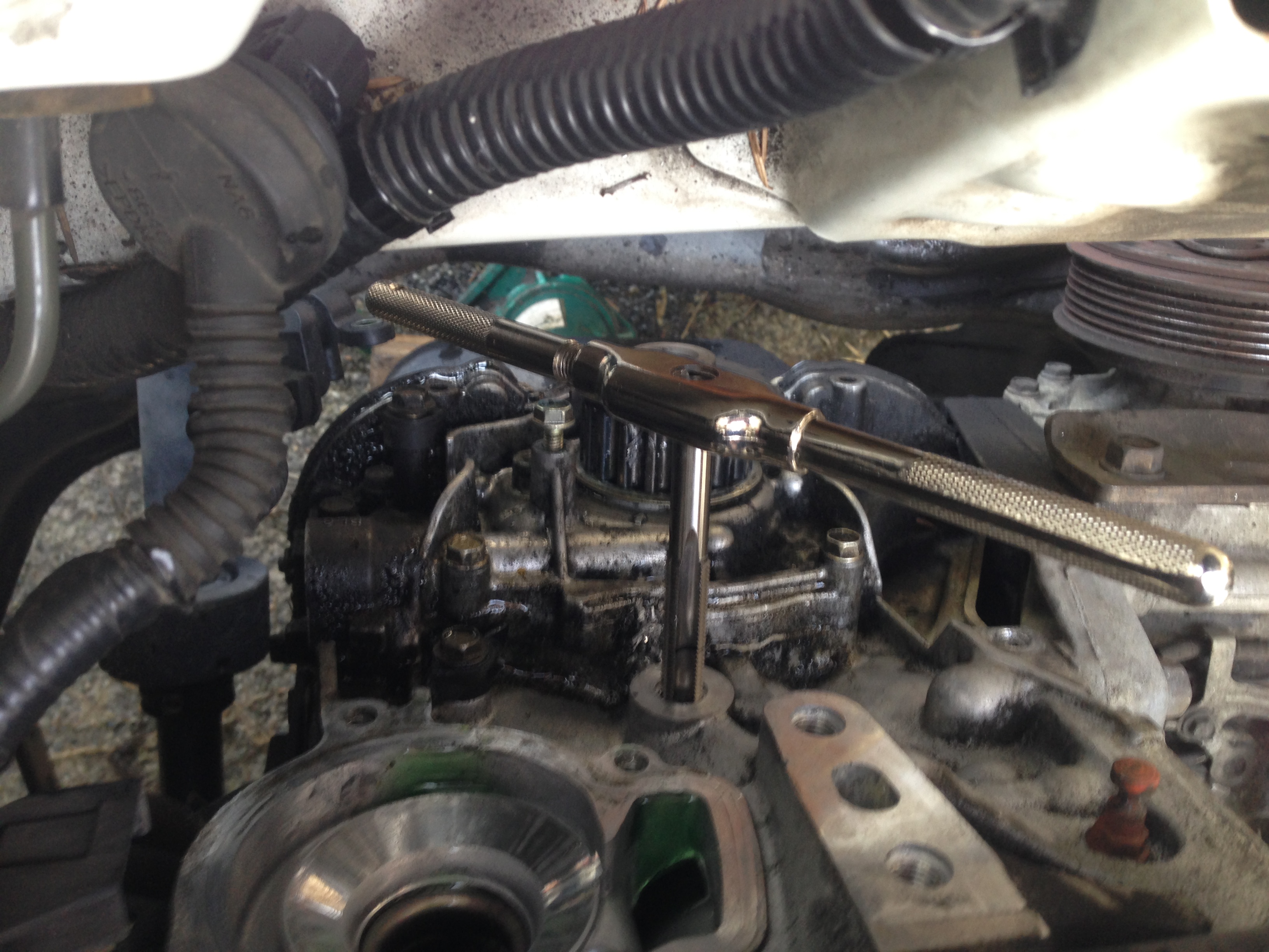

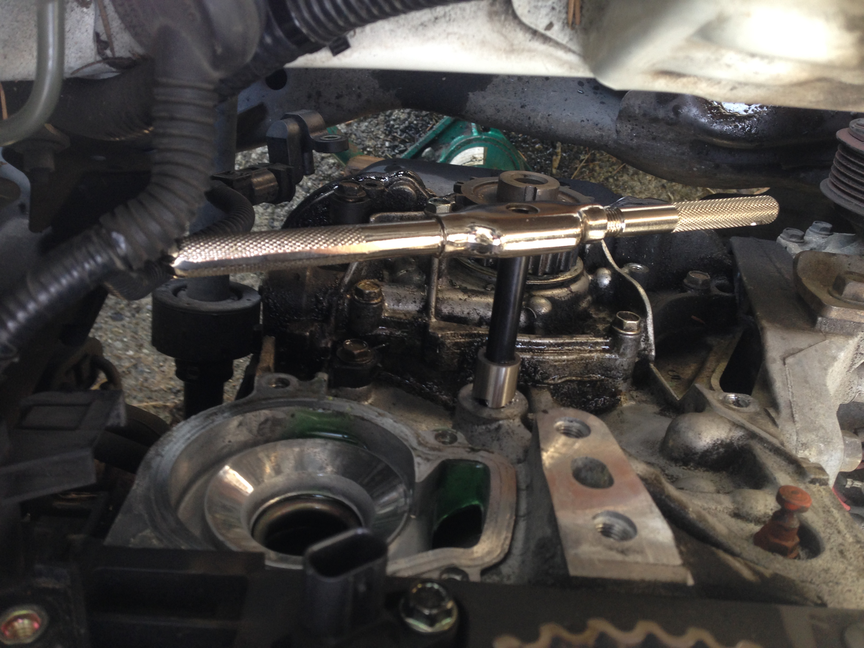

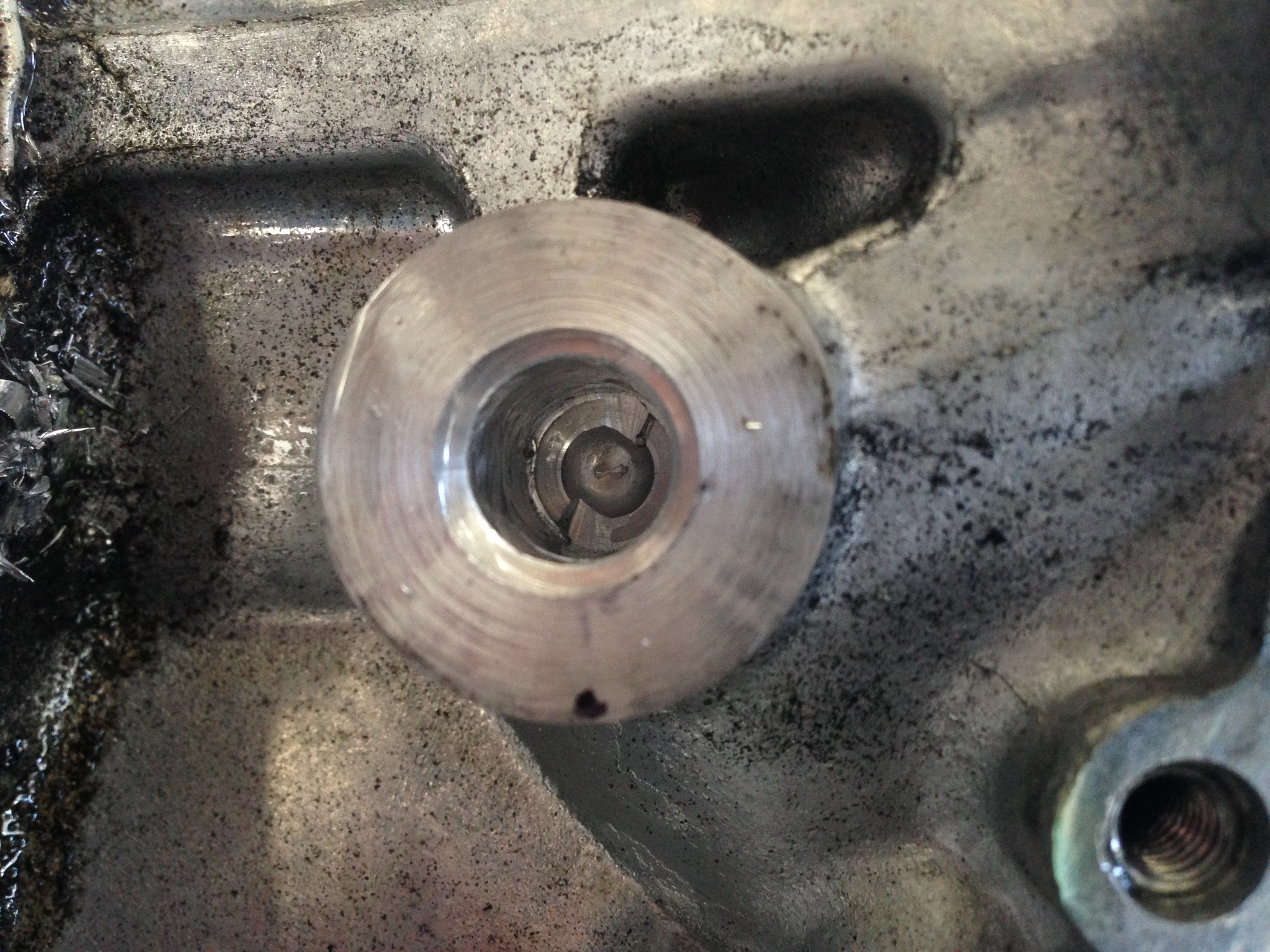

So I use the time sert. It was pretty easy to install. Since the drill bit only removes the old thread, it is really easy to drill by hand. You want to be very careful when tapping because if it is crooked you will be in trouble. I did not use the tap guide because it did not come with the kit and I did not wanted to wait another week to get the guide. I used WD40 for drilling and tapping and motor oil from the car for driving the insert (I talked with technical support from time sert and I was told that d40 was good enough and that any motor oil would do). Anyway, tomorrow I will get the new bolt and I will start putting things together. I hope this helps someone!
