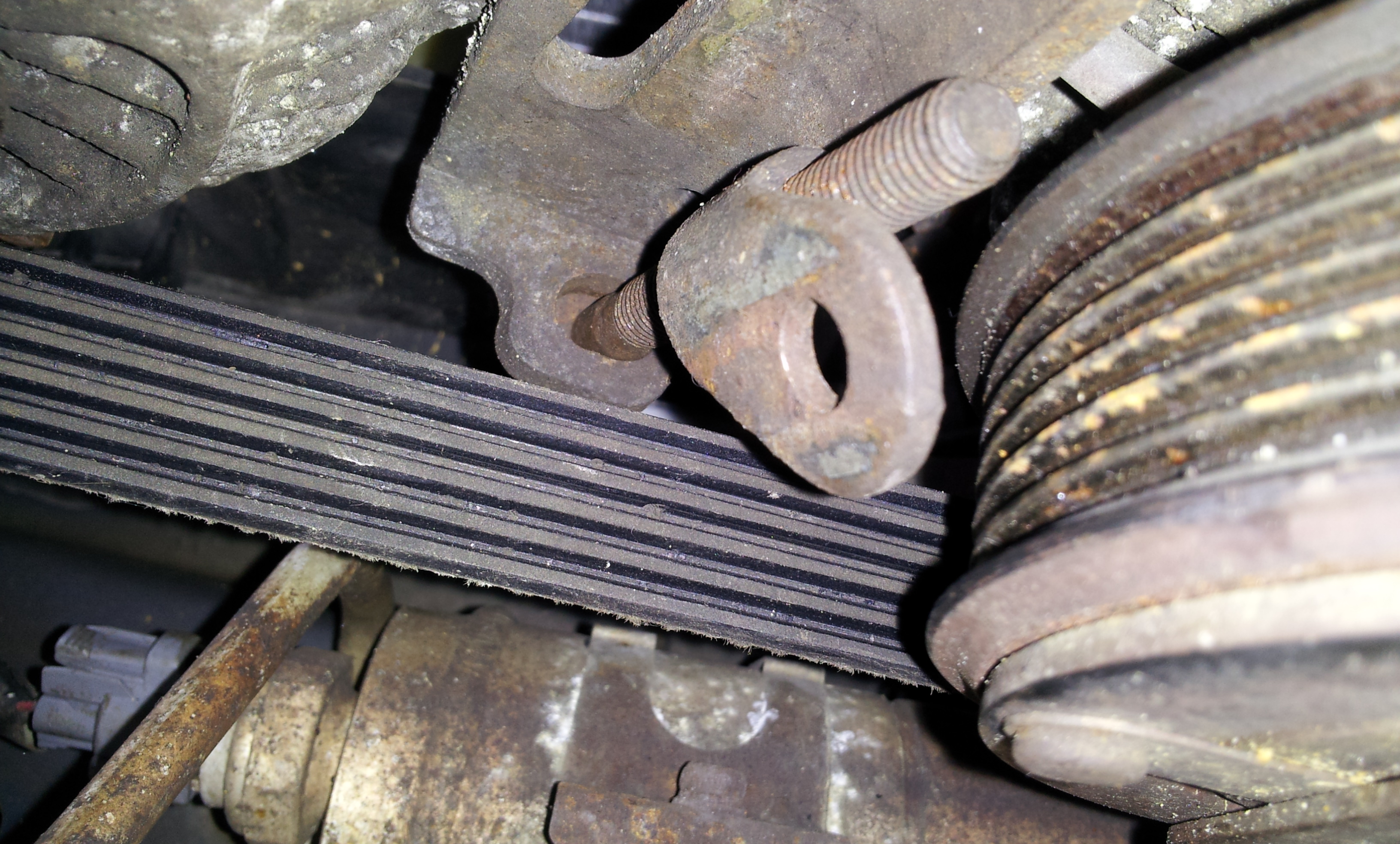

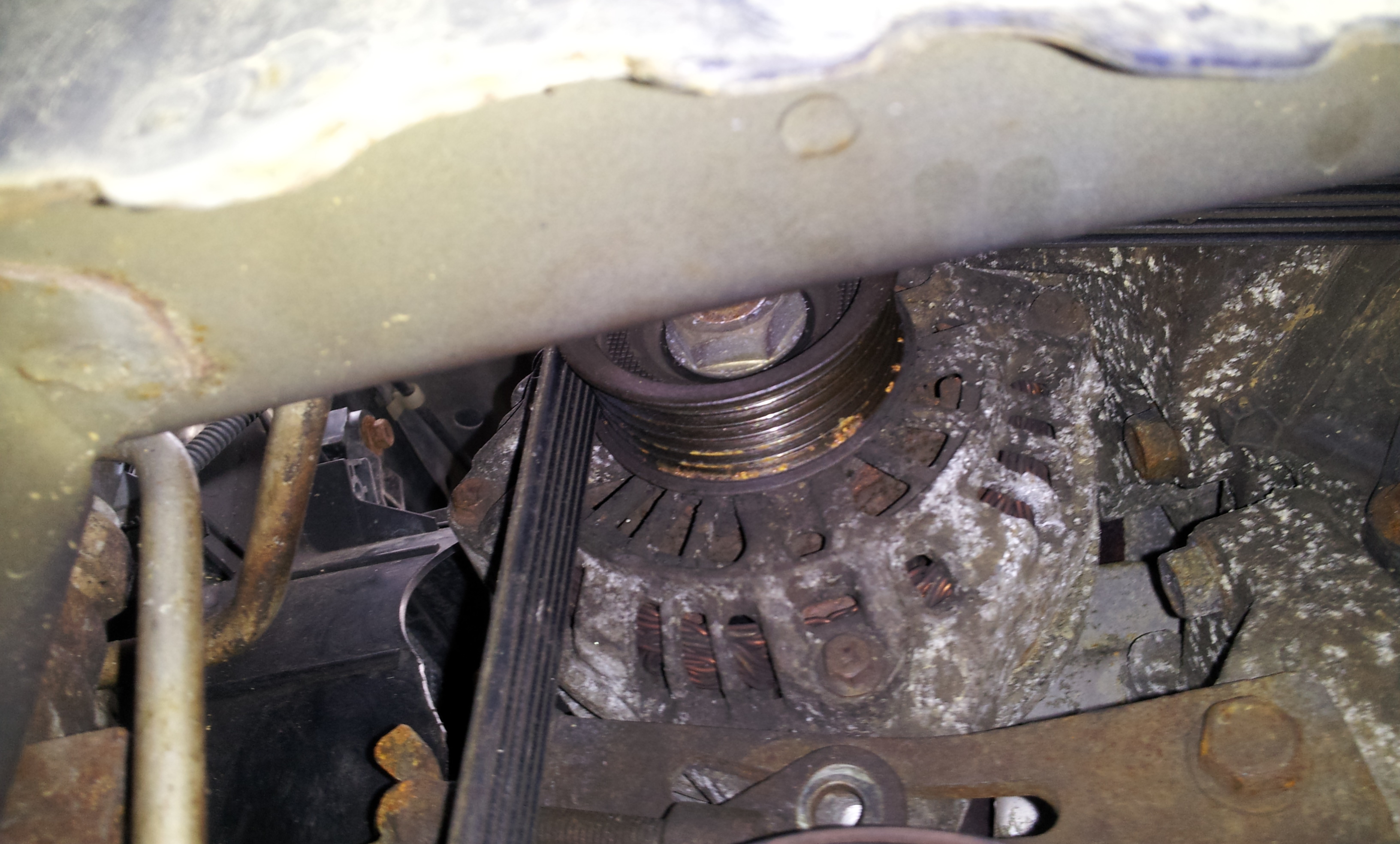

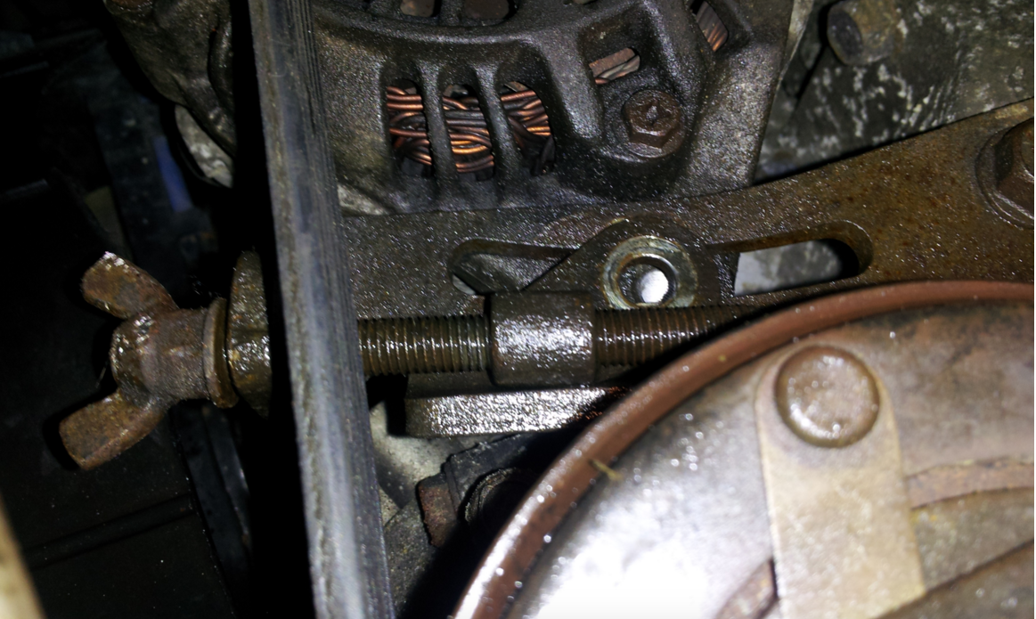

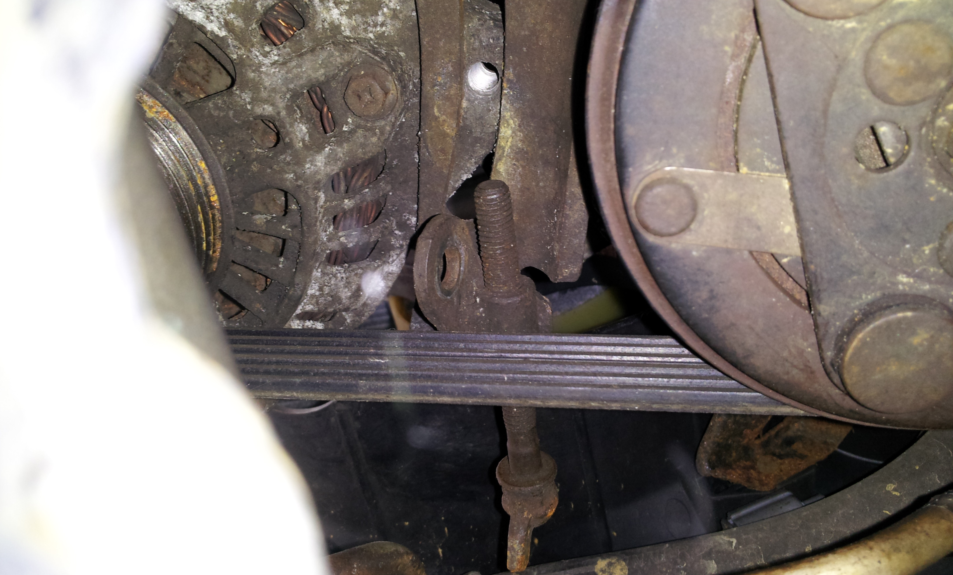

How to progress with tricky wingut, rust problems and belts
I've attached some picture here to illustrate my situation. I've been taking a few breaks from this project due to school. Not sure what I should do here. What happened was my car was making a lot of squealing noises so I figured either the belts or the tension, or both were off. I bought some belts on amazon. Watched a few tutorials on youtube about installing the belts.
I particularly followed the directions here:
http://www.justanswer.com/honda/1k3f...nda-civic.html
Going off of that tutorial link, I loosened the mounting bolt on the top of the alternator which seemed to lower and shift things about. Then took off the lock bolt that held in the adjusting wingnut bracket which is connected to the overall bracket screwed onto the engine. However, I did not do step 'D' which said to loosen the mounting bolt, wasn't sure why that was needed. After step 'C' the holes of the wingnut bracket and the hole where the lock bolt went (alternator hole) were are now askew and not able to put that bolt back in there. So now that wingnut and its bracket dangle there (as pictured). And the worst part here is that the adjusting wingnut and the bracket at the end will not come off or unloosen at all. The bracket connected to the adjusting wingnut is rusted on there badly, this is my main problem, I don't know how to get it off. Is there any recommendations for getting that bracket off, maybe some heavy duty rust remover, candle wax trick or any ideas for getting the bracket off. I think if I could just get that bracket off the adjusting wingnut bolt I would be ok to finish the rest of the job. I've taken the power steering belt off. I took a break from this project for about a month after doing the aforementioned. Today I took a look into the engine bay and found rust on the pulleys, as pictured. When I removed the belts it was left to the elements, which I agree was quite idiotic. What should I do about this rust on the pulleys at this point? Once I get passed this issue with the bracket and wingnut I know it cannot be safe putting new belts on there with rust all over the pulleys. Basically, all my problems boil down to rust and rust related issues.
Here are the pictures. Any and all help are gladly appreciated,
Thank you,
my best

Old Mar 16, 2016
MassCivic's Avatar
Joined: Dec 2014
Posts: 119
From: New England
MassCivic is an unknown quantity at this point
Re: How to progress with tricky wingut, rust problems and belts
There should only be one bolt holding the alt adjusting bracket to the engine, toward the rear.
Take this bolt out and remove the whole bracket so you can soak it in pb blaster and put it in a vice to work the wingnut bolt out.
Upon further inspection it's the bolt in the bottom right of the last pic you attached.

Old Mar 16, 2016
Re: How to get bolt off from the engine?
You've been scared to take the wheel off and get after it?
Man up, rip the wheel off and DO WORK SON! (LOL)
Pull the splash panel back and the whole thing will be hanging out in front of God and everybody
Remove one bolt. Bracket comes off in your hands.
Carry to workbench, clamp in vise
If pliers won't get it to move then USE FIRE to get the wingbolt free from its threaded thingamabob.
Also...please keep all the posts about the same problems in the same thread. Thanks.
