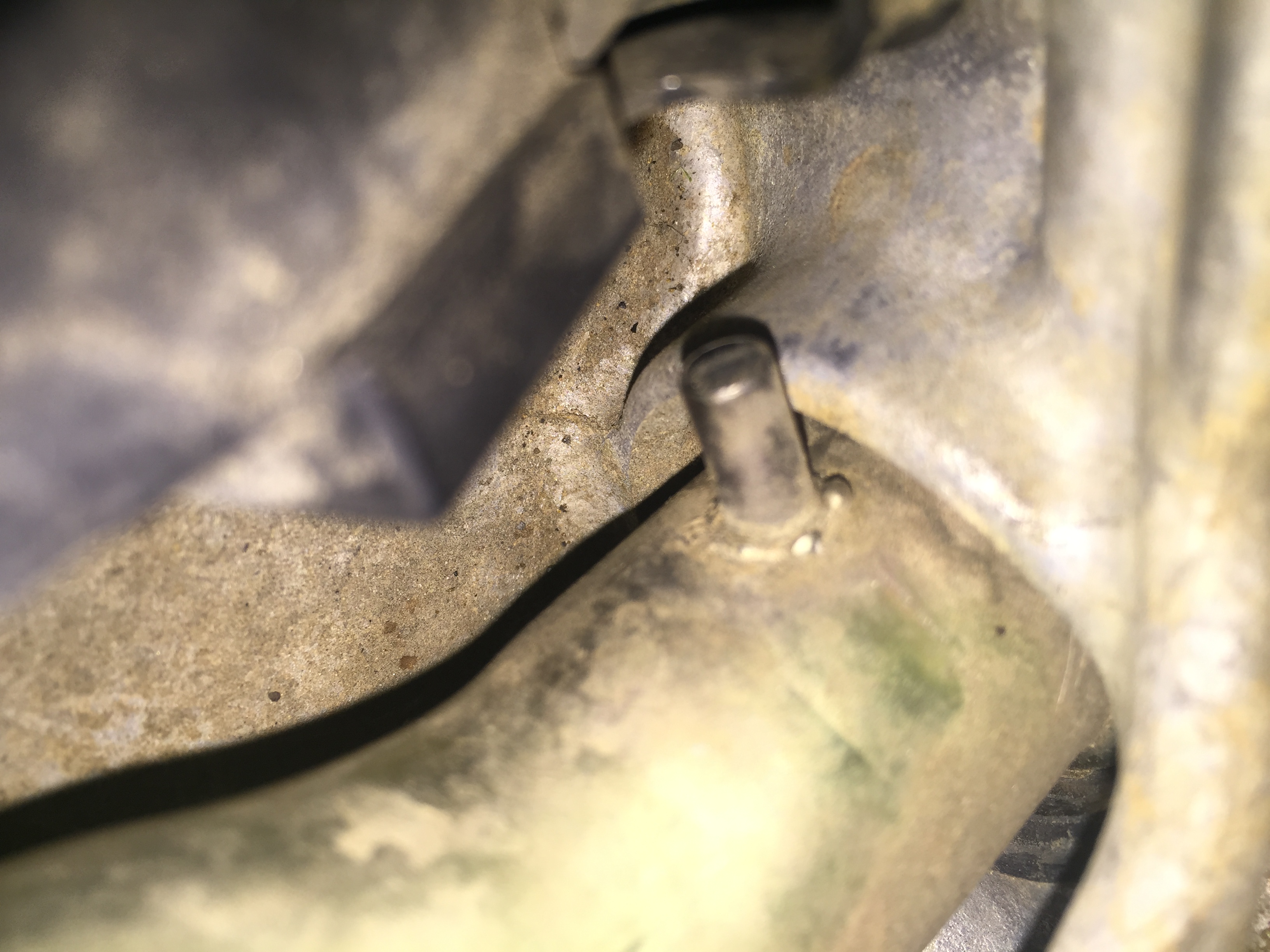

Still trying to figure out how to get that water pipe off.
I got a new head gasket kit, and I think it may have come with a flange for the water pipe / pump.
Here are the pics of the back side and the water pump side of the pipe. Just can't figure out where it is stuck.

Old Jul 4, 2015
Re: Heater core replacement instructions
I think it should be an O ring, and you don't HAVE to try to use all the seals and whatnot in a gasket set if you don't really need them to get the job done.
Did you get the bolts out, is the pipe now loose enough to wiggle??
If you are down to having it stuck in the back of the water pump, spray something (silicone?) in between the pipe and casting to get the O ring wet and lubed. Use the welded peg on top of the pipe, place a screwdriver (or something to act as a wedge) between it and the casting and gently pull the pipe upward, then move the screwdriver and repeat to work it outward slowly while wiggling.

Awesome Ezone, will do. Yes it is loose and I can wiggle it. Haven't tried applying any force yet.
