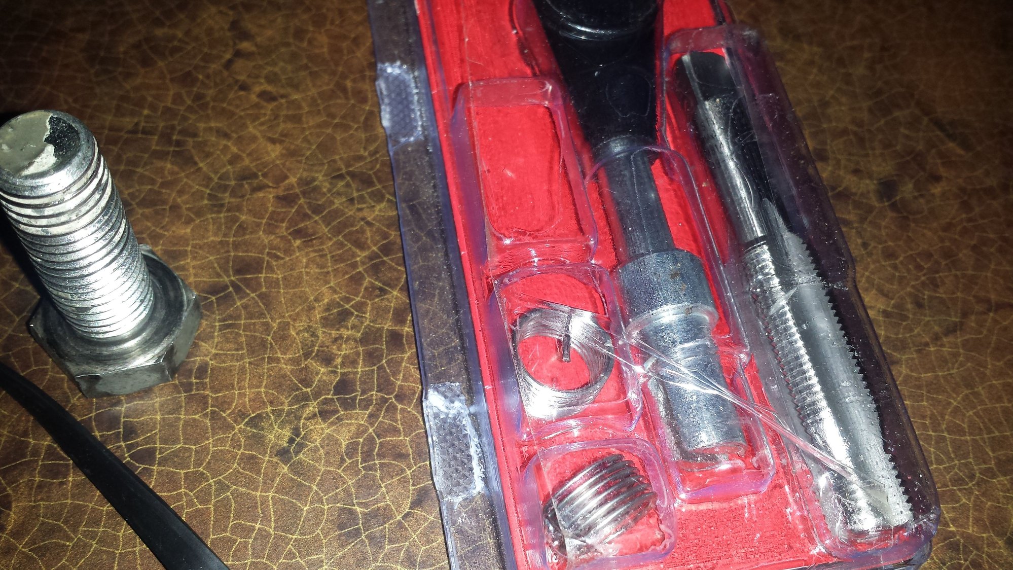

previous owner used wrong crank bolt..
now the crank threads are shot.... any suggestions ? anything that can actually hold 140 pound of torque?

he used a course thread bolt and messed up all the treads in the crank... the oem bolt catches alittle but cannot torque down.

oem size is.. im wondering if i just tap it and get a bigger bolt if it will be okM14 x 1.25

will helicoils hold 148 foot pounds?

Re: previous owner used wrong crank bolt..
stupid question but....will the same bolt work again?....even if its the wrong one?
tapping or helicoil will probably break or crack the crank, however at this point i guess you dont have much to lose,
my only other thought without having to replace the crank would be to have a shop weld it on there, but im not even sure thats possible, and you would be hard pressed to ever get it off again,

supposibly helicoils give a fastener a better bite on the metal.. so i really have no choice but to try it.... i have another crank..but thats more risky to swap crank...or is it a matter of just put rod ends and carrier caps to torque specs and reasemble?

just as an FYI....... the heli-coil worked out perfect.. about 153 torque on it and so far so good...many speed-runs
