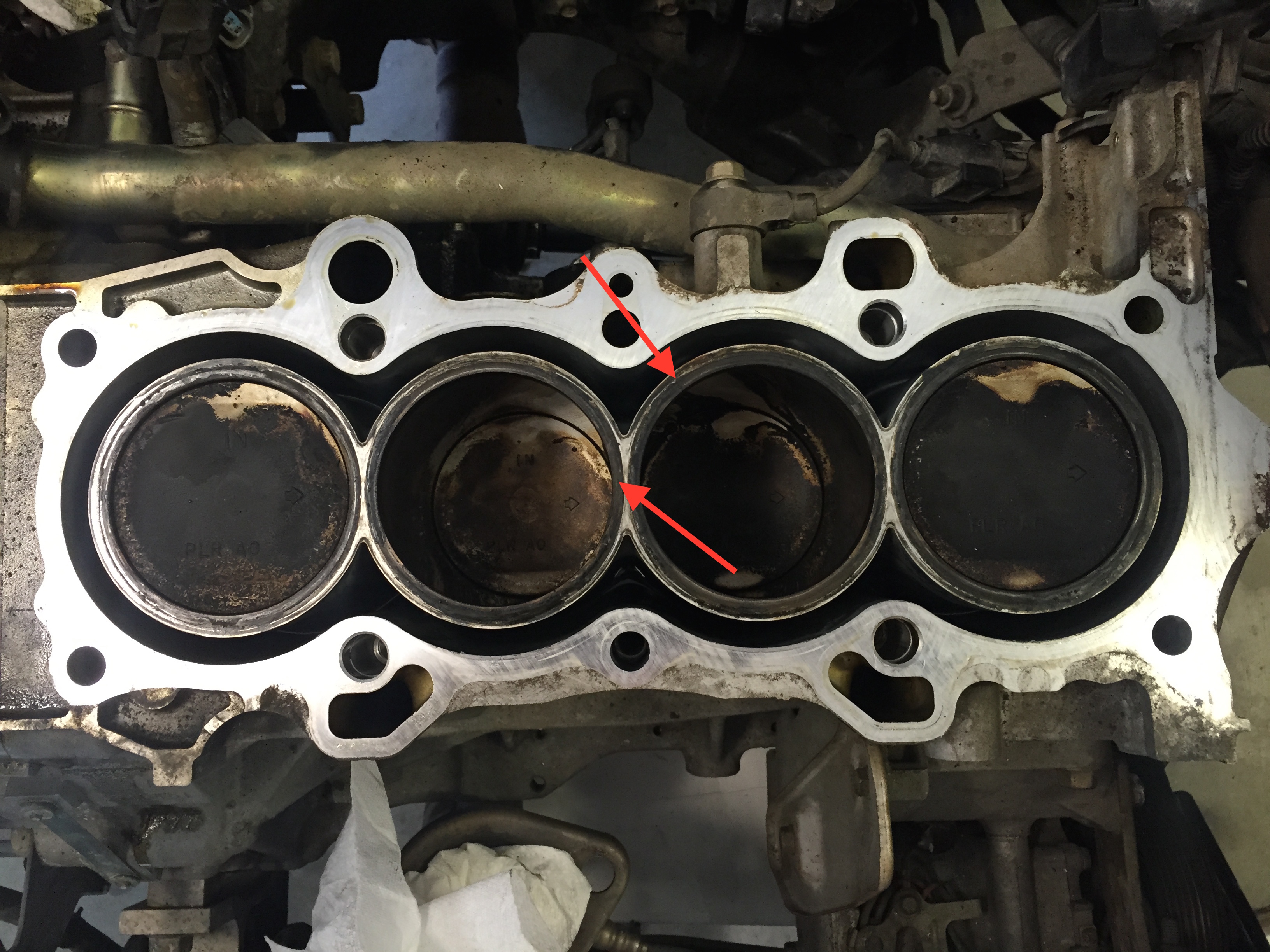

Was thinking about using scotchbrite discs like the one found in this forum:
http://www.bobistheoilguy.com/forums...Number=2740128
I attached a couple pictures of the discs I am considering using. I have read that these discs do not scratch or remove aluminum, but then I have also read the opposite.
I've also attached a picture of the area I am trying to clean

Single edge razor blades or a real sharp gasket scraper only. You might want to get a box of blades.
Crab spray if you want.
Minor scratches that are visual aren't significant, but if you can hang a fingernail in a scratch it may be.
On a 7th gen D17 head gasket all that's there is the black coating, just scrape it off. Around the cylinders there may be carbon buildup, just scrape it flat.
You don't need to get all the dark color out, just scrape it flat with a razor.
NO POWER TOOLS, NO SCOTCHBRITE, NO ERASER DISC, NO SANDPAPER!
Leftover grit can get in and ruin bearings. Seen it happen more than you want to know.
Power tools can and will damage the surface, and can remove steel and aluminum leaving the surfaces wavy and no longer flat ---and impossible to seal.

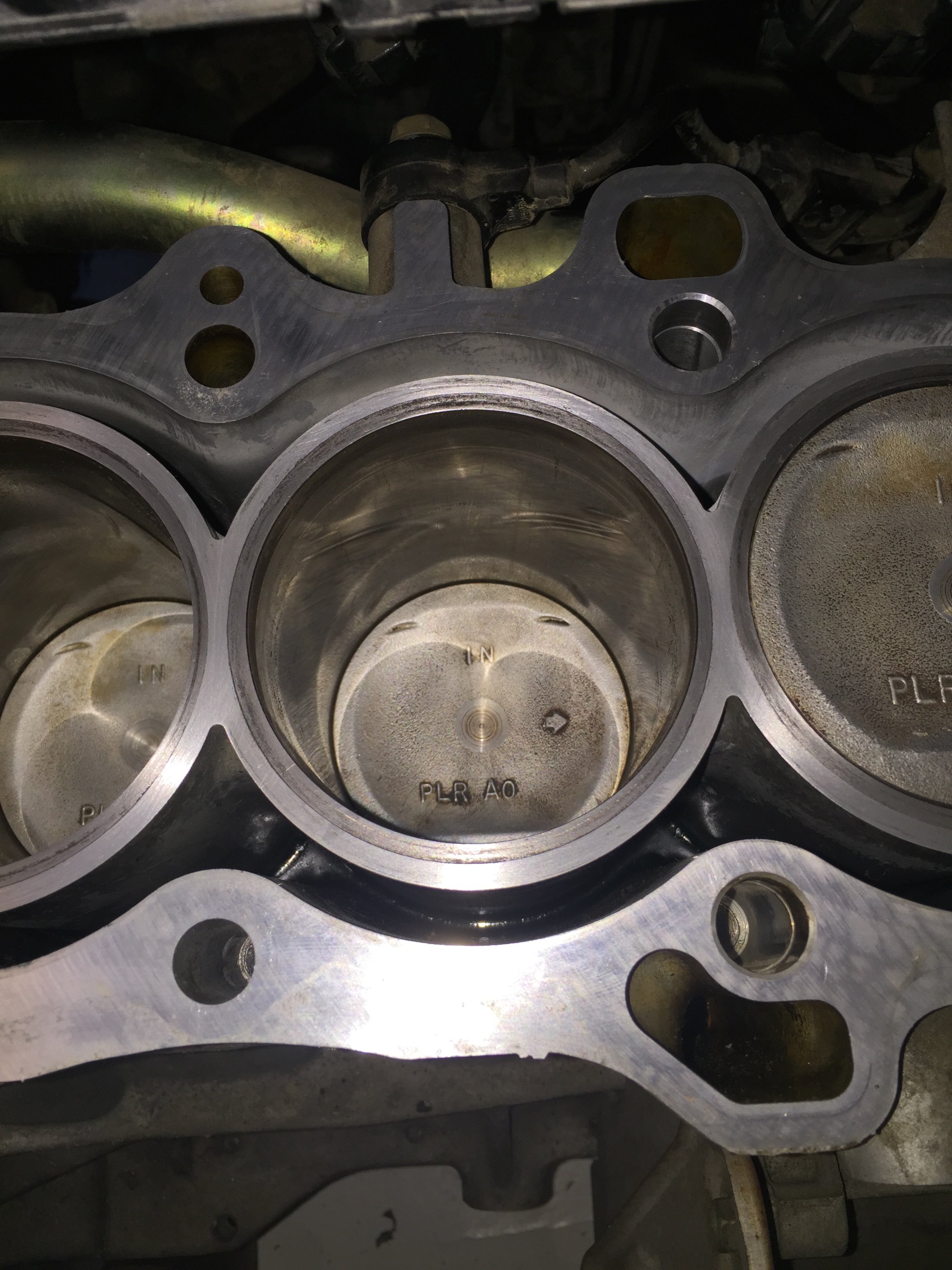

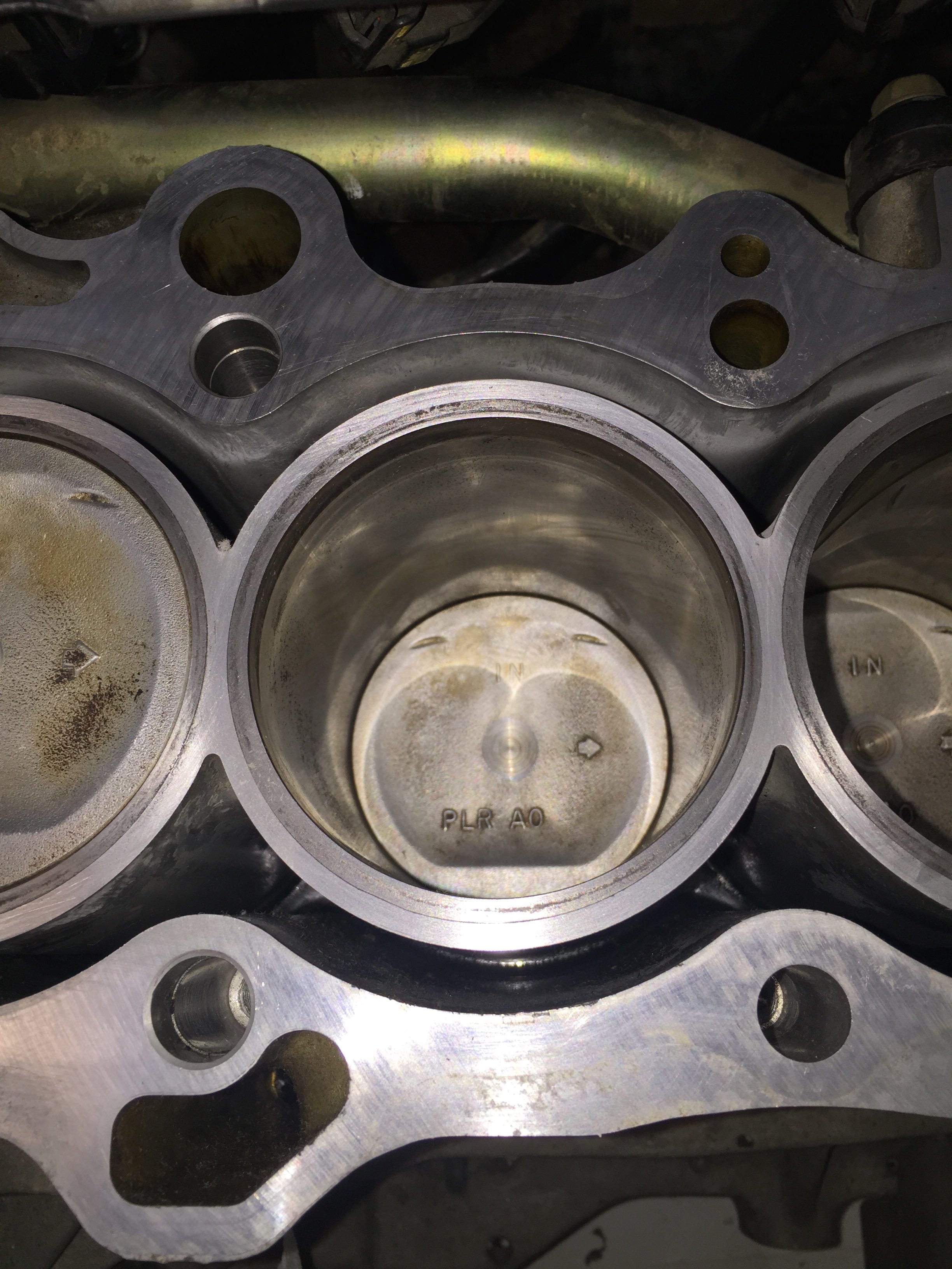

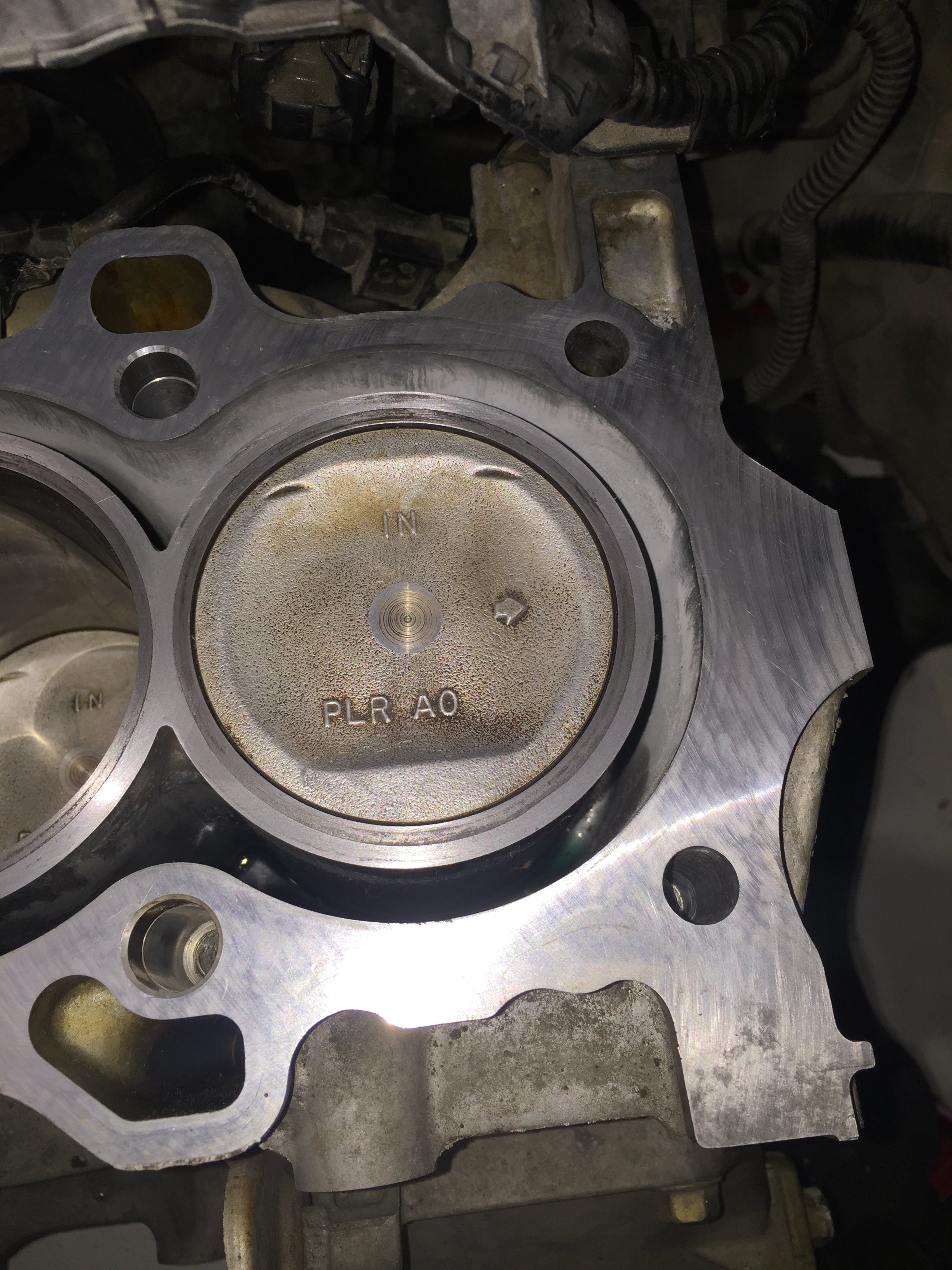

Did a little bit of work on my block with brakeclean, and a little wd40 on high grit sand paper and hand working the top of the cylinder walls. Didn't put much pressure, just enough to break into the gasket material.
Attached pics of how it ended up. Looks pretty decent to me. Thoughts?
Looks clean. Hope it's not TOO clean.
It always scares me seeing people do this. You almost have to remove some metal to get it that shiny, and it doesn't take much effort to remove enough metal to cause the new gasket to not seal correctly.
