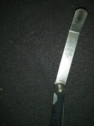

those are what call feeler gauge. Those are not the right measurement but thats tool you will need to do the work. Just ask Oreiley or the other parts store.
