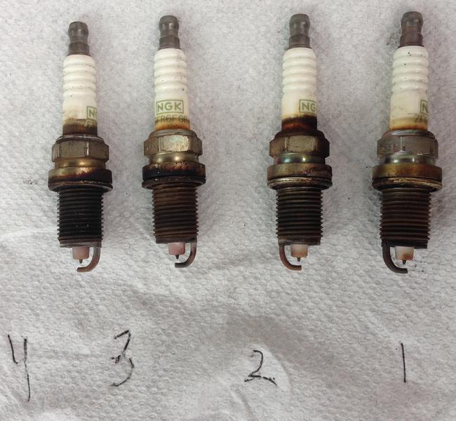

Since the weather is better is now, I was able to open the spark plugs and here is the photo. Back in start of march temperature was running in 10-25s F and I was getting above issues. Now temperature is in 35-60s. Relatively good news is that I have not got misfire triggered check Engine light since start of march. Its been almost 50 days. In between I have put 2500 miles on car. I changed valve cover gasket yesterday and that's when I took out spark plugs and took a photo.

Doesn't look like they were torqued again after installation, as per all spark plugs. Lot of carbon up those threads and past the sealing washer. Carbon up that high can arc under the right circumstances... plug swap ( I suggest the Denso OEM plugs, but buy from Amazon vs. your dealer -- they are eye-wateringly-pricey. 100K plugs though).
The OE Densos in my '04 EX were the showroom plugs -- and they also misfired esp cold, until I swapped them for new.
Compression-related misfire is indeed rare -- so rare, I've never heard of it, at least on an engine that actually ran after it happened (knock so bad it detonates the the ring land apart, sure that's a candidate ). Lots wrong with the piston/ring/cyl/valve seal for compression to be so low the TDC mixture's too lean to fire a correct injector pulse.

all those plugs look pretty normal to me

Re: Multiple cylinders misfire
I agree with both of these statements.
The burn looks normal on the electrodes BUT they have the appearance of being run loose enough to leak combustion past the threads.
