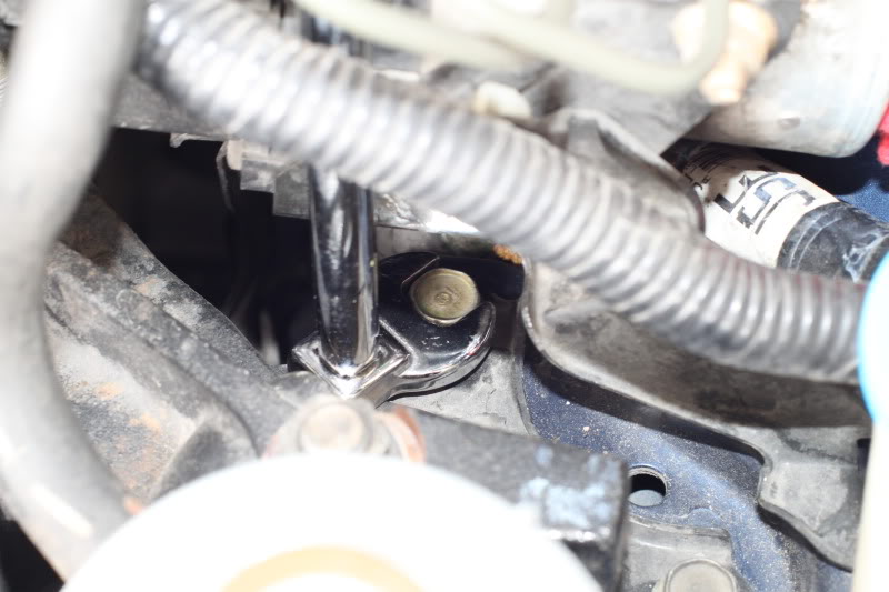

Hey thanks for the post, but I already tried with a long extension. I already got all the
other bolts out, ie. two on the mount bracket and two out on the engine mount itself,
except there is one hard to get to bolt on the engine mount, which is below the
ABS pump module. How can I remove that bolt??? please help someone. Thanks!!!!!
p.s. I read that the civic si and acura el have the same issue as this version of the 01' civic.

A long extension, a 14mm crows foot, and a bit of patience will do the trick

Thank you RICEBOY for that suggestion! I was about to give up and take it to the dealer, but I will give it another try tomorrow, it is a bit late to go to the store and buy that crow's foot today.
Thanks for the pictures as well, it gives me more confidence this could work, I will post tomorrow evening to let you guys know how it went, much appreciated!

No problem. I snapped these pictures for another thread (the headgasket/timing belt DIY) and saw you had the same exact predicament. You'll only be able to turn it a little at a time, but with enough patience, it'll come out. Getting the bolt to grab the threads once you're going to reinstall takes a little coaxing, though, just a forewarning.

Come on guys, I just used a ratcheting wrench with a pivoting head. You can turn it at least 1/4 turn at a time. It's way more expensive than a crows foot but, is way handier in the long run.
