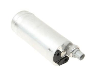

Originally Posted by crowfather
Hmm, then what component is that wiring running to? It looked like an evap canister, but I didn't look it up obviously.
It's close to the radiator? Picture? There is the A/C dryer mounted on the driver side. Two hard tubes running in the top, one sensor as well.
It is on the driver side, below the power steering pump. Near the bottom of the radiator.
I haven't had AC since I got the car. Hard lines over the top of the timing cover aren't connected to anything.

Look like this? Except mounted vertically. Should be two A/C lines on top but they could have been removed. One connector you can see as well.

Yup, thats the one.
