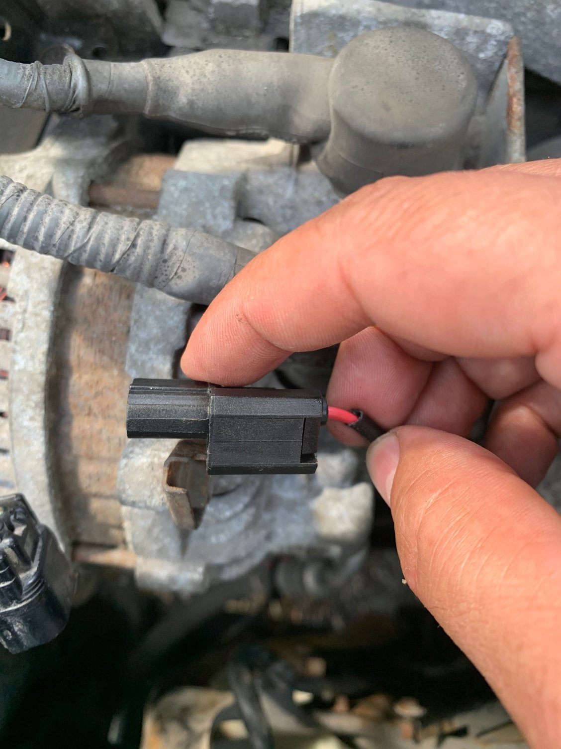

8 th civic ac 1 wiring compressor to 3 wiring chassi help

What color are the wires on the chassis/compressor sides?
You will take one from the chassis and connect it to the single wire going to the compressor. The other two on the chassis side will then be connected together. Need to know colors first though.

Re: ac wiring help
Colors really aren't matching up so I'm going to take a guess. Connect the blue/red wire to the single wire going to the compressor. Take the other two wires and connect them to each other.
If you still have the old compressor it would be easier to figure out. Just see what wires are running to the thermal protector and which runs to the clutch.
