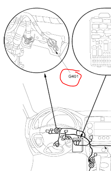

Re: Headlights - Both sides out. No Low, No High. Switch on steering wheel works
Where do your LEDs ground? With the info you've given it points to a missing ground. This ground goes through the headlight switch (high/low beam switch) and then to G401 (pic below). It could still be the headlight switch itself but maybe you messed with this ground when installing your LEDs.
