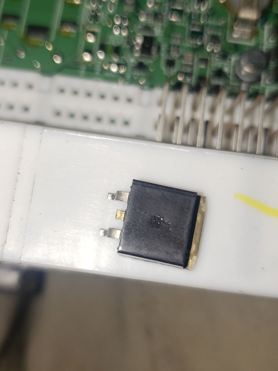

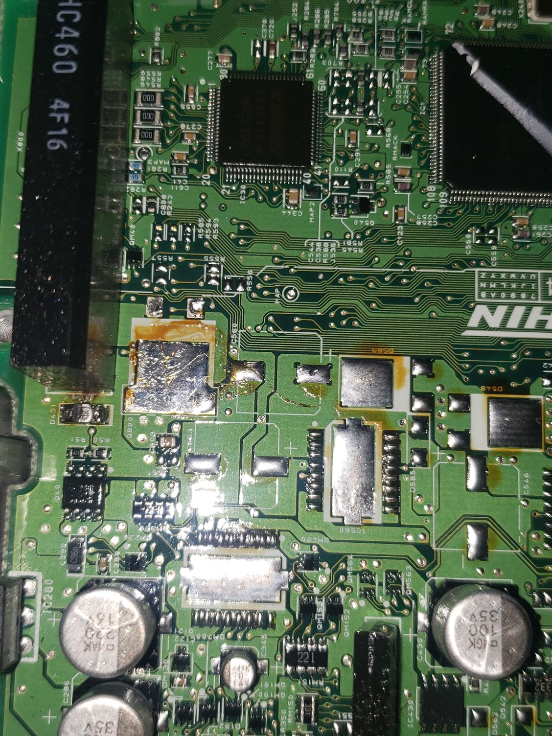

was in the process of removing my ECU when I heard a rattling noise coming from inside. I opened it up to find a chip loose. This bring me to my 3 questions. What exactly is this chip for? What can cause it to dislodge itself? Can it be resoldered?

That looks like a power transistor.
First thoughts would be it started to fail and overheated enough to self-desolder itself.
If you were able to get a new exact replacement part, it would be tricky to solder the underside correctly but doable if you pre heat the part up in a toaster oven before placing it on the board which you already had the solder tab turned into a pool.
