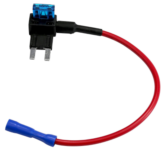

I was going to use one of these to add yellow/black to fuse 20 in the dash. I'm sure there's another fuse that has constant power under there as well for the white/red.

Just wanted to say I installed the keyless entry module over the weekend. Using the "Add-a-fuse" things I connected yellow/black to fuse #20, white/red I connected to fuse #16. The fuse panel said #16 was for heated seats even though it does not have them. Keyless entry is working without any issues now.
