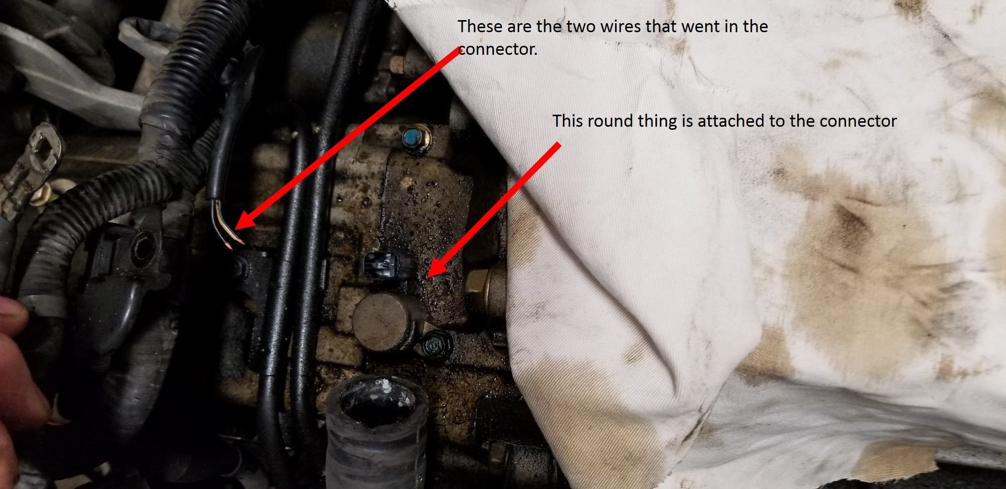

This is under the coolant ports when assembled. I didn't see it and yanked it off while dissasembling.
Hey, I accidentally broke a connector on my 2005 Civic, 1.7 Vtec. and I have no idea what sensor or other device this is. Can anyone tell me what this plug goes to so I can order a replacment?

can you take a picture with out blocking the sensor?
is that on the water housing?
auto or manual?

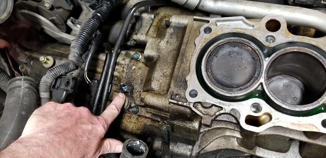

Ya know, I thought I could but I didn't even realize my stupid finger was on it. It is not on the water housing, at least I don't think it is. The coolant ports go above this when the head is on. It appears to be mounted to the block, very near the automatic transmission. I found another pic w/o my finger
. Thanks.

Probably the TCC solenoid?
That would be my guess as well, and ezone is much more knowledgeable than me

Yep, looked it up, it looks the same. Thanks Buddy.
