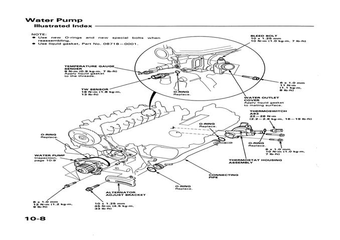

Not sure if I have the right sensor ID'd
Lazlong,
I'm not sure that I have the right sensor ID'd. I found a copy of the service manual & I think the sensor I need to change out is the TW sensor. From the diagram it looks like that sensor is not sticking out of the thermostat housing. Am I right or nuts?

Re: Need Help - Replace 1993 Civic DX ECT Sensor
It's where one of those hoses meets the engine. It should have a red/white and a green/white wire.
