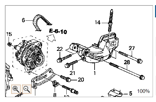

Is it really just 4 bolts? In the diagram in my repair manual and on diagrams I find online, it looks as if other parts are on top of it. Looking at the image I attached, now I can see there are 4 bolts (#s 21, 22 and 2x #27) but isn't #14 part of the engine mount?
Is nothing else sitting on the bracket, maybe the valve cover, or anything else?
edit: btw you can see a zoomable version of the image (and engine) on this site: http://parts.sonshonda.com/showAssem...roduct=1511848

5 bolts hold the alt bracket to the block. 3 from the front, 2 thru the timing belt side. You will already have the motor mount bracket off of it.
I take off the motor mount bracket and jack up the engine as far as it will go to get the long bolt out of the alternator.
The engine can't fall out the bottom when you take the mount bracket off, it will sit on the subframe at the lowest.
IDK if I would do a time-sert for a customer or recommend replacing the bracket.
The bracket has to fit correctly into the timing covers, so those need to come off to do it right IMO.
#14 is a stud where the motor mount bracket attaches. If you are going to replace the entire alt. mount bracket, make sure that stud can be extracted from the bracket first. If not then you would need to order that too.

Hmm. maybe a longer bolt with a locking nut would be preferable then. Is there a certain spot that I can put my floor jack to hold up the engine?
Re: 02 Civic EX alternator pivot bolt questions
Better make sure you can reach the nut to get it tight.....and maybe put a note there so the next guy doesn't cuss you so much. I know I sure wouldn't expect a nut there if I take it apart.
Under the oil pan is about the only choice.
Never jack directly on the oil pan. Use a large block of wood to spread the weight out across the entire pan area so you don't bend or break the oil pan.
