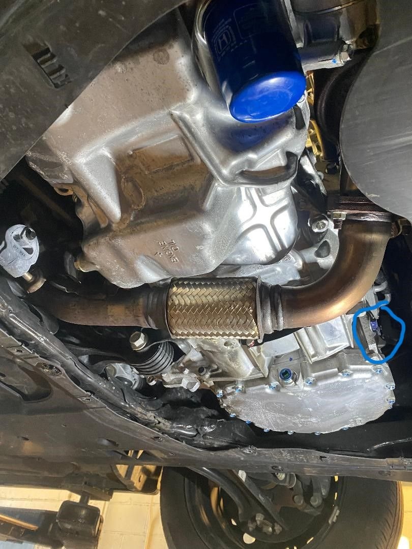

i own a 2020 civic lx 2l with a cvt. is the bolt i have circled used for a drip test during refill?

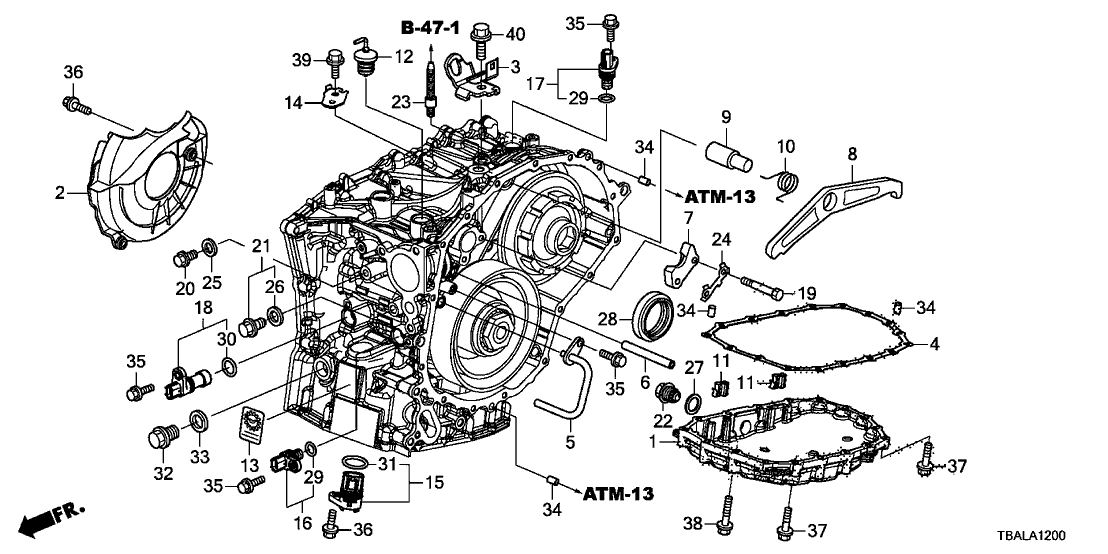

Found this. Hard to tell if that's the same bolt from the angle your picture is taken.
that should be the answer. the parts explosion calls #32 a drain plug. The sticker on the case describes what fluid type to use. Thank

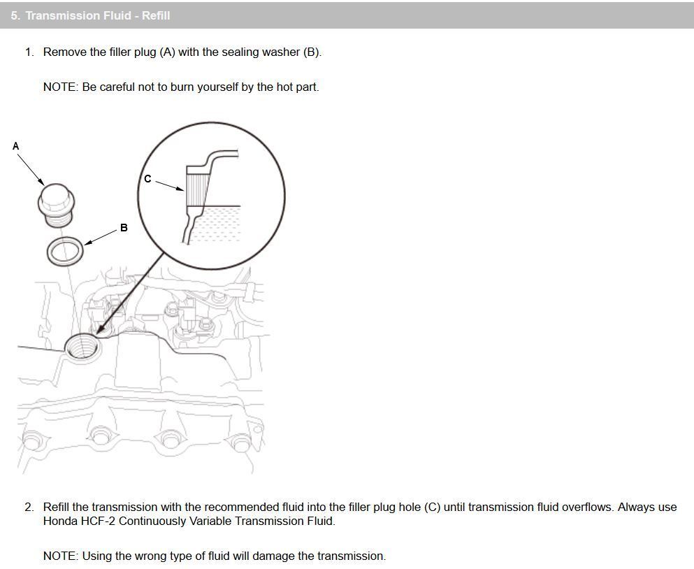

Parts diagrams don't shown one, I must be misremembering. I'm too young to be this forgetful!
hey bro- i just got my answer from honda. the bolt is used for the fill drip test as i thought. thank you for the diagram and your input
