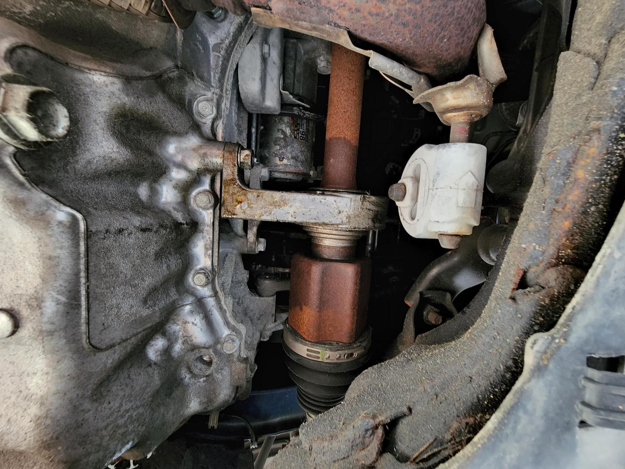

Hey BrotatoChip, how's it going? I was changing my oil today and saw the exact same thing. Actually I saw it last oil change but I thought it was engine oil cause I had minor valve cover gasket leaking (fixed). Now it's dirty again so I know for sure it's not engine again, plus engine oil would be much darker by now.
Just wondering how's the bearing 2 years later? Have you replaced it? If so how did you do it? Seems like steering rack would have to come out, definitely not something I'd be comfortable with.
Attached pic for my leaky bearing. Mine's so leaky it covered almost the engine pan and oil filter with oil.

I continued to ignore it until I sold the car this January with ~75k miles. It never made any noise or caused any vibrations.
