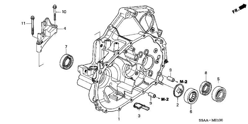

Which part is the input shaft bearing? This is for a 2003 Civic. The part descriptions don't help.

Input shaft = mainshaft
Shaft has a bearing on each end.
#5 in your pic is one of the input shaft bearings. (#6 would be a countershaft bearing.)
#15 in this pic should be the other bearing.
HTH
